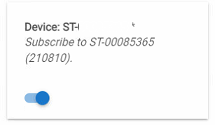

Also make sure you toggle the switch next to your device you want to subscribe to. Scratched my head a few mins when I first installed the driver.
Got it. I searched the web page until I finally found it. Then I toggled the subscribe button and the status showed up. I was entering the Weather Unit number, not the hub number.
Thanks for all your help.
It is definitely well hidden. Glad you got it sorted out!
