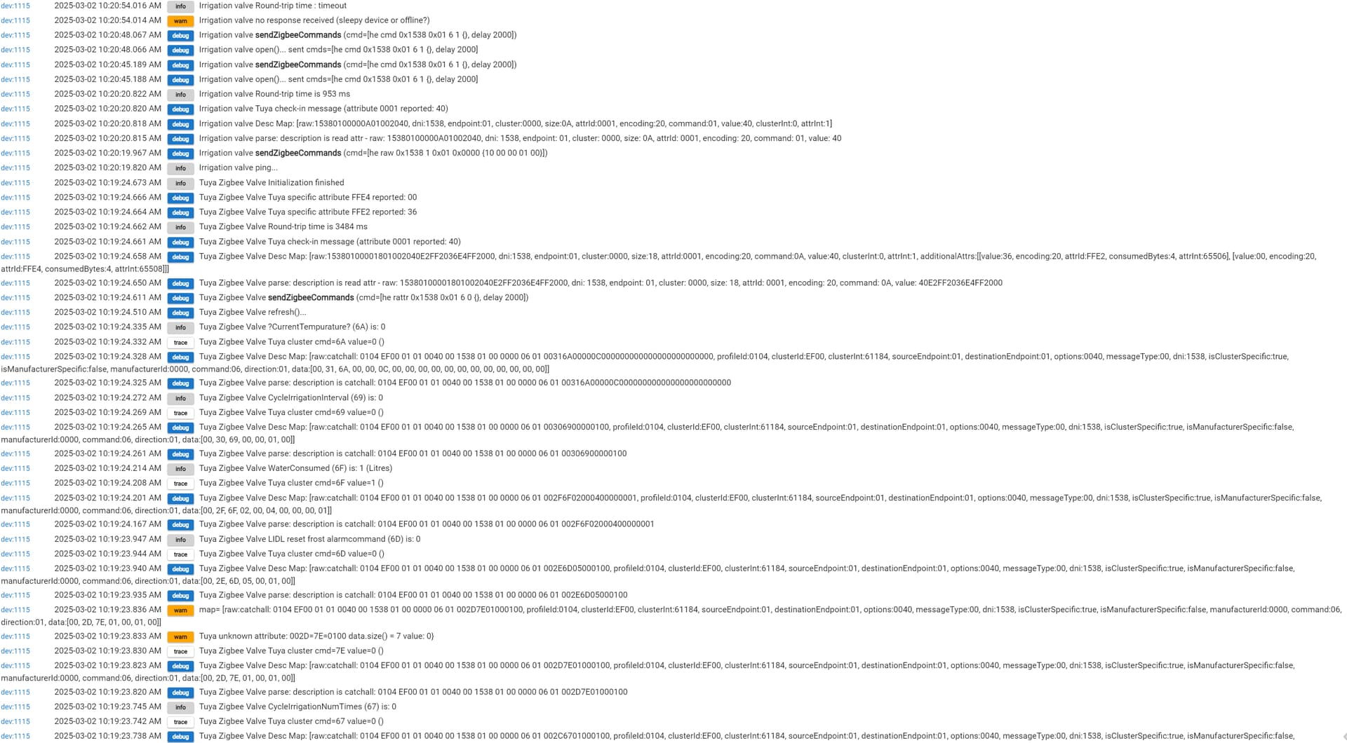

Delete the device from your C-8 hub (use the red REMOVE device button), then pair it again as a new device, using this pairing method. Make sure you follow all the steps.
Then, please post a screenshot of the logs that were recorded during the pairing process.
Also a screenshot of the State variables for this device.
As soon as the device pairs, go to the valve web page in HE and click on the Ping() button. Will the device respond?
If yes - will the device respond to Ping commands again after one or two minutes?
This test will show whether the device looses the connection shortly after joining the Zigbee network.

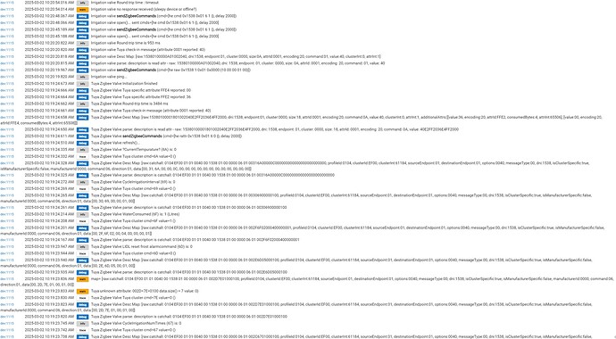

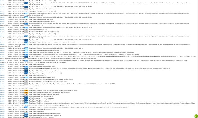

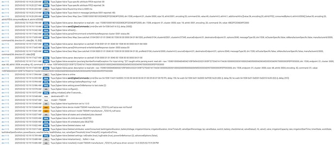

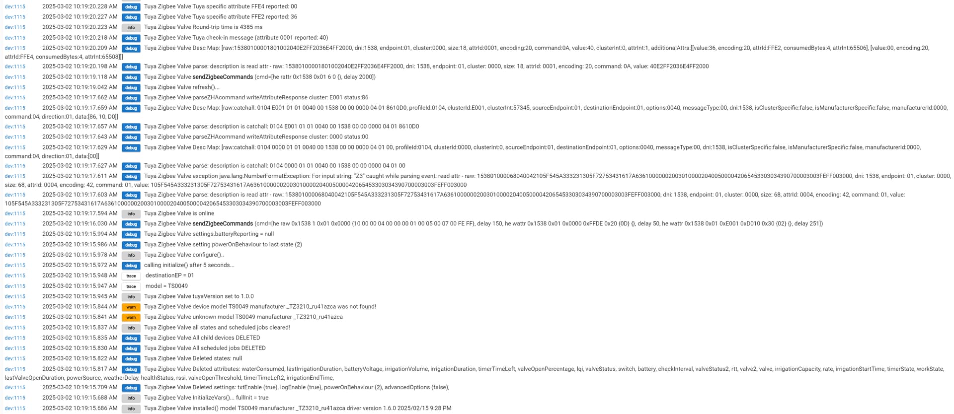

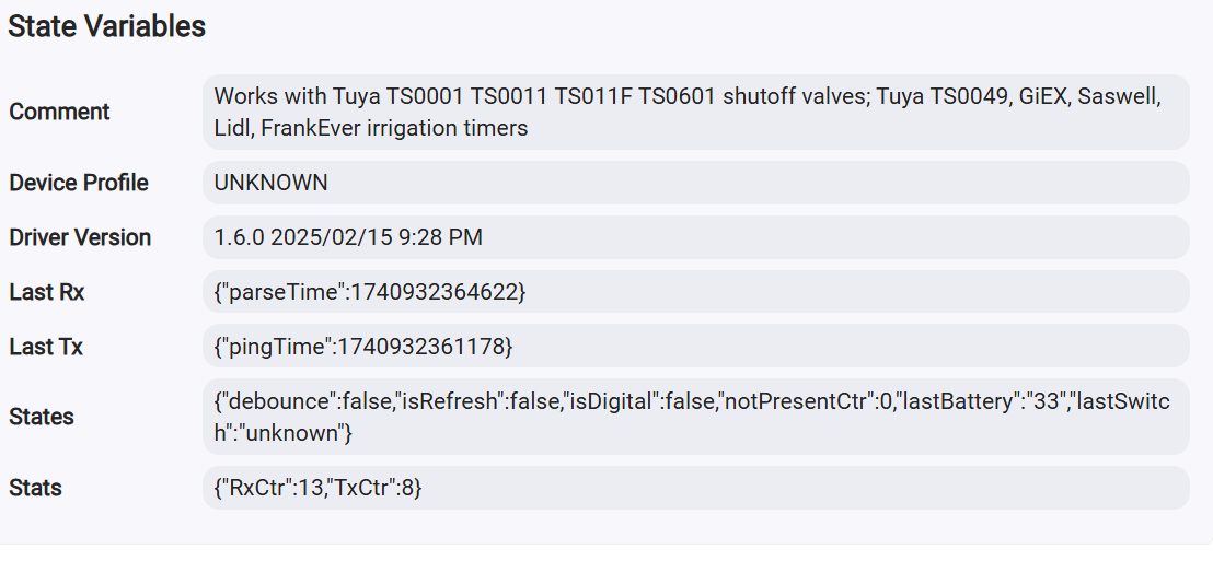

I followed the instructions and have attached the screenshots. I tried a couple of commands after taking the screenshots and they didn't work as before.
After taking the screenshot of the state variables, I noticed the device profile was again UNKNOWN, so I manually changed it as you suggested before, Now the device seems to be working. Open, close seem to work. Ping returns a round trip of 351 ms.
Not sure I know what changed as I tried removing and pairing several times before, but I won't argue with success. Thank you for your help.

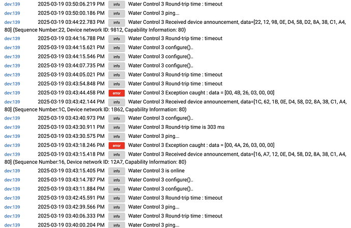

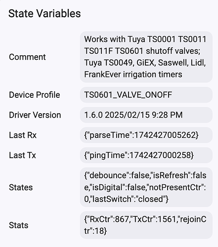

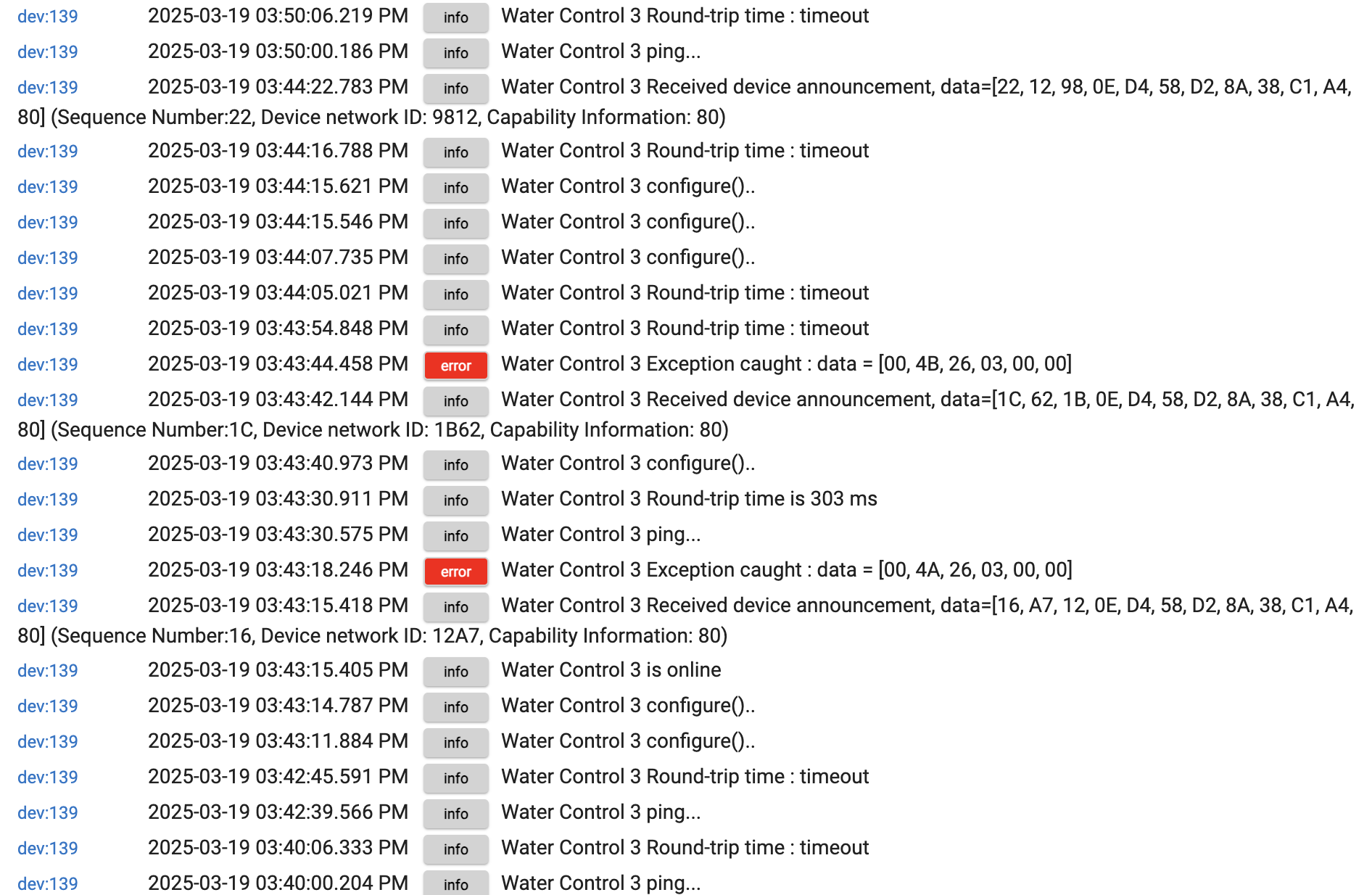

Similar to @Arktronic, I have 3 of the NEO Zigbee Sprinkler Timer (Amazon.com) and found that they seem to mostly work for On/Off if I manually apply the TS0601_VALVE_ONOFF device profile. They work fairly reliably right after I pair or repair them, but after some random amount of time, they lose contact with my C-7 hub.
I tried adding a Ping on a periodic timer(10 minutes) and this seems to keep the devices online longer, but I can't validate for sure since the time until they drop seems very random.
It seems that the drop is often associated with an error like at dev:1392025-03-19 03:43:18.246 here:
Device Info reports as:
Application 4A
Manufacturer _TZE204_rzrrjkz2
Model TS0601
Tuya Version. 1.0.10

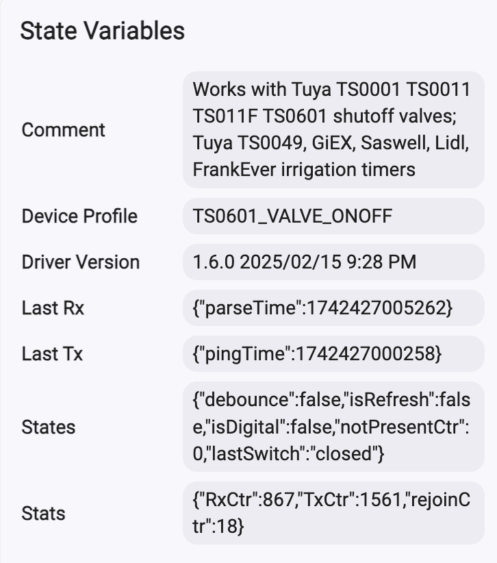

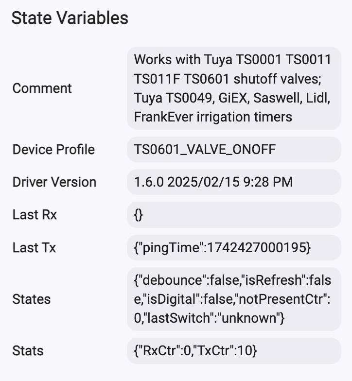

State Variables for this device that is currently offline are:
This device was offline earlier today, I re-paired it. My C-7 said that it had found a previously paired device, and then almost immediately it went back offline
State Variables for another device that seems to be staying online a bit better are:
I've been admittedly a bit haphazard in my troubleshooting so far. I'm happy to run through a prescribed sequence if it will help figure out how to keep these devices connected and functional.

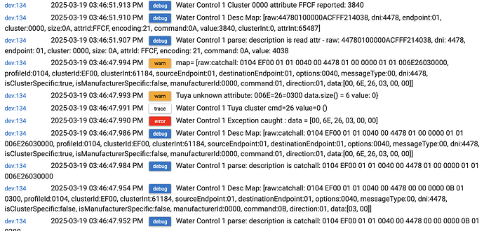

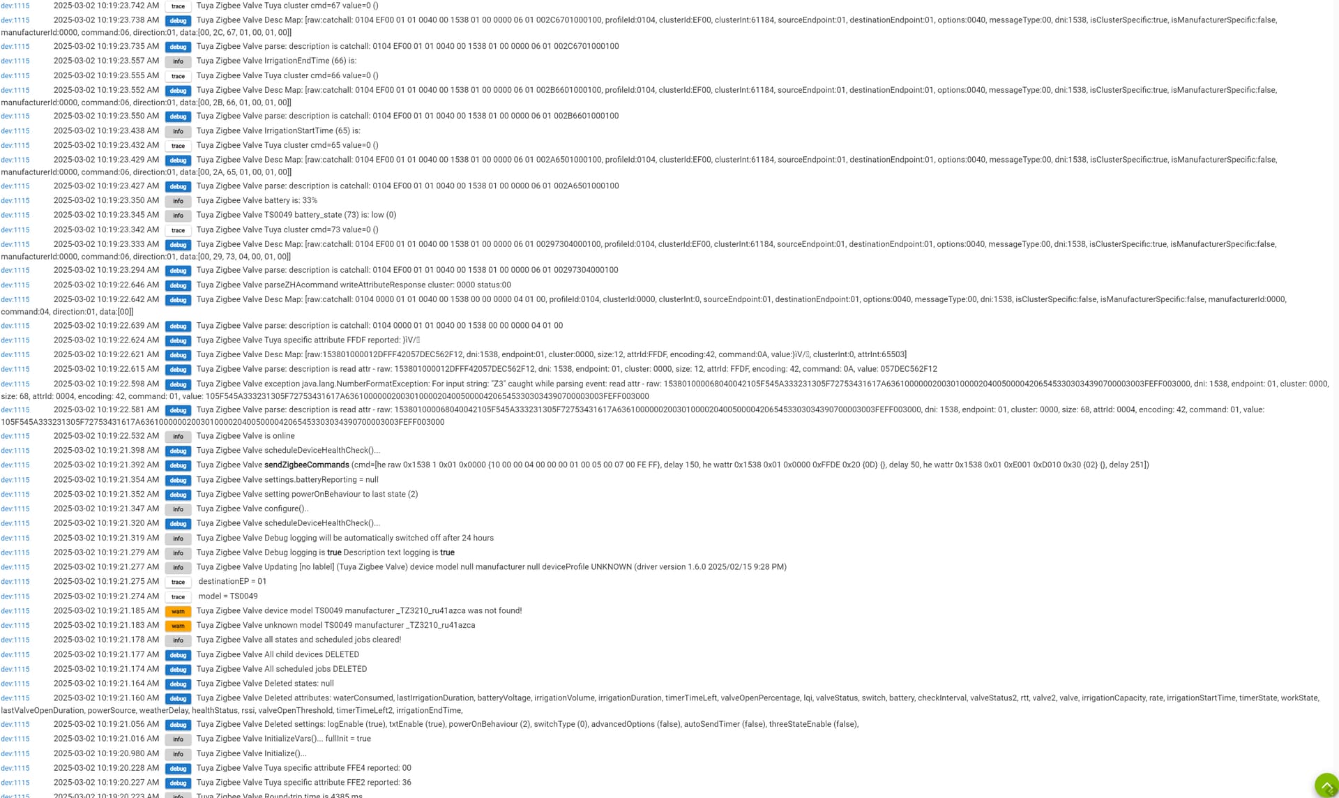

A few extra data points in case they make more sense to you, some errors from a device that I had to repair earlier today:
