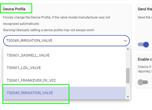

I purchased a Rain Seer valve and paired it successfully but it doesn't respond to commands. In the device info tab it shows the model as TS0049 and the manufacturer as _TZ3210_ru41azca. Not sure how to proceed, any help would be appreciated.
I can't find information on TS0049 _TZ3210_ru41azca - hopefully, this is a new manufacturer of the same Rain Seer valve that is already supported in this driver,
Change the 'Device Profile' manually on the Preferences tab to TS0049_IRRIGATION_VALVE and then click Save :
When you manually switch the valve on/off, do you see anything in the live logs?
Changed the profile as suggested - no difference. Every command I send shows no response / timeout in the logs. Manually switching the valve does not show up in the logs. I've tried repairing the device but no luck.
