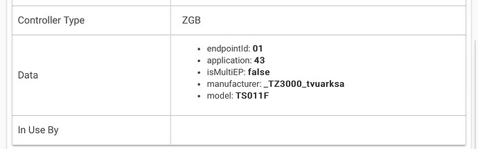

Hi,
Is this water valve supposed to be supported ? I tried many drivers, including yours, to no avail…
_Tz3000_tvuarksa
Model TS011F
But on the box, and sticker, it says model is SM-AZ713
Hi,
_Tz3000_tvuarksa
Model TS011F
Oh… selecting the model manually and pairing a second time seems to have worked.
