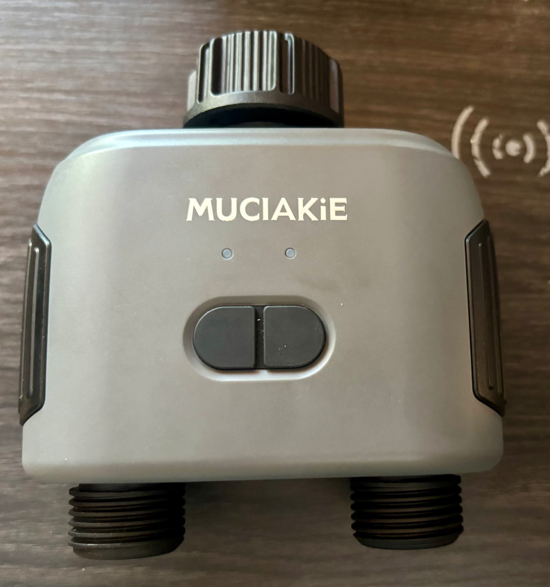

Just wanted to jump in and thank you. I recently acquired one of these dual valves, which identifies as:
Manufacturer. _TZE284_fhvpaltk
Model. TS0601
No luck with the Sinope driver and initially couldn't get it to respond to your driver either. Eventually I turned on "Advanced Options" and by trial and error ended up choosing "TS0601_TZE284_VALVE"
Working like a charm now!
I created two virtual switches and some RM stuff to turn each valve on/off (I only needed basic functionality).
So thanks again for your work.

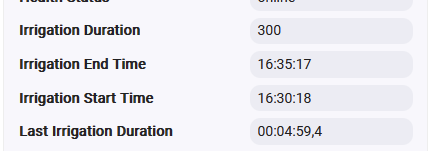

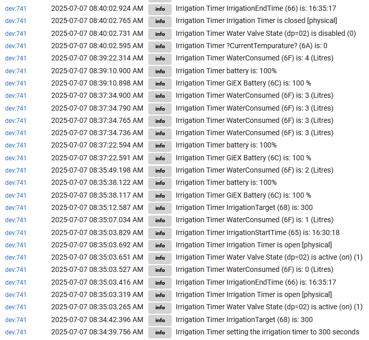

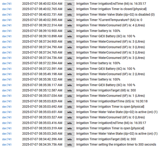

I purchased and added to hub almost a year ago, but finally got around to installing my drip irrigation system and getting set up and testing. I noticed there's some major discrepancies with the times displayed:
At 08:35am local time I started a 300 second (5 minute) run.
The driver is stating irrigationEndTime of 16:35 (+8 hours)
At 08:40am local time it stopped the 5 minute run.
In the current states:
Ignoring the timezone differences, it's reporting __:30 as start and __:35 as the end when in reality it was __:35 as start and __:40 as end.
I'm not going to lose sleep over this because setting the number of seconds and turning it on appears to work properly (it turns itself off after the appropriate time elapsed) but just pointing this out because it's confusing when troubleshooting/checking.
Is the timer turning itself off after the configured time or is the hub sending the off/close signal? (I think/hope it's the former.)

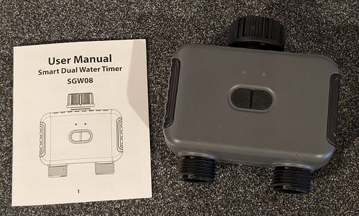

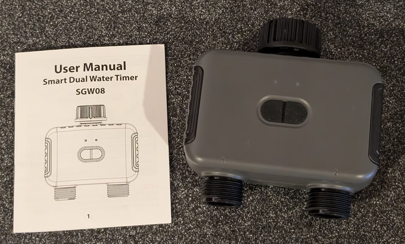

I just acquired one of these (very similar) dual Zigbee valves: Amazon.com: Haozee Zigbee Sprinkler Timer 2 Zone,Smart Water Timer for Garden Hose, Requires Zigbee 3.0 Hub,Support Home Assistant Zigbee2mqtt, Rain Delay and Manual Watering, Leakproof for Yard Lawn Watering : Patio, Lawn & Garden
It's fingerprint selected this driver (I already had it installed), but I needed to manually set the device profile to TS0601_TZE284_VALVE (via the Advanced Options) to get the "Set Valve2" to operate. Thanks for your note!
fingerprint profileId:"0104", endpointId:"01", inClusters:"0000,0004,0005,EF00,0000,ED00", outClusters:"0019,000A", model:"TS0601", manufacturer:"_TZE284_fhvpaltk", controllerType: "ZGB"

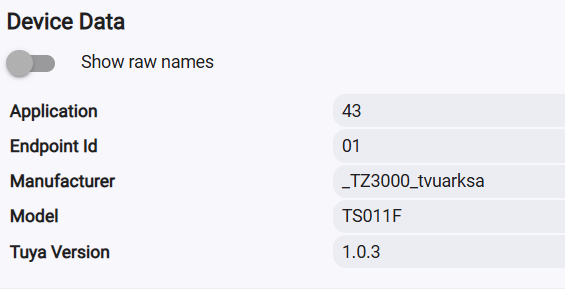

Hi @kkossev
I had to do some work in my utility room today that is fitted a Tuya TS011F VALVE.
I manually closed the valve. When I looked at the valve on my dashboard I saw that it still showed as being open. Looking at the device page in HE it also showed as open.
It appears that manually/physically opening/closing the valve using the button on the body of the valve does not update the state of the device.
I've tried a re-pair of the device followed by a configure/refresh etc. and it still doesn't update it's status if manually changed.
I have 2 of these and both do the same.
I'm not sure if I've missed something but do you know if this is the problem with these devices or maybe I need to configure something.

Hi @kkossev
Just bumping my post above in case you missed it.
Any thoughts if this is just how it is or is something going wrong.
I'm wondering if this is anything to do with it.
Hi Bob,
I am way from home now and when back I must finish first the Tuya mmWave driver refactoring, then I will have the chance to look at the other items in the backlog .
Two things that I need to know - the Zigbee model/manufacturer data for your device (TS011F is just a generic Tuya modlel). Also, with debug logging enabled - do you see anything in the live logs when you operate the valve manually?
Nothing in the logs when the valve is manually opened/closed by pushing the button on the device.
I changed the driver to device and cleared all the states etc.
On re-pair the device shows this.
