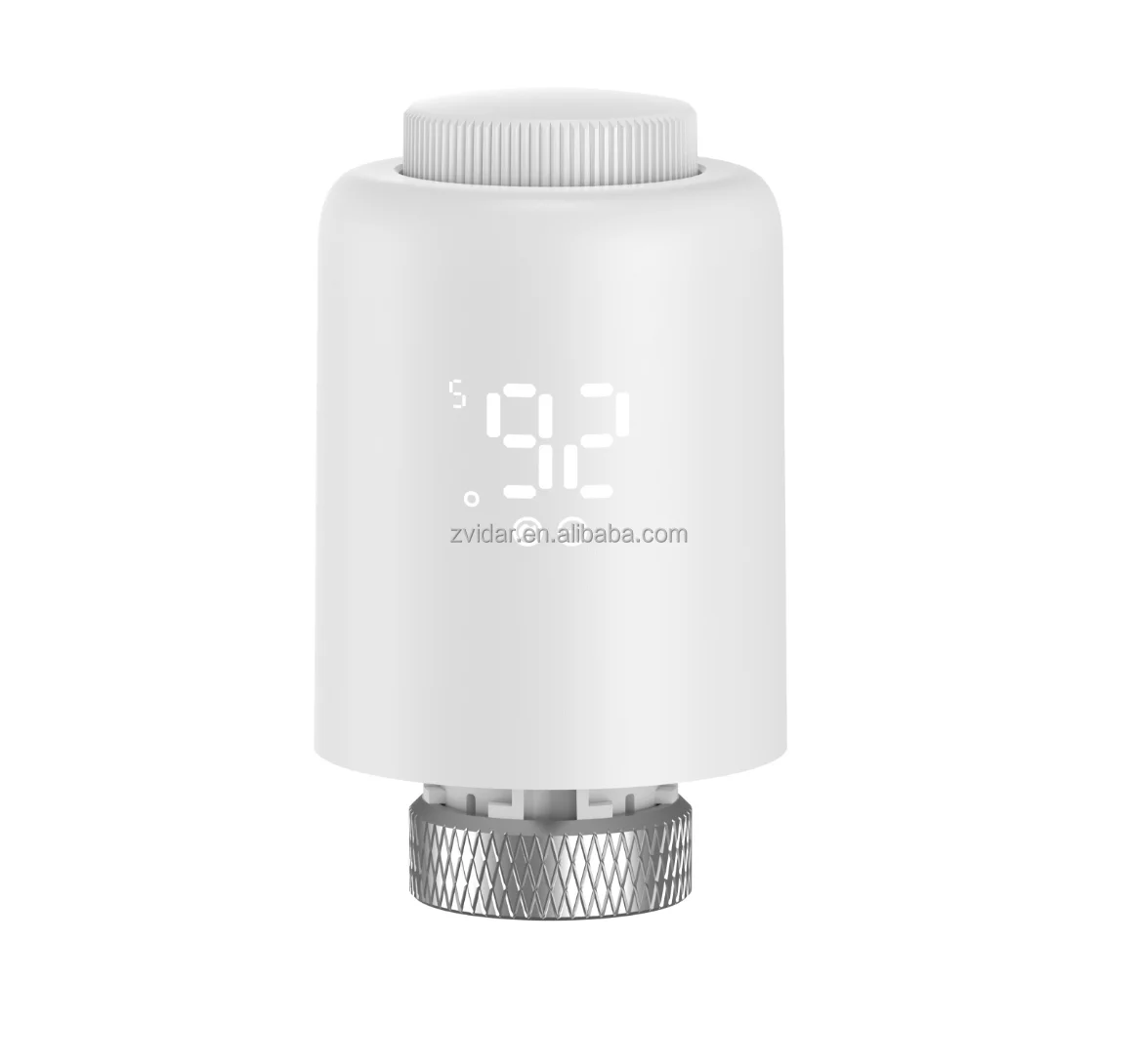

The screen rotation and display brightness functions work with the Tuya_TRV602 profile
I've found the info I was looking for this this new device - we are only 3 days behind the Z2M folks! :wink:
Excellent, you are the best!
Please test the new update - dev. branch version 3.4.1 '2024/10/26 10:45 AM' .
"LOAD ALL DEFAULTS" should select the new device profile Tuya_TRV602Z.
I was not quite sure how to match this TRV different operational modes to the standard HE thermostatModes... lets see what is the result for the moment.
Please test also again the Refresh() command - will all the parameters be reported back, or not?
You can also try your TRV with this driver. The device profile group should be 'TUYA_HY367_HY368_HY369_TRV'
Excellent work, everything seems to be working fine :grinning:
Child lock, screen orientation, display brightness working.

I'm new to Hubitat and I purchased it specifically to get TRVs working in my (American) home. To test this I bought extrememly generic Tuya valves that I can't even find the brand on:
My problem though is super basic, and this may be the wrong thread for it - but when I put it in pairing mode and turn my Hubitat to manually add a Zigbee device, it doesn't show it up.
Some beginnner's help would be appreciated, thanks in advance.
Can you post a link to the site where this device was purchased? Google Search referes to eBay, but no particular listing.
... I have not seen any Chinese manufacturers offering Matter or Z-wave TRVs ... And the WiFi option is not shown on the box, which is also unusual.
I’d have to do more digging as it was purchased on my wife’s device, but the Alibaba link is my device. It does appear to be a standard Tuya valve.
I got them cheap specifically as an experiment, so it’s not the end of the world, especially now that Tado offers a matter compatible valve.
The company behind these TRVs is relatively new, with just one year of presence on Alibaba. However, their company profile is quite intriguing. The mention of "Z-Wave" and "Matter" caught my attention—I’ll be looking into this further.
