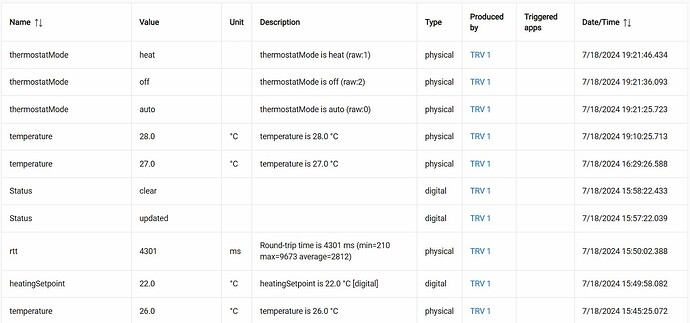

Hi Krassimir,
  1. when changing manually temp on TRV ... the set temp gets updated simultaneously in HE. This has been always working well.
  2. yes, I can change TRV mode and it gets also updated in HE within second.
  3. I disabled the polling interval around the noon time ...
and now the suprise... I see the current temp is the same in HE and on TRV. It has changed few times during the afternoon. I asked my son to check it during the afternoon since he was at home. I could see the temp remotely on the HE and he provided me with the real temp from the TRV.
I have no explanation what happened - but it works well now. Was it because of the polling function? was it because of difference in rounding the temp numbers (like TRV was showing already 24, but HE due to different info in decimals still 25?). Something different?
Well, it doesn't matter since it works. THANK YOU AGAIN for such a great support. I think the real test will come in the fall/winter ... otherwise I would be in trouble if wife and kids stay in cold :slight_smile: .

Please, post the device data details as text.
Is it this one?
Yes, it's that one (I think on Aliexpress the seller wrote the model number incorrectly!)
EDIT: device details updated!
Try the 'AVATTO-TRV07' device profile - it seems to be a better match?

Obviously, this device is very different from the 'TS0602' model....
I will create a new device profile, based on the AVATTO_TRV06_TRV16_ME167_ME168_TRV. Initially, the only difference will be to invert the thermostat Operating State.

See below.
Battery compartment very easy to open and batteries are easy to insert/remove.
Not a lot of debug logs when turning the knob (hope I did this correctly?)...
Logs
