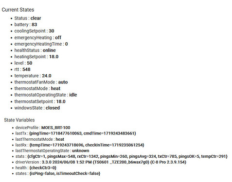

Can you post a screenshot of the Current States?
Yep, the supported thermostat and fan modes attributes are missing… :thinking:
Can you select ‘ LOAD ALL DEFAULTS’ and click on the Configure button?
Then press F5 to refresh the browser page.
Good news, loading defaults seems to have fixed the issue!
