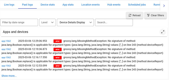

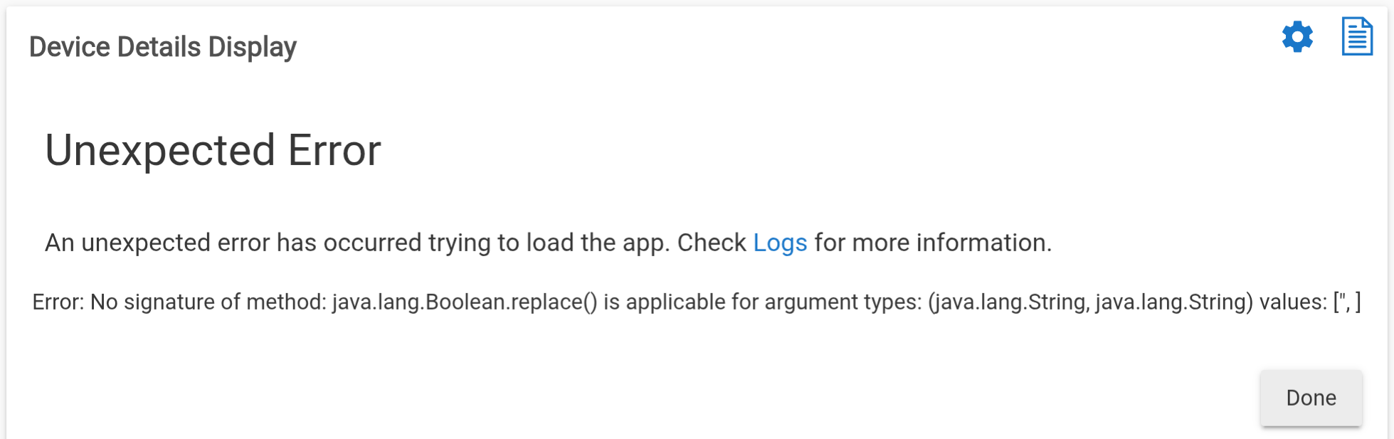

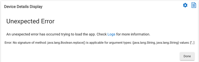

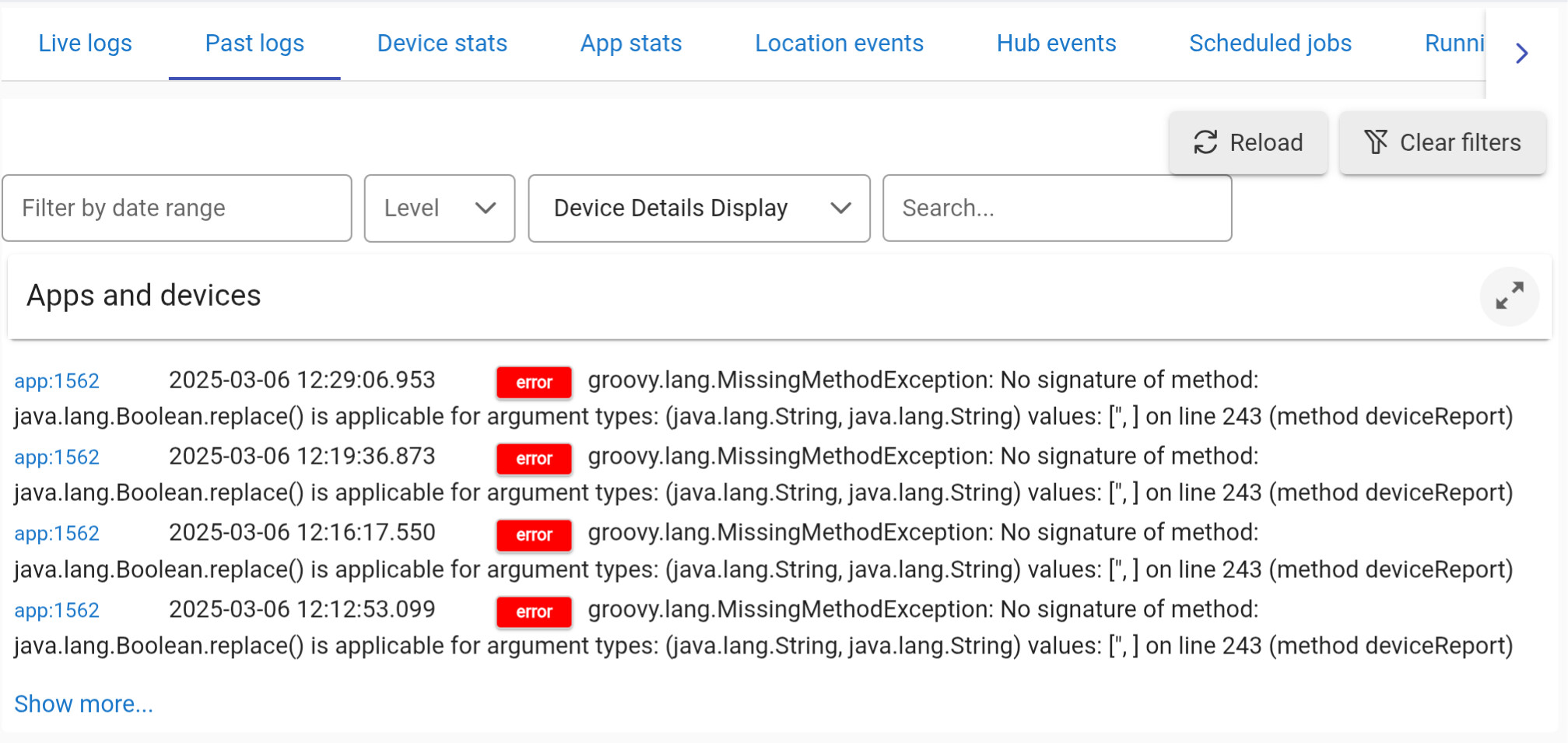

Trying to list all physical devices (75+) for my records. Works fine for the display, but fails for the report. Error messae and log file:
What hub platform version are you on? It is trying to run a replace on a Boolean data type, which is odd. I wonder if something changed on a recent platform that broke it.

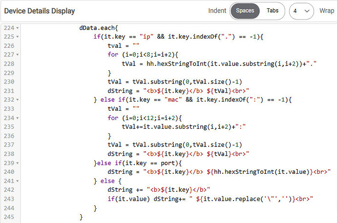

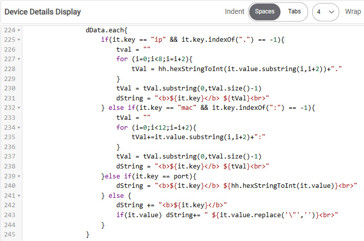

I'm on 2.4.0.151. It is a list of device information from the details page. Line 243 is trying to replace a \ character.
The problem is that is trying to run replace on a Boolean (true/false) which obviously you cannot replace characters on a Boolean value. There would need to be more logging to determine what is happening exactly.
Oh I think I see.... its going through the device data, and assuming they are all strings. May need to add a check in there to verify the data type before attempting the replace. You must have some devices with true/false values in the device data, which is odd I have never seen anyone do that before.
App is overdue for a rewrite, but I'll take a look and see if I can do a quick patch to correct this issue.

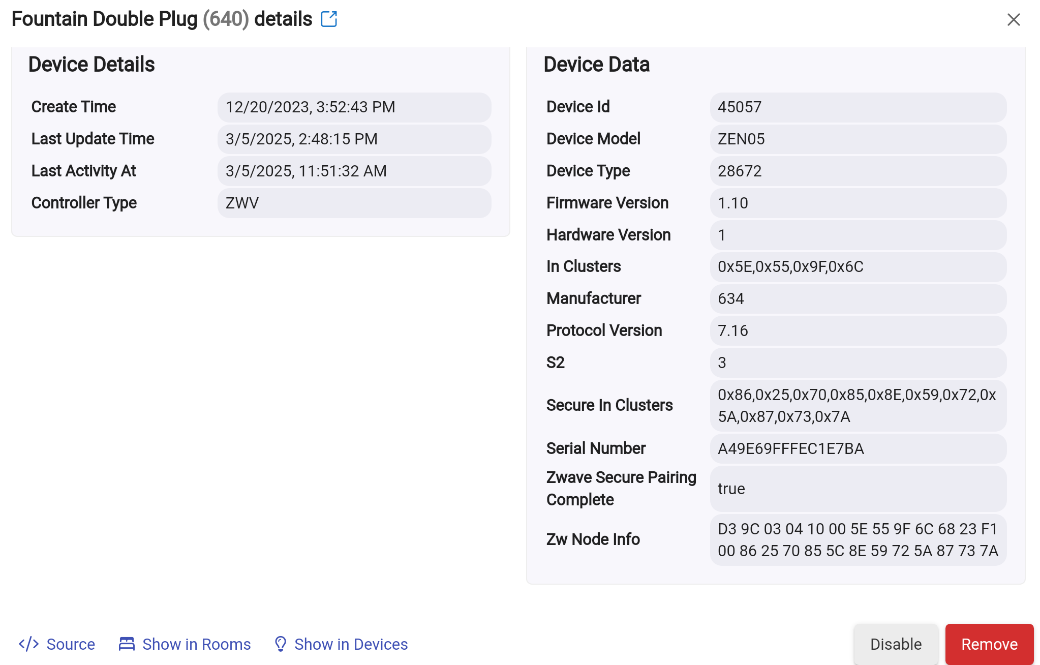

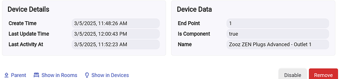

Found the 4 devices that caused the error. Adding any one of them causes the error.
Zooz ZEN05 LR, Zooz ZEN05, an old Zooz double plug and a HomeSeer Floodlight Sensor.
Can paste the details if that would help.

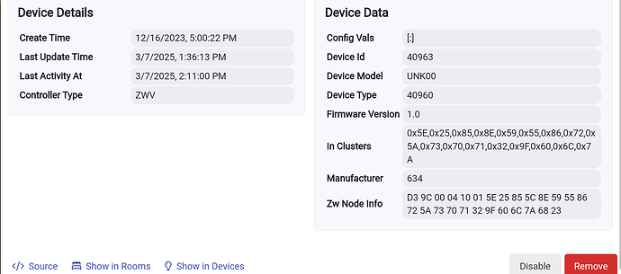

A snapshot of details area of one would help make sure I'm testing appropriately. Thanks.

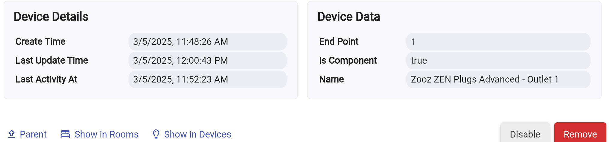

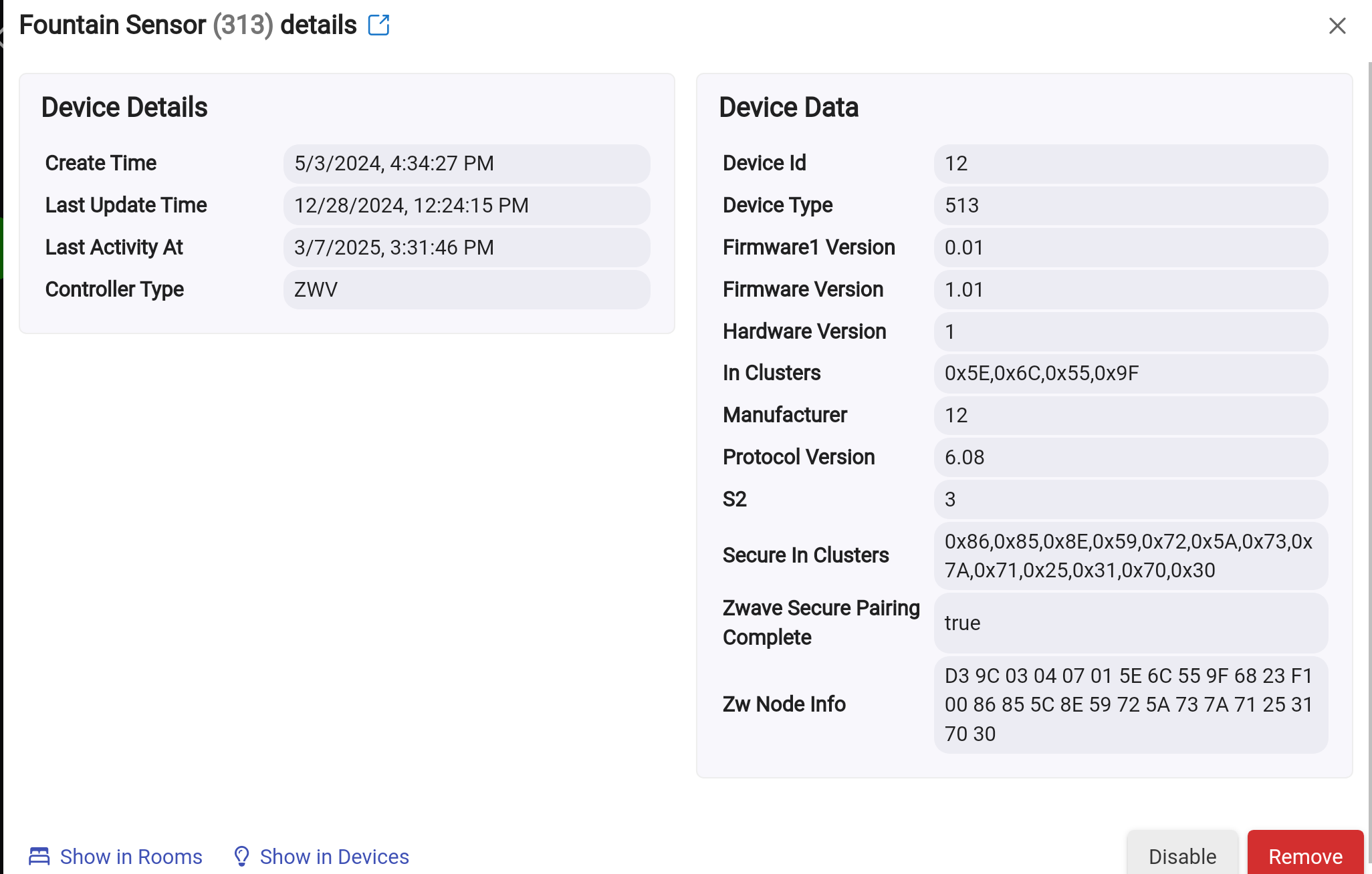

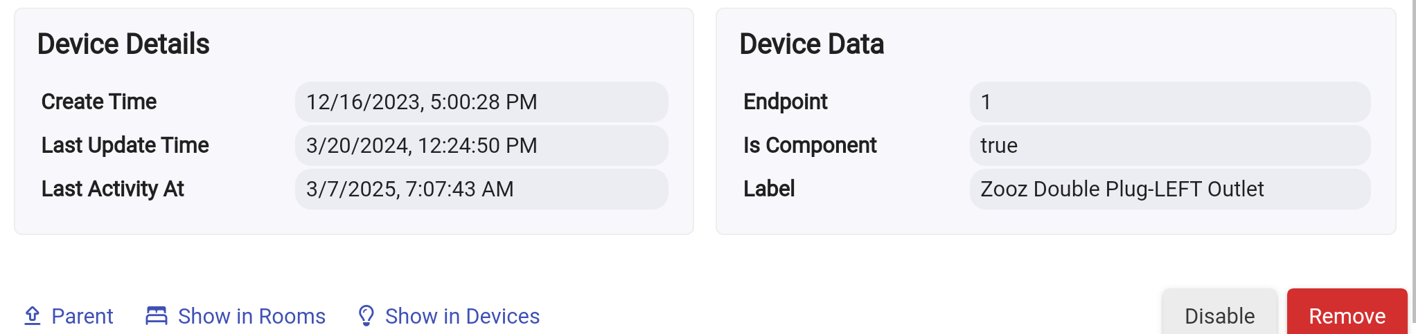

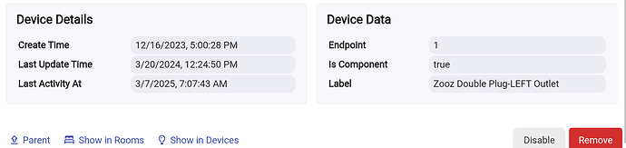

Detail displays
New ZEN05 LR
child device

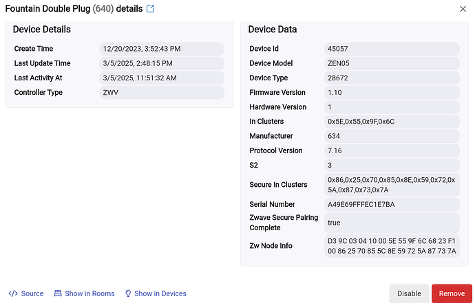

Old Zooz double plug
child device
Did the screenshots help? If not would it help to create a version with logging capabilities for me to run to figure out which data that's causing the problem?
I pushed up a new version late last night that should correct that issue.
