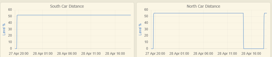

I use the Watchtower app to track the Level parameter for both sensors starting last night. The North car left today for a few hours. Here's the trace:
Looking at the logs, I'm not seeing rapid bounces between wildly different liquidDepth values. So the sensor is working (for now) as hoped, and I can write my rule for controlling the garage lights based on car presence or absence.

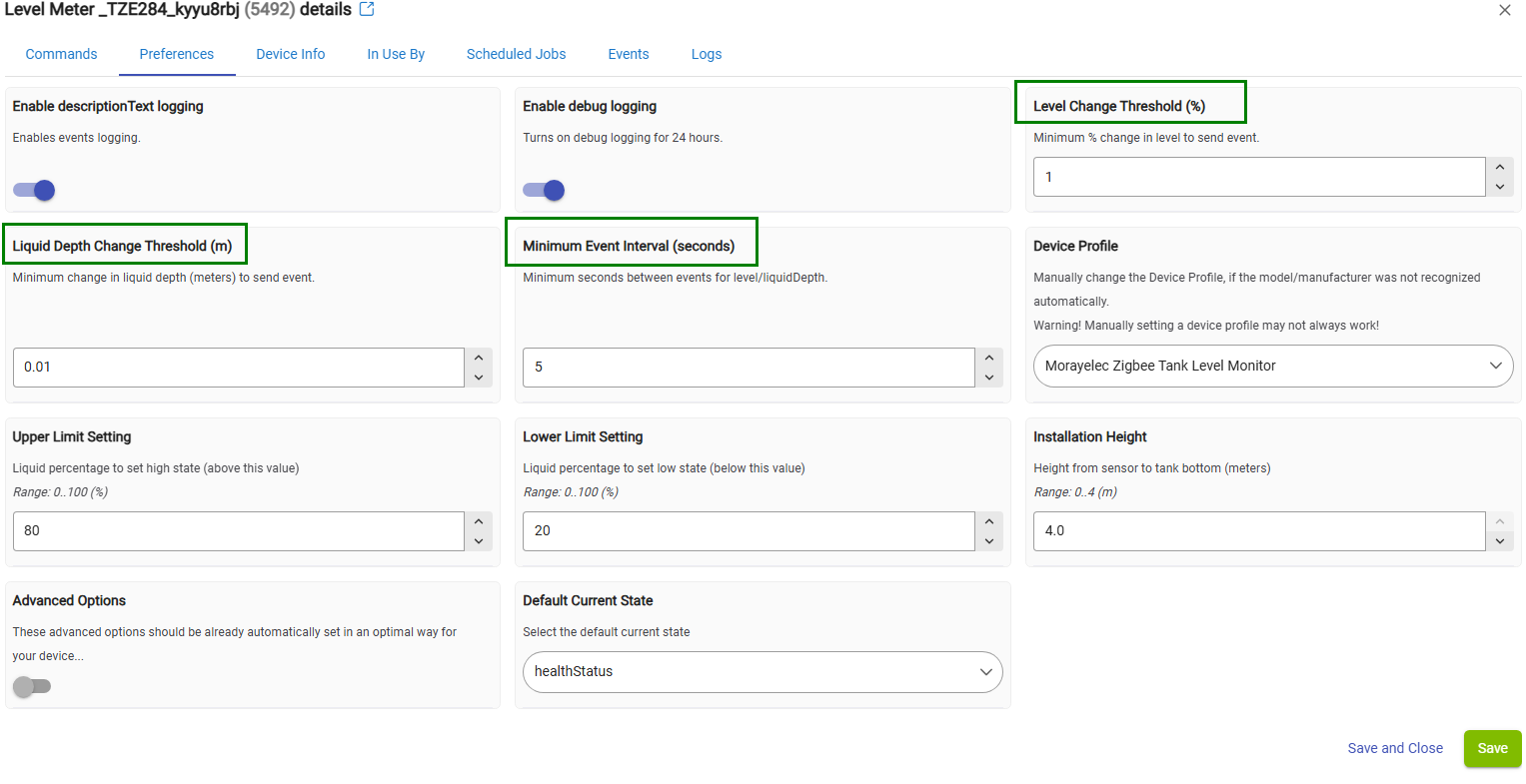

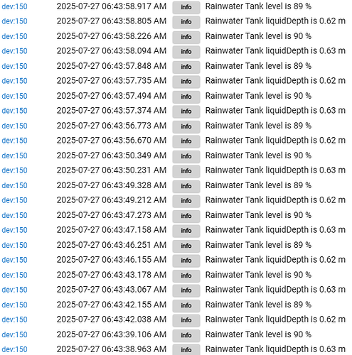

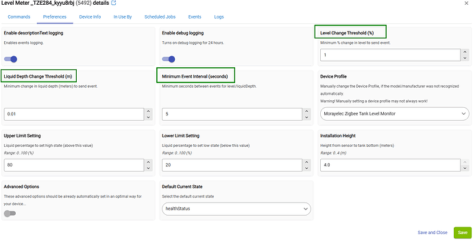

Is there any way to adjust the device report frequency or threshold? When it is right between two values it spams the zigbee network.
It is not possible to configure the frequency of the Zigbee messages sent by this Tuya device, as the reporting periods are fixed in the firmware..
I have added configurable filtering options in version 3.4.1 2025/07/27 6:13 PM :
Please update the driver manually (or perform an HPM 'Repair') and let me know the result.

The liquidDepth reading on both of my garage ceiling ultrasonic transducers* would bounce between 2 close values (e.g., 1.52 and 1.53). The new update from Krassimir Kossev reduces the excessive logging for that problem

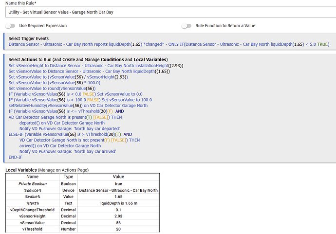

I was also getting spurious values of 5m (my ceiling is 2.91m from the floor). So I wrote a rule that filtered out those values, normalized all liquidDepth readings to be between 0 and 100%, and set a virtual omni sensor to "arrived" or "departed" based on a threshold value that works for me (I'm just trying to see if a car is parked in a garage bay or not).

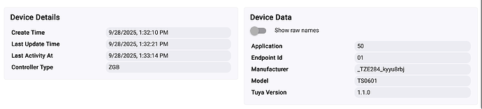

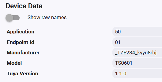

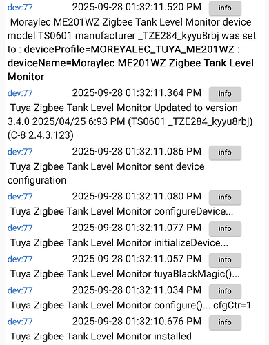

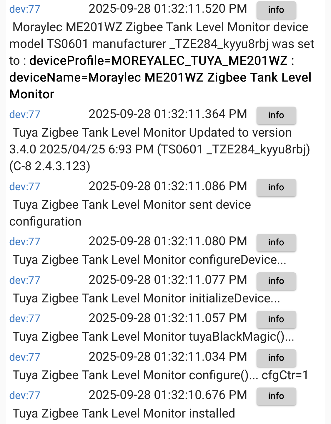

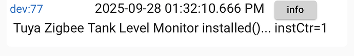

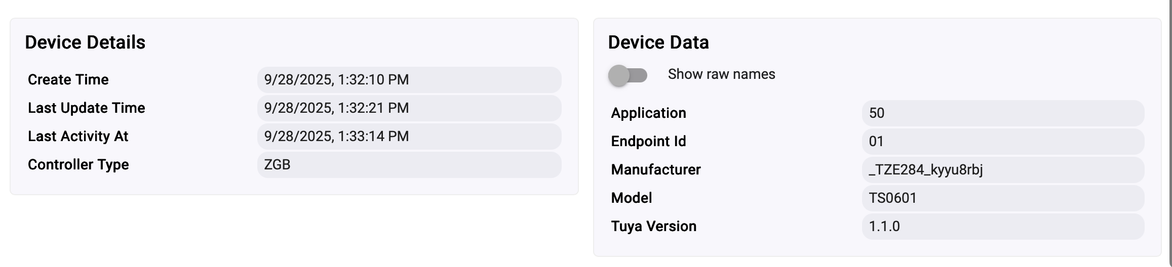

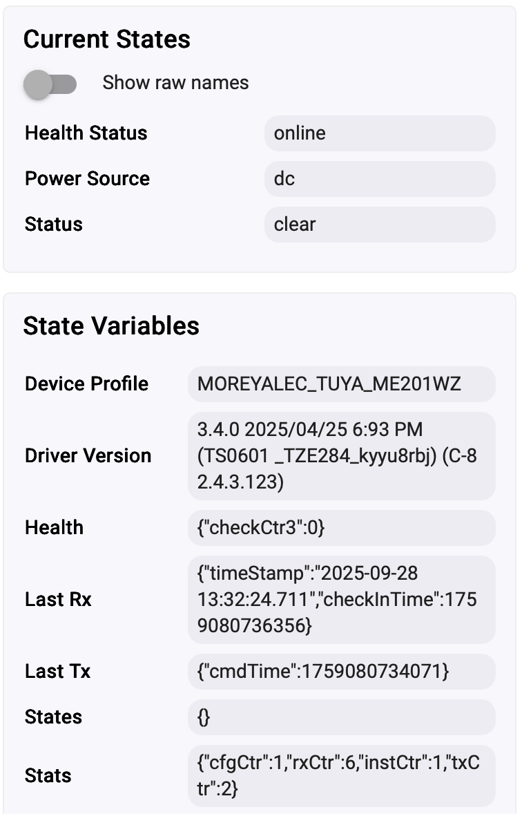

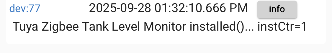

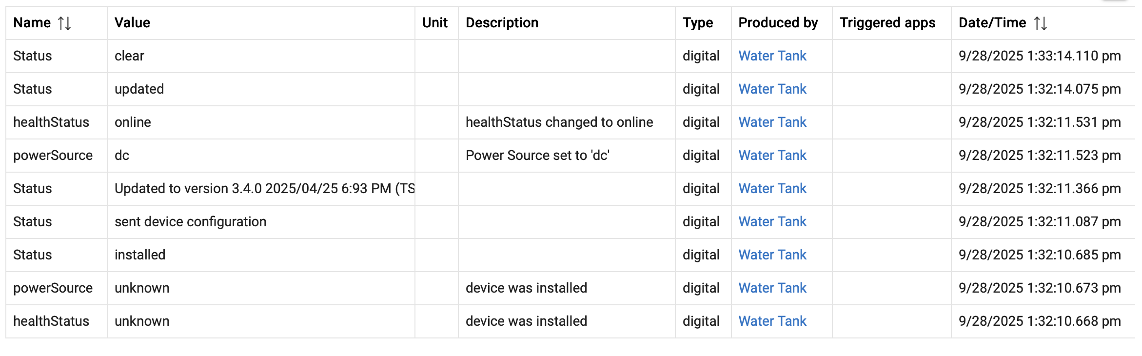

I am trying to install one of the ME201WZ sensors at our shore house and was looking for input. Here are the steps I took:
Tested at home. Connected to Hubitat C8 and got it working fine through Zigbee.
Brought the C8 and the sensor the shore house. I had been running the shore house on a C5 and upgraded it to the C8. There are no other zigbee devices on the C8.
I have then tried to add this device to the hub repeatedly. It does add but it always ends with the Red LED flashing slowly which the manual says means it is in Zigbee config mode.
I have tried removing it. Rebooting the hub, Running Configure, Loading defaults, refresh, etc. But it never seems to go out of blinking mode.
I have tried right on top of the hub - a couple of feet away, further. etc.

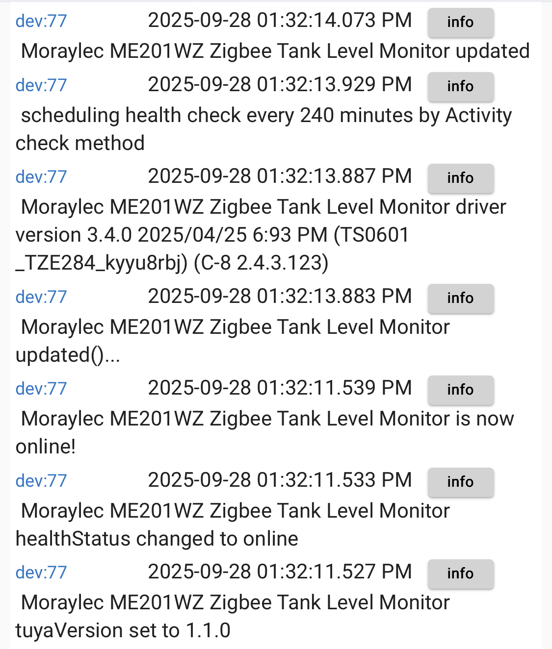

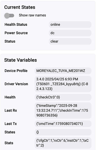

This is what I see in the driver:
Try this process, since this is a Tuya device:
