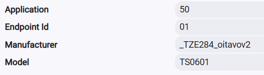

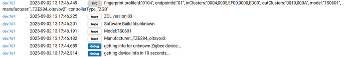

Hi @kkossev
I've just purchased a Tuya Temp and Soil moisture sensor.
Pairing it selects this driver but it isn't working as it should.
I manually selected TS0601_Soil_II but it doesn't seem to work.
Here is some info for you should you need it.
Here is the Get Info logs.
Any chance you can add this to your driver or perhaps it should already work.
Any help/advice much appreciated.
Many Thanks.
Try the updated ver. 1.9.1 2025-09-02 (dev. branch)
  • added TS0601 _TZE284_oitavov2 and _TZE200_2se8efxh to 'TS0601_Soil' group;
  • added TS0601 _TZE284_ap9owrsa to 'TS0601_Soil_2' group
Thanks @kkossev. The driver is working a treat.
