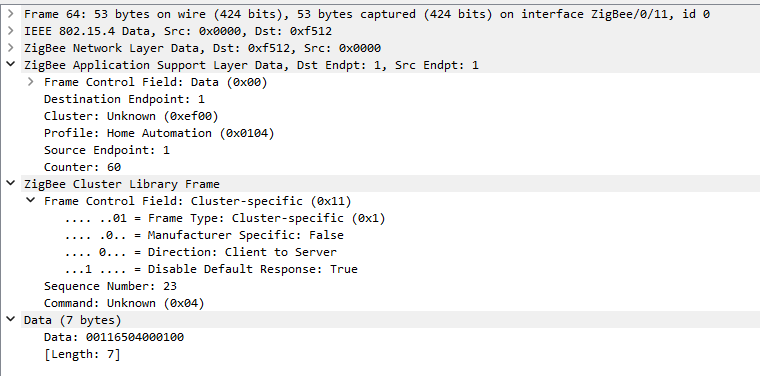

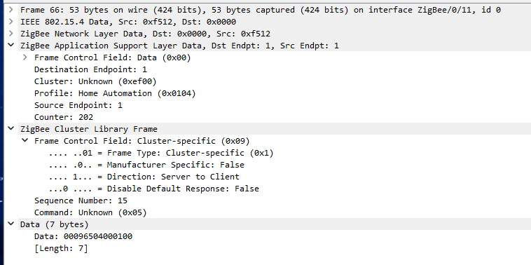

I can confirm the Tuya DataPoint ID for changing the display is 101 according to this method. Find Tuya Data Points | Zigbee2MQTT
Maybe this will be of use in getting these to display in F.
Next step is wire shark if this doesn't pan out

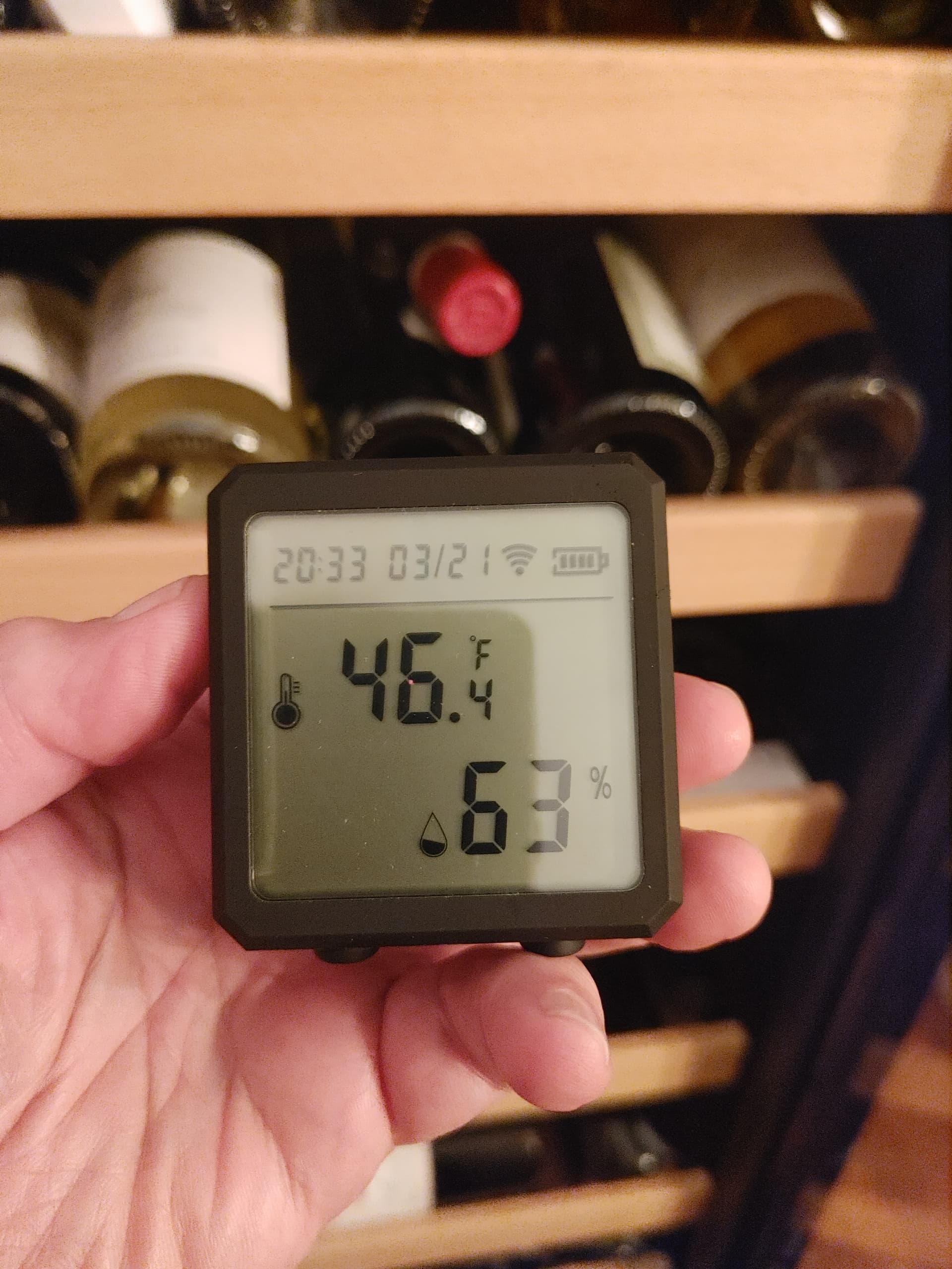

Pairing to HE, Zigbee2MQTT or a Tuya hub the display on the sensors all show temp in C. Only in Tuya app (so far) can the display be set to show temp in F.
Sensor
The one I have is different and shown a few posts back.

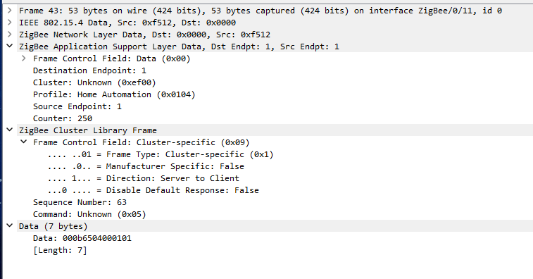

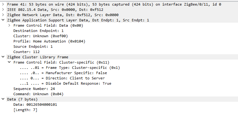

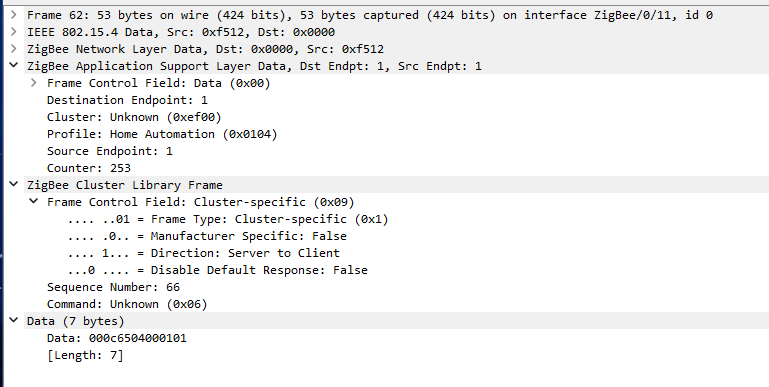

@kkossev I decided to play with wireshark. And the sensor I referenced above. I also found some info on the Tuya protocol at Serial Communication Protocol-Tuya Developer Platform-Tuya Developer
Here are the relevant packets sent to/from the sensor from a Tuya hub using Tuya developer cloud) to change the display on the sensor to read either F or C.
Sent to sensor to change to C
Sensor responds
To sensor to change display to F
Sensor responds
Hope this helps.
Mike

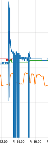

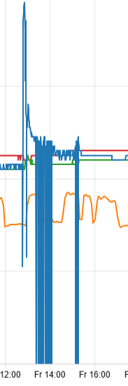

On a different note with these sensors they have a habit of occasionally (sometimes frequently) reporting erroneous/extreme low and incorrect humidity values.
Here's an example. The Green element in the graph below is one of these sensors on my patio. The Blue element is a different type of humidity sensor on another part of my property. You can see that both track pretty close but then the Tuya sensor reports an invalid humidity 2 separate times. This does occur over multiple units so it is not a one off instance. Just an FYI.
Blue line is in my main bathroom. The high peak was a shower.
thank you for the info and the head's up on the weird tuya values from time to time. i will watch out for these.

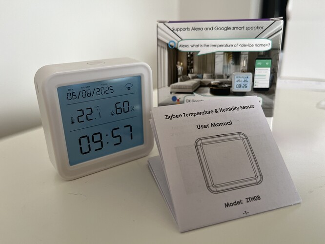

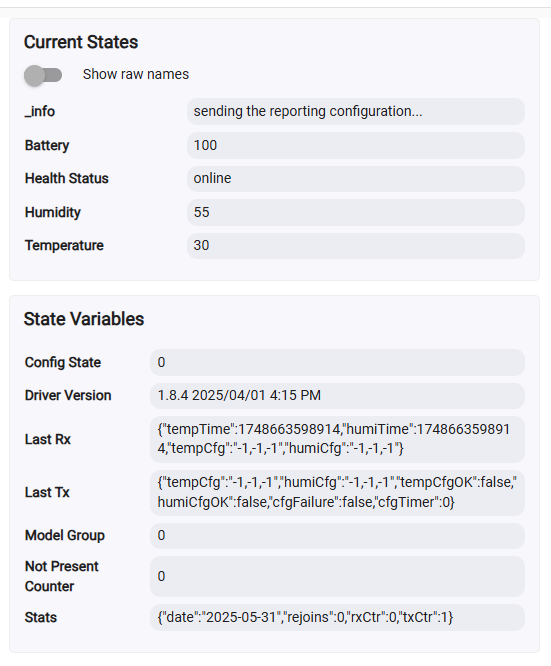

Hi @kkossev, about a year or so ago I bought the following tuya temp/humidity/clock from aliexpress:
I’ve only ever had partial success with your driver- it will set the time on the device, and receive one or two temperature readings, but then stops receiving any events.
Changing the model setting doesn’t seem to help.
If I remove the device from Hubitat, re-pair it and re-apply the driver, it will usually set the time again and receive a reading or two. Taking out the batteries, adding them back and playing with the driver has also given the same result one time.
Is there anything I could do to help troubleshoot the driver with this device?
I need to know the device Zigbee Model and Manufacturer, as registered on your HE hub.
Here it is:
|Manufacturer|_TZE204_cirvgep4|
|Model|TS0601|
Hi Matt,
Update the driver manually to ver. 1.8.6 '2025/08/12 7:43 AM' (raw code link).
You may need to pair the device again to your hub (without deleting it before).
I don't know whether it will work more stable, but at least the data received should be decoded correctly. Your device seems to be a new variation of an existing model.

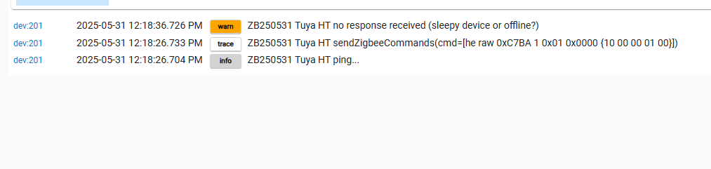

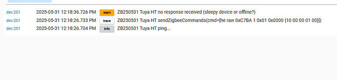

Installed the update and re-paired it. Like before, it still isn’t updating the temp or humidity beyond the first reading it receives.
I tried ping, refresh and reset statistics.
Would you like me to share the logs?
Just enable the Debug logging and then rapidly change the humidity. Is there anything in the live logs?
Don’t send any commands from the device web page, the sensor should send reports automatically.
