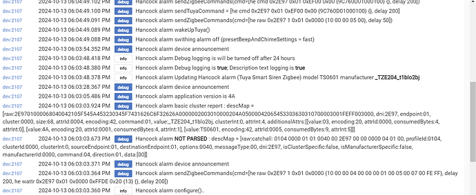

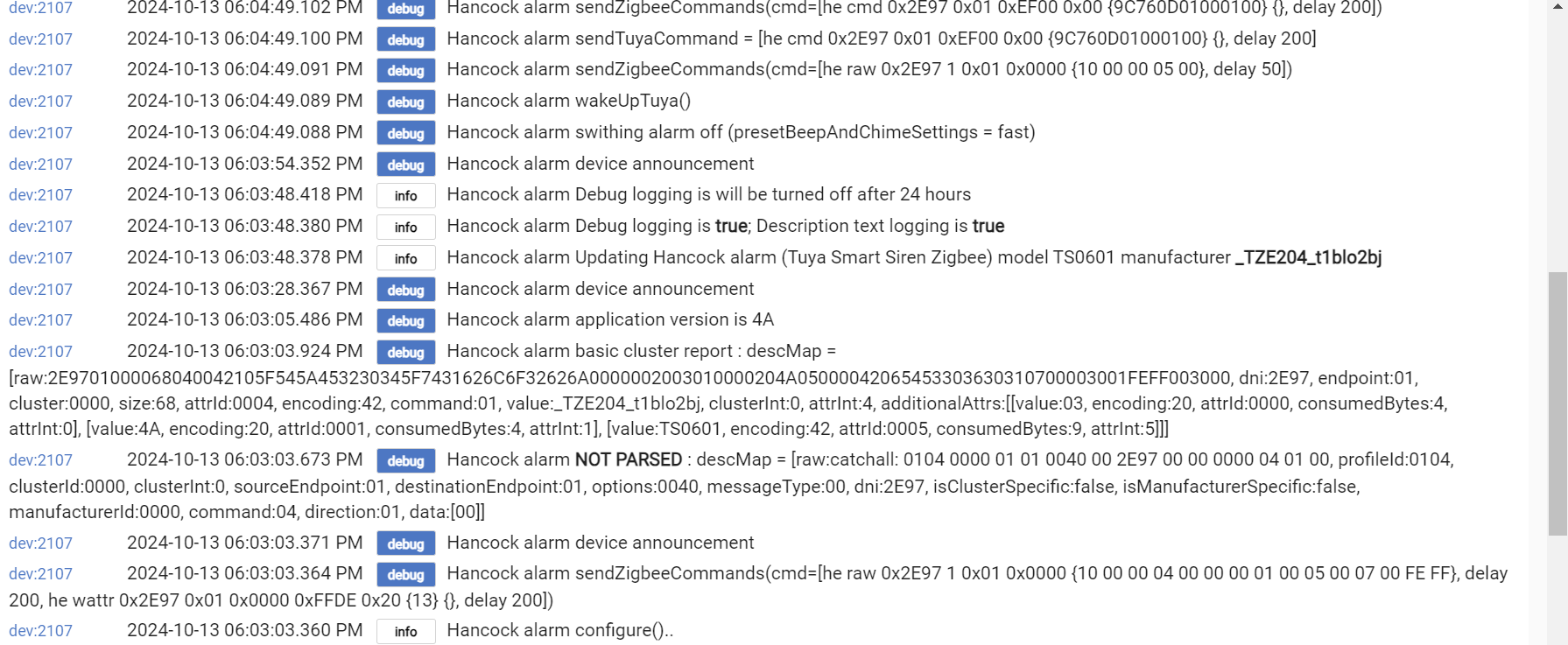

got it working but i think i see the probelm i rebooted hub and saw it check in and worked.

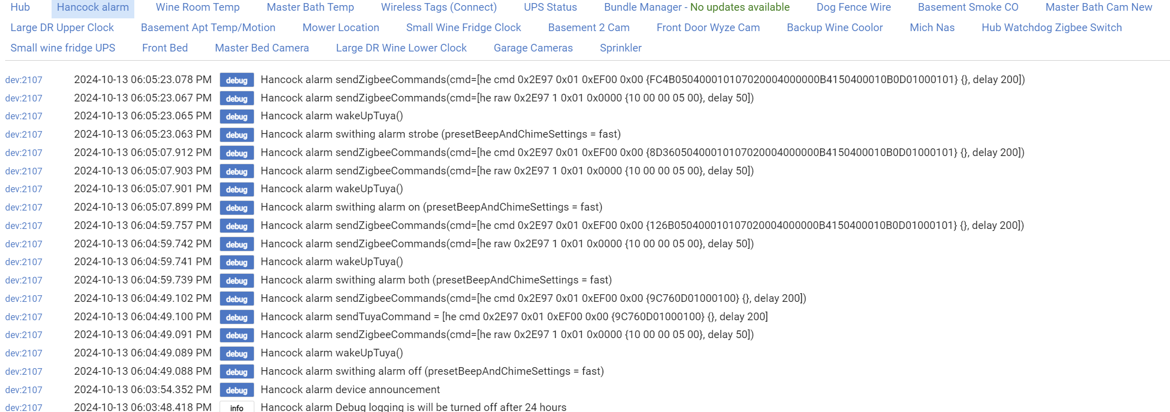

but as soon as i try the play sound command with the 3 options (it freezes up and no longer works for any commands) trying to reboot hub again now..
nope reboot didnt fix it.. it did come back with 2 msgs in zigbee logs. but still now does nothing.. will try the power.
Which driver version are you using at the moment?
If the siren freezes, remove and insert back the USB power - does this restore the normal operation?
I don't think there is a need to reboot the HE hub.

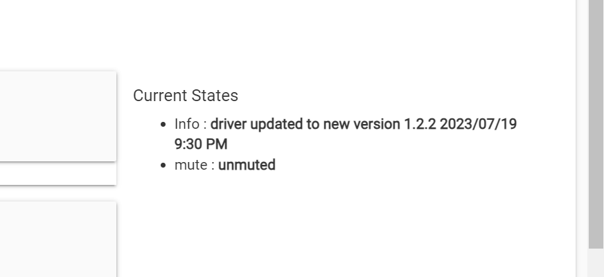

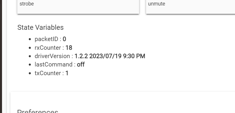

1.2.2
Use the latest version ( 1.3.2 2024/10/09 7:59 PM ).
There may be a bug in the old 1.2.2 version.
yep power cycling fixed it.. not sure why it is freezing up i cannot find the 1.3.2 link in the thread here
Yes, I noticed that the link is old... hold on, I will update it now.

yep that fixed the play sound etc. in my test set volumn doesnt seem to work.. on low or high sounds the same to my not so sensitive ear?
Set Volume has two parameters - for the alarm, the chime and the beep. Which one of the three volumes you are trying to change?
UPDATE: Yes, there seems to be a problem with the volume setup.
It is late here and I can't test the high volumes... :frowning:
Will look at this issue tomorrow!
