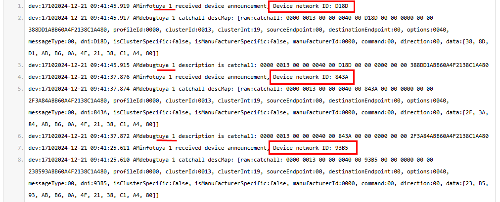

The pairing was not successful - the device changes its DNA on every pairing attempt.
The device responds to the commands sent to it for a short time (about 5 seconds as seen in the logs), before it leaves the Zigbee network.
If your hub is C-8, then use the Double Luck voodoo to pair the remotes.
