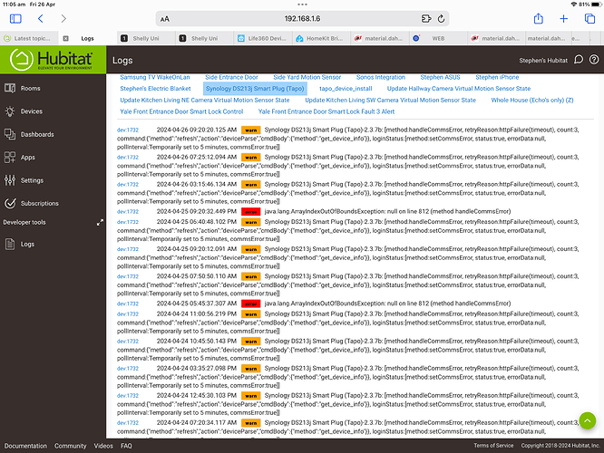

I have 3 Tapo P100 WiFi smart plugs connected to Hubitat using the community Tapo driver. They appear to be working fine but recently all 3 started generating log errors
The comms error for each device turns true briefly then a few seconds later returns to false. I am running the latest Tapo firmware (1.2.1) and Hubitat version 2.3.8.139 on a C-7. I didn’t notice these log errors when on 2.3.7.x which I was running before upgrading to 2.3.8 two weeks ago. Not sure if these errors are related to current Hubitat firmware or maybe something in with Router WiFi comms, though nothing has changed on the router recently.
Is anyone else seeing similar log errors on Tapo smart switch devices?
I am currently working on an update addressing a similar issue. Best suggestion is to do a plug reboot using the Preference "reboot" in preferences.

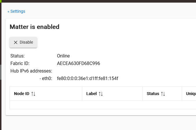

I triple checked all settings but never got any device to reflect. the count of available devices was always zero. I believe I can't have Matter devices (yes - I enabled Matter for this) as I don't do IPv6 - I disable on all my NIC's. While I'm not interested in debating my choice, I will add that what made me look was the IPV6 address being reported somewhere - I think in Tapo... I couldn't find any place in the HE to disable IPv6, and never did give it permission to enable it - fwiw.

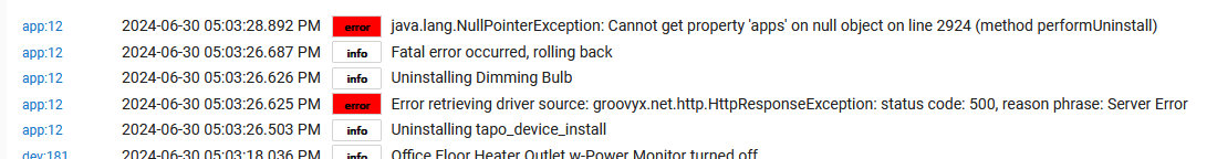

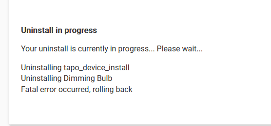

I went to pull TAPO out (I put it in off HPM) and got this error running HPM Uninstall:
I ripped all drivers, the app manually - I can't get it to unwedge itself. I manually added the drivers from your repo source and still no luck removing from HPM.
The error in HPM remains constant:
I did try modify's, repairs. etc. I sorta got a wedgie now... :slight_smile:
FYI - after I gave up on Tapo, I tried the deprecated Kasa ... device was instantly located... and functions nicely.
PS - I put the deprecated KASA on after TAPO, and have tried removing with KASA both installed and uninstalled - no change. Suggestions to get TAPO back off my unit?
EDIT - I just stumbled over the IPv6 that isn't documented in my hub _ I found this as I was about to turn Matter back off:
What is the device Model?
If the device installed using the Kasa integration, the device was not a TAPO device and that is why it would not install using TAPO. (Note there is also a built-in app for the Kasa devices.) Your device is apparently not Matter (this can be confirmed with Model number).
Getting Tapo code off system.
First try going to Package Manager settings. At bottom of that page, select Remove a Matched Package. If that fails, Uninstall HPM, remove the Tapo drivers/app, reinstall HPM, do a match-up in HPM. Current plugs the KP125M and EP40M (the M denotes Matter in the Kasa Brand).
many thanks. I'm definitely not TAPO. I misunderstood I guess that Kasa integration had rolled up into Tapo.
I'll run the steps you suggest - they make perfect sense in hindsight.
