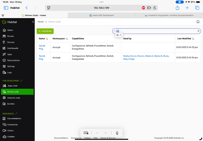

Which driver should I update, I have the two (HPM issue I think!) or am I better waiting for the release via HPM? I don’t want to break anything.
The app that is used-by your devices (second on the list). And yes, it is an issue in HPM that I created. No ready resolution. Caused by a product structure change and HPM limits. Does not impact operations.

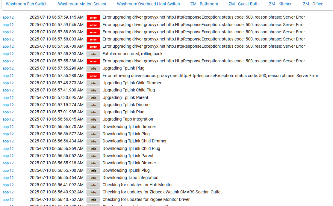

HI Dave - any thoughts why I'm getting a 500?
The App looks normal:
turned on debug, ran hpm repair, and it ran clean, then showed no avail update.

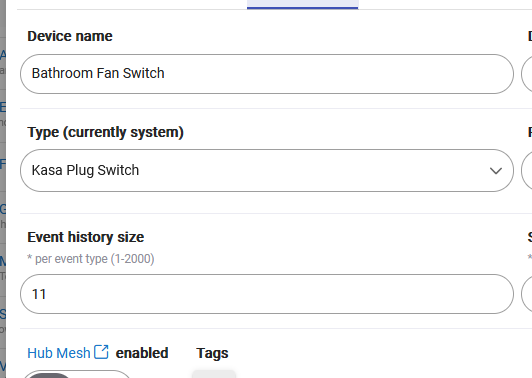

opened a device and find it is using 'Kasa Plug Switch' not TP Link device driver - This model is a KS200.
Should it be a TP Link Child Plug instead?
First log page. HPM log? I did not have any issues and I am by no means other than an HPM user.

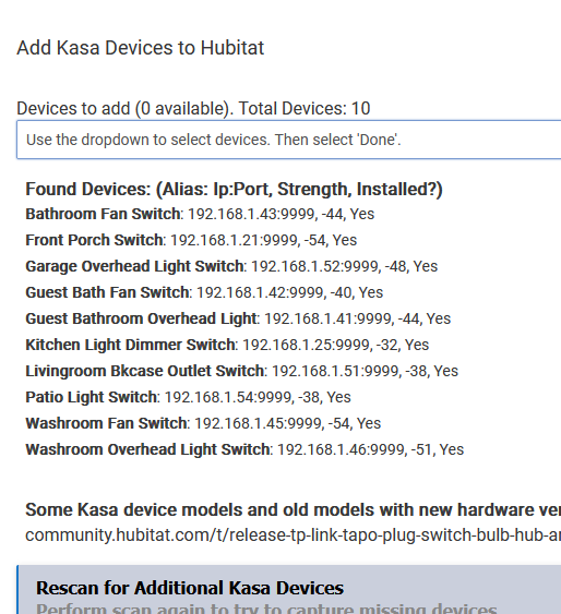

First App page: NOT TP-Link nor TAPO?????? This is Kasa. Note the KASA Bathroom Fan is on the List (see below)>

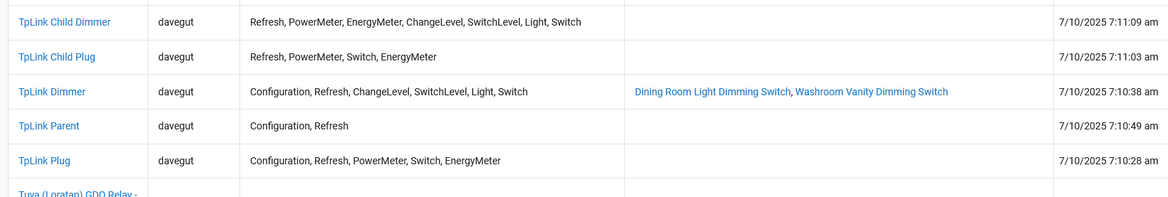

First Driver page. tells me these are the TAPO devices installed, not KASA. Since you define the drivers to install, the information is useless except that the drivers were reloaded today.
KS200 Device Page. Apparently, this is a KASA device. The KS200 is a Kasa switch, and never a child device (except to the app).

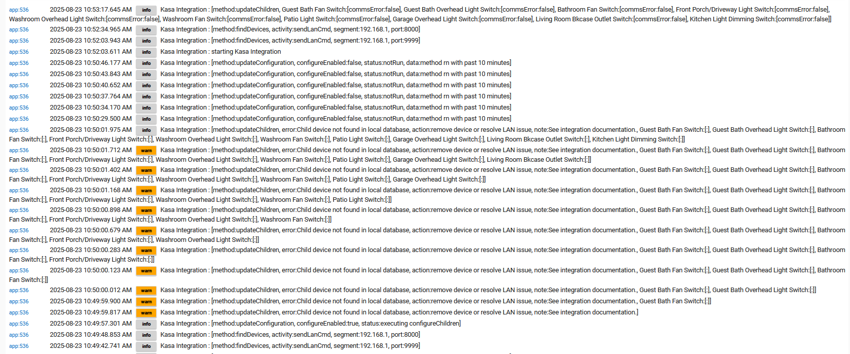

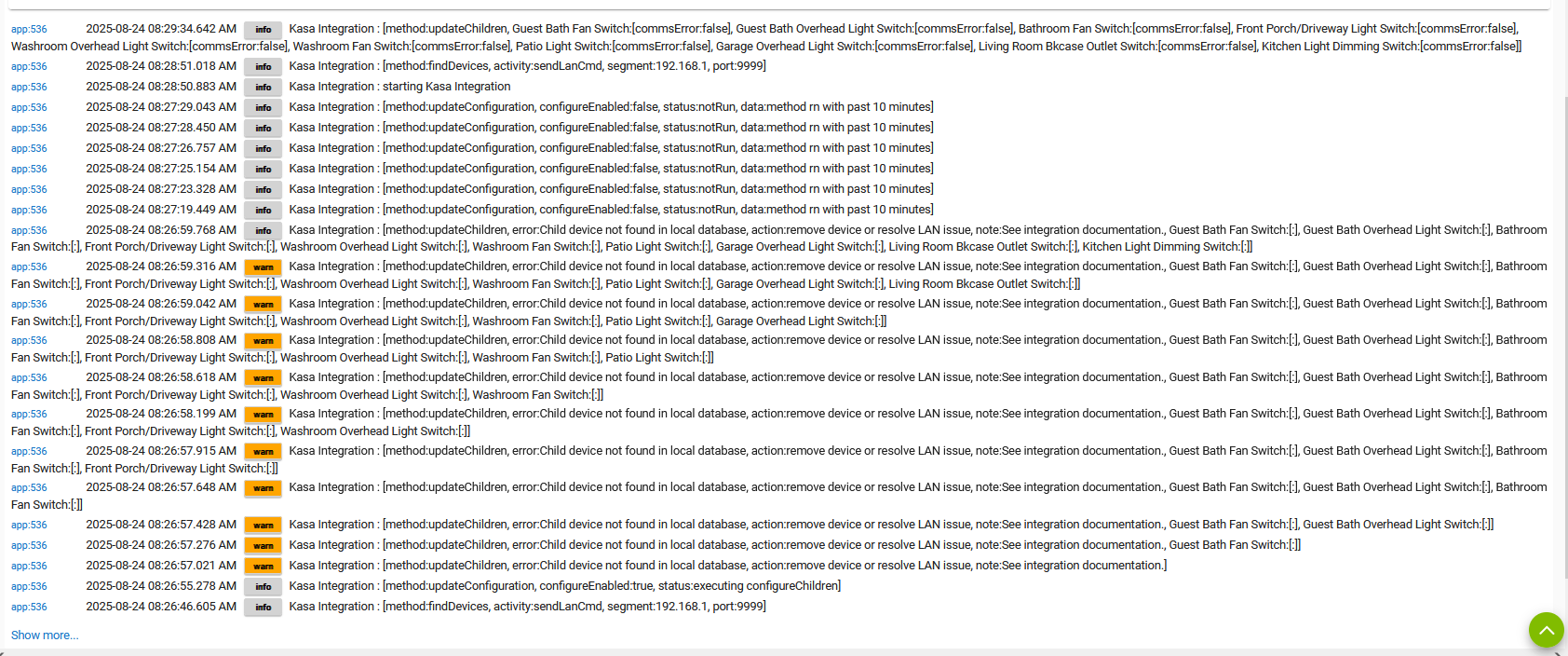

Looking for comments about this - I recently had issues and needed to debug rebooting over and over. While scanning logs for explanations I saw this and wondered if it had any impact on my boot time. I am NOT having any KASA device problems - just wonder if the Kasa devices are loading before the actual app loads? Is there any concern here?
This log snippet is after a reboot and starts at 10:49 - exactly when the he c7 begins to complete a reboot and the web GUI starts to load. I see the app start at 10:52, but the devices begin reporting warnings at 10:49-50 ish - then clear up once the app is doing it's magic.

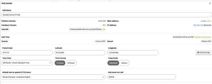

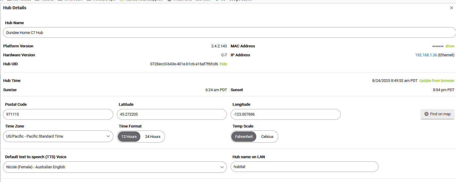

Please verify hub software version.
No major impact. Total time is the time to add adevice to the message text and fire off the message.
I could not duplicate on my C8 hub. It is probably an artifact of you scanning Port 8000 and Port 9999 for devices (set on the app start page). Note: I can't fix without having a means to test the fix (would have to use port-forwarding).
Thank you for commenting. I'm not concerned with this and am not hoping are expecting anything to come of it! thanks for reading.
I had a KASA device from sometime back on port 8000, the other 9 are on port 9999. I've changed all devices to use 9999 and removed the 8000 from my Kasa app.
I believe I'm on latest version -
I will look at the code and see if there is anything I can fix. Again, I can not duplicate - doesn't mean it is not real.
Priority is low since operation is not impacted.
