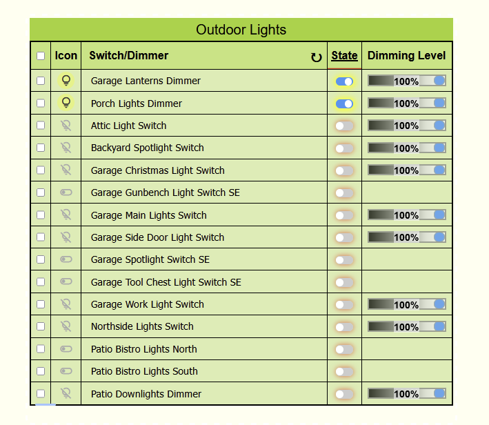

I had tried Smart Grid, and got this far:
I'm not seeing a filter function there to select only switches/dimmers that are ON (I'm trying to display a late-night check screen that shows only lights that are ON).

Another question about Smart Grid: I have over several dozen Inovelli Blue 2-in-1 dimmer/switches that can be configured as a dimmer or as an ON/OFF switch. In Smart Grid, all of my Inovelli Blue's configured as switches appear instead as dimmers, with a slider and all. Is there any way around this?
I just took a look to refresh my memory and the filtering is limited to a few sensor types at the moment but I’ll take a look at adding switch status. No promises but it seems very doable.
As far as the dimmer slider goes you can hide that column under Customize\Headers & Columns.

I don't want to hide the dimmer slider column! I have some Inovelli Blue units configured as dimmers and some as switches, so I'd like the dimmer slider column to show sliders for the dimmers but NOT for the switches. So is there some way to teach TB which IB devices are dimmers and which are switches?
