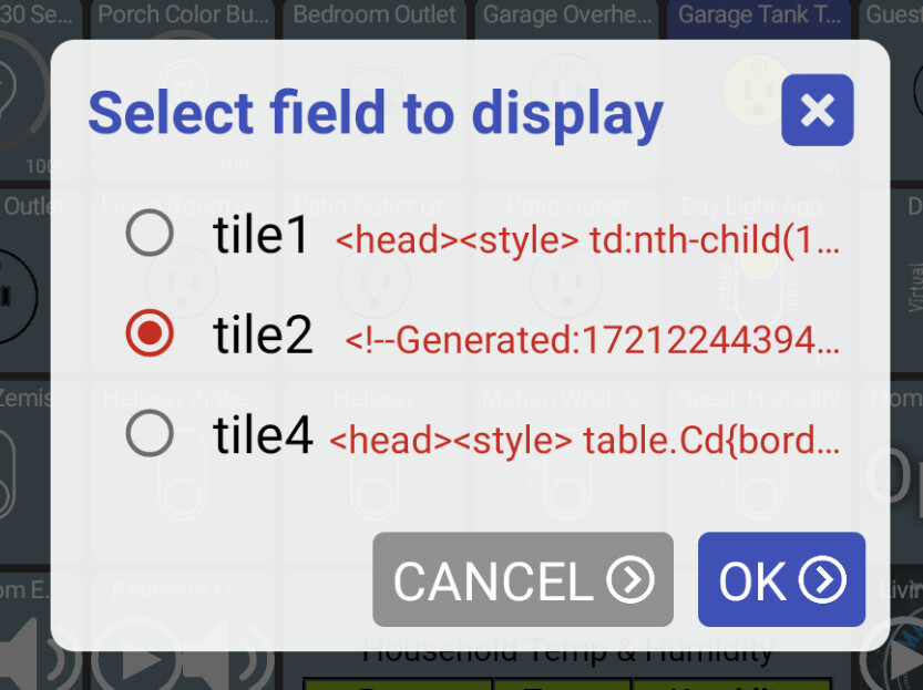

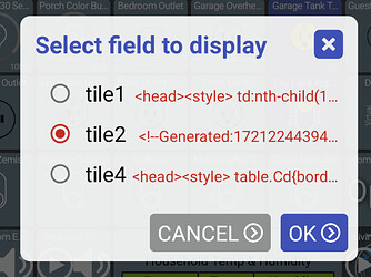

Then I rebuilt the tile, and assigned it to tile 3's now empty spot. It looks great on the device in HE. but in HD+ it's not reflected. Here are 2 screen caps to demonstrate the disconnect:
As you can see - tile3 isn't there. I've deleted it from HD+, I've reloaded HD+, cleared cache and tickled it in numerous ways. It simply isn't showing on HD+ side. Thoughts?
Can you send me the JSON for this device? Basically look at MakerAPI in Apps and click on 'show all devices with details'. That's everything but I'm only interested in that specific device so you can send it all or just search for your TB device and copy/paste that into an email or DM.
For that 'select field to display' dialog HD+ shows any attribute which it thinks has some valid HTML in it.. maybe there's something in tile3 which I just need to add support for
Let see what is going on. Go to the Tile Builder Storage Device and down to the state variables.
Find the one that corresponds to your empty tile. Copy the value of the message and send it to me. If it contains a cloud endpoint you can DM me.

sent to you via pm... keep in mind, the tile 3 did show in the device, just not in HD+ as an option! I suspect it has to do with instead if beginning with a
or ...
Thanks for the quick response. I had no time yesterday to take a look when I got home but I did notice that it's fine on my dashboard at home. So it would appear to be browser specific for me. Not showing on Chrome but Firefox is fine. I'll check the state variables later, I should have some time when I get home today.
I've compared those versions again and see nothing that would account for it. Presumably the generated content is different and I think that is the clue I need. If you are O.K. with where you are at and don't want to fiddle with it I understand.
But if you do want to resolve it I need to see the output from the working and non-working tiles. To get the output, go to the Tile Builder Storage Device and scroll down to the state variables and find the one for the tile in question and send it to me.

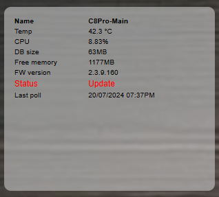

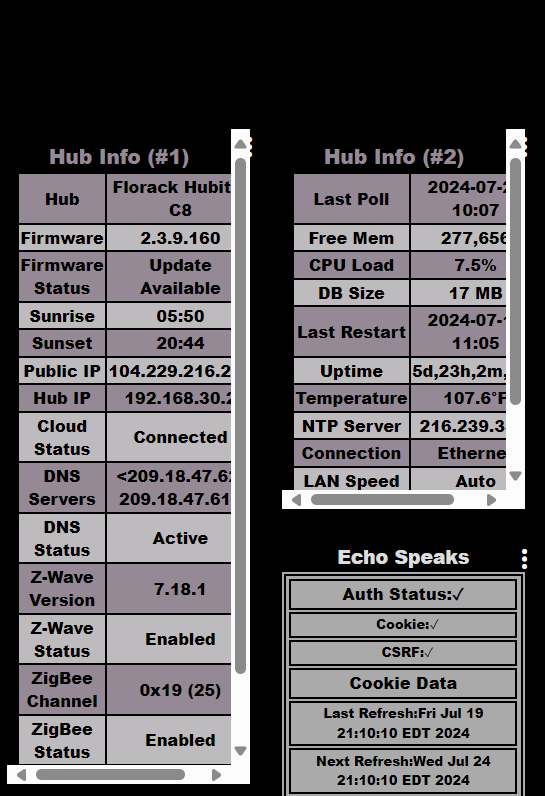

I am running all of the latest Tile Builder app versions (as of 20 July). If it makes any difference, I am on the Hubitat beta, currently running version 2.3.9.160. As of one of the latest Tile Builder updates - I'm unsure which one but I believe it was one of the last two, my two Multi Attribute Monitor tiles now have horizontal and vertical scroll bars. It was not this way previously.
The tiles are presented this way on both Google Chrome and MS Edge. On Safari, the two tiles do not show up at all now. They did previously. I have run an HPM repair without any change. I'm happy to provide any details that can help with the diagnosis.

I am seeing issues with the Multi Attribute Monitor tile.
As I have about 10 of those I can share some insights.

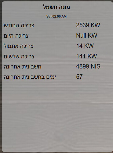

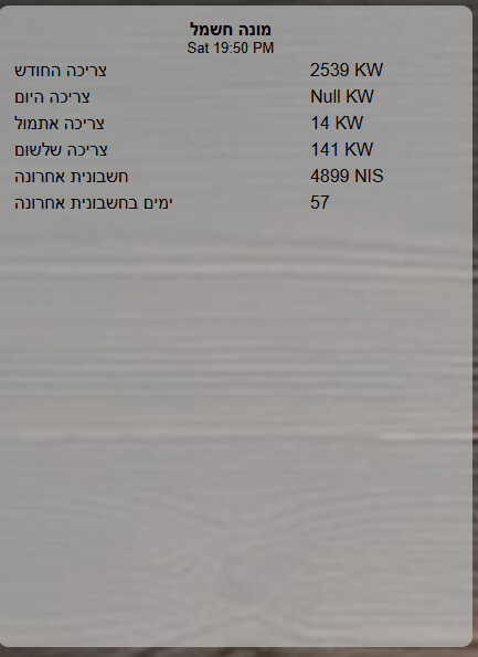

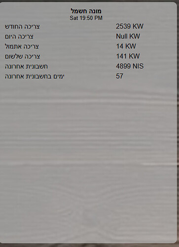

Out of the 10 MAM tiles, 8 of them changed their appearance and became shrunk (smaller fonts):
The only 2 that where not affected share one thing in common and that thing did not happen to the 8 changed tiles,,,,, they did not get new info since the update thus did not go through the update process.
I manually refreshed one of them to show you the difference before and after.
Before
Summary
After
Summary
I guess I could manually change the fonts again and I will if you tell me we stick to this change so I do not have to redo them again later.
Hope this help.
@amithalp and @lflorack1
Just FYI that this issue was reported a few days ago and I already have the fix done and tested. I will be sending that out this afternoon, probably in the next hour or so.

EDIT: THE UPDATE HAS BEEN PUSHED AND THE VISUAL ERRORS SHOULD CORRECT THE NEXT TIME THE TABLE REFRESHES.
Thanks for the fix. I tested it out and it works great.
