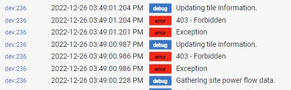

I know this driver has been abandoned, but I just got solar turned on and applied the api key and everything, and getting this error
Any suggestions?
Was going to say I needed to get the installer to set this up, but that culminated in them providing me with the API key from memory.... Perhaps wait 24 hours?
The API key is either wrong or the user the API key was generated for doesn't have access to your monitoring site.

I get a 401
Same. I would love to hear from someone who has this set up and it is still working to see what their settings are, or maybe what conversation they had with the installer/whoever when they got the API key.
I am going to see if I can get a new API key from the installer, and see if I get the same error.
Ok. Problem solved. Got a new key and it must have been the old one wasnt saved or something.
Good to hear.
On another note, you'll always get a 401 error on (https://monitoringapi.solaredge.com/ unless you are connecting to it with authentication. So you can't just browse to it, you need to send extra authentication headers. 401 is the correct response if you just put that address in your browser and go.
Good to know. Thanks again!

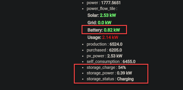

Been looking at the battery readings that come back for my setup and I have adjusted my copy of the driver to record the "storage" power flow results, such as battery power (flow), status (Charging, Discharging, Idle) and charge level. I can send through the updated code if you are interested.
Here's an example of the response from the power flow api call, see the STORAGE section at the end.
0.9 kWh going into the battery (charging) with the battery already 52% charged:
Response: [siteCurrentPowerFlow:[updateRefreshRate:3, unit:kW, connections:[[from:PV, to:Load], [from:PV, to:Storage]], GRID:[status:Active, currentPower:0.0], LOAD:[status:Active, currentPower:1.79], PV:[status:Active, currentPower:2.69], STORAGE:[status:Charging, currentPower:0.9, chargeLevel:52, critical:false]]]
Notes:
  • The status can have values of Charging, Discharging and Idle.
  • The currentPower is always positive, regardless of the direction.
  • I adjusted a couple of other things to incorporate this into the flow colour logic and the power flow tile
