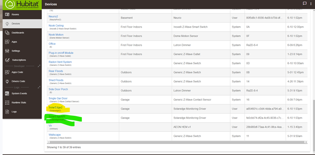

Problem. I pasted Groovy code and followed instruction to make virtual device. Added API info and key and get some data on the device page. But (a) Dashboard addition does not list it available to add
(b) I added another device name but same stuff, same problems

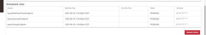

(c) I try manual refresh and have enabled showing update time but it comes up null. Also there seems be actions cued but never processed minutes later. I'[ve got all set for 1 minute intervals.

A few things I would try is clearing the data then manually refreshing it. If that doesn't work, try removing everything and adding it again. I'd suggest using the Hubitat Package Manager to make it simpler. Turning on debug logs might hint at why it's not setting the update time.
Thanks. I had device in twide and removed one of them., Then I cleared and refreshed and the dates did update. But all values are zero. Checking debug past log, I see all many error 429, too many requests. Also, checking Runtime statistics, this is the highest one at over 53% of busy. Still do not see the device available to select for a Dashboard tile. I'm going to delete everything related and start over.
429 means that you got rate limited. SolarEdge only allows 300 API requests a day and you exceeded that. As for displaying the tile in the dashboard you need to allow the device in the dashboard configuration.
I totally forgot about the authorize, and allowed it. Which attributes are recommended, so that I get most on a single tile? Still no data, tried changing the API key but that also check by site. Must be that all the playing around got it booted so I turned off updates and will manually check again tomorrow. I guess update at 1 per minute on even one item wont be allowed.

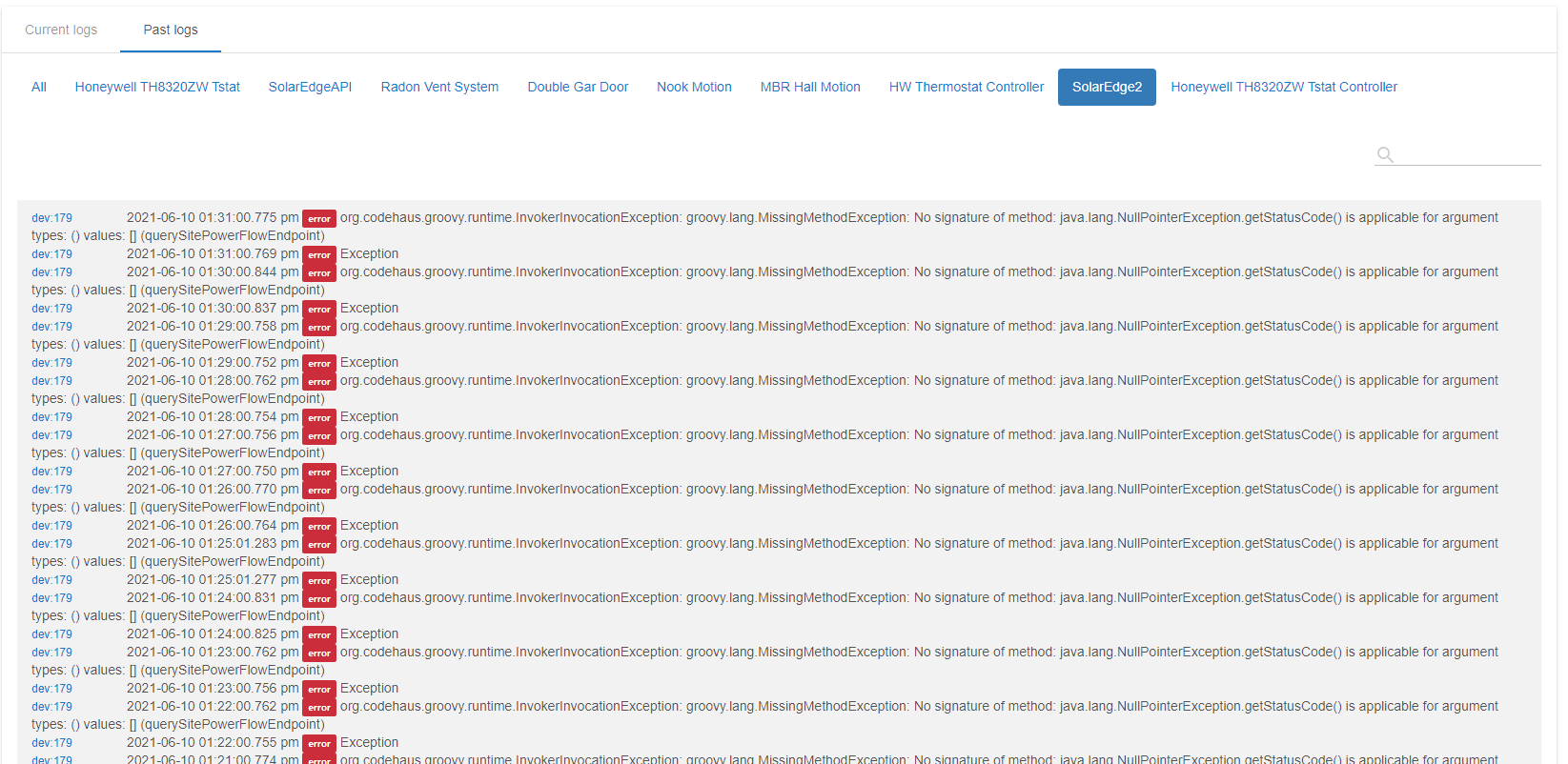

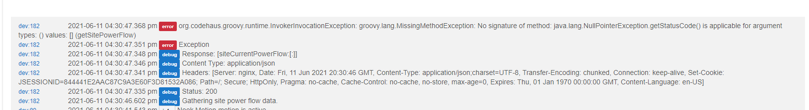

Getting better but some different errors in the Log
Looking at that debug log, there is no data for that endpoint being returned. I looked at the API documentation and found the following for that endpoint:
The response returns power flow for each of the elements in the system and their state. In case the site does not support this information, the response should be an empty object..
Looks like your inverter or site as they call it does not gather that information.
