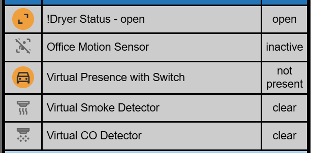

Additional Sensor Types
It adds 4 sensor types, Motion, Presence, Smoke Detector and CO Detector as shown below.
In this release I'm using an orange color as a warning indicator. Prior to this the open contact was marked as red, but in an effort to only use red when it is truly significant I've added orange as a warning. An active motion sensor, open contact, not present presence sensor will show all as orange. A "detected" state for a smoke or CO detector would show as red.

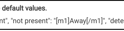

Formatting Tags
These have been under the Experimental tab so I don't know how many of you have used these but they are simply CSS classes that you can modify and use to enhance the visibility or appearance of items within the SmartGrid.
So I can combine these two techniques. I'll change "not present" for the Presence sensor to "Away" and I'll also add a tag to highlight it like this: "[m1]Away[/m1]"
and I get this.
