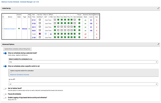

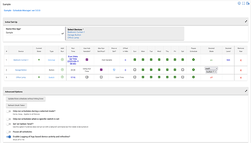

Description
This app allows users to configure a time table, per device, and schedule the desired state for each configured time. Users can select any number of switches/dimmers, schedule them based on a set time or sunrise/set (with offset), and configure the desired state for that time. Additionally, users can pause the schedule for individual times. Advanced options include only running for desired modes or when a specific switch is set in addition to the ability to manually pause all schedules.
Features
  • Schedule any number of switches/dimmers/buttons
  • Schedules based on selected time or sunrise/set with offset
  • Schedules based on Hub Variable time (date, time or datetime)
  • Individual schedules may be paused
  • Set desired state for switch/dimmer to be in at specified time
Advanced Options
  1. [Optional] Configure modes for which the schedule should apply
  2. [Optional] Configure a switch which must be set for a schedule to be applied
  3. [Optional] Turn "on" devices before issuing "setLevel" command.
    • Useful when a device doesn't turn on via a setLevel command
  4. [Optional] Pause all schedule
  5. [Optional] Restore device settings to latest schedule when hub reboots
    • When enabled, may be configured on a per-schedule basis
  6. [Optional] Enable dual times to run at the earlier or later value per schedule
  7. [Optional] Option to configure schedules not to run if device is already above/below scheduled level
Example
Edit

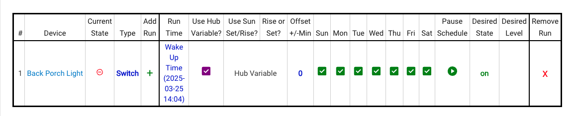

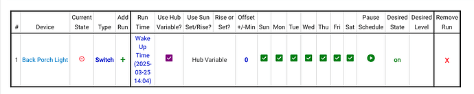

Release 2.0.0 - 2025-04-01
  • BREAKING CHANGE - Sunrise/set times will not update unless app is re-saved. It will still run, just using the sunrise/set values at the time the app was updated.
  • Additional error handling for default schedules and when new devices are added to a schedule
  • Support for Hub Variables (datetime) used as start time
    • This allows users to select a Hub Variable to be used as the start time for schedules
    • Can use datetime, time or date (at midnight)
    • Supports variable renaming
    • Registers the use of a Hub Variable with the Hub
    • Update schedules when the Hub Variable changes
    • May use offset with hub variable
  • Fix null pointer that happened occasionally when a new device was added
More info about how date/time Hub Variables are handled:
  • Datetime - Will run at this exact date and time.
  • Date - Will run at midnight of the specified date. You may specify an offset to change the time.
  • Time - Will run at the specified time for all dates (respecting the day of week check boxes)

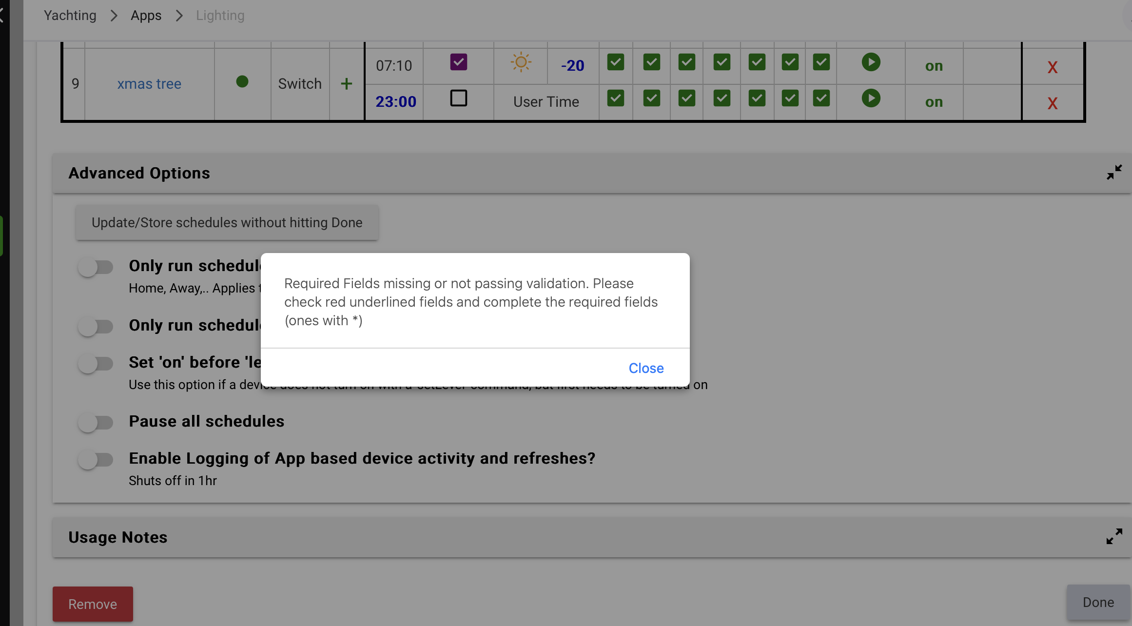

Im having a problem that when I click Done in the app, it seems to be not passing validation and requiring some field to be fixed or populated underlined in red, but there aren't any missing fields, underlined or with asterisk. Any thoughts? maybe a platform update recently broke something in the app?

Hmm, the only required inputs are name, devices and, if "Only run schedules when a specific switch is set" is selected, the switch and the status of that switch. I'm not sure why it'd be giving you that error, but I can probably find time to update my hub and test things out tomorrow evening.

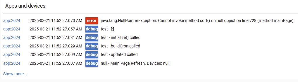

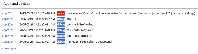

Just installed this App via HPM. It crashes as soon as I type in a name for a schedule and then click anything (like the "Select Devices [to] schedule" or "enter" icon). Log results:
HOWEVER, if I first select a device, THEN I can name the schedule, and no crash.
Glad that worked for you! I'm working on hub variables and am already planning on adding offset. I'll let you know when I release it.
Thanks for the feedback @John_Land. I have a fix for this in my next release.
