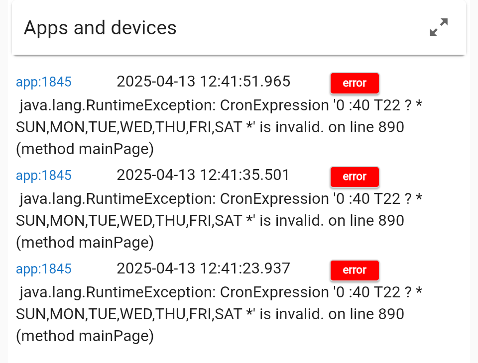

Tried the new version. Worked well for Hub Variables. But an offset from a Hub Variable caused an error: java.lang.RuntimeException: CronExpression '0 :40 T22 ? * SUN,MON,TUE,WED,THU,FRI,SAT *' is invalid. on line 890 (method mainPage)
EDIT: noticed that the values for my Hub Variable times in your app were in date/time format. I saved them as time without date. That could be an issue when adding an offset.

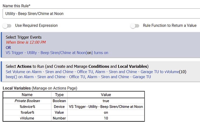

I've been looking for a scheduler for a while that schedules Rule Machine rules. I have a number of utility rules that run at various times that do more than turn on/off lights. I also like the UI for the Schedule Manager app. So here's how I cobbled together various elements to schedule time-based rules:
  1. For each rule, create a virtual switch (e.g., "VS Trigger - Utility - Beep Siren/Chime at Noon").
  2. As the Type for the VS, select "Virtual Switch uDTH Lite (user)". This is a user driver that can be downloaded via Hubitat Package Manager (search for "Universal Virtual Switch uDTH Lite").
  3. In Preferences for the VS, select "Force State Update ON" and set "Enable Auto-Off" for some time (I arbitrarily use 1 minute). The former setting means that setting the VS to an ON state in the Schedule Manager app will send an ON trigger to your rule even if the VS was already ON. The latter setting means you don't have to deal with resetting the VS to OFF in your rule.
  4. In your rule, use the VS as a trigger. Example (ignore the disabled old trigger in red text):

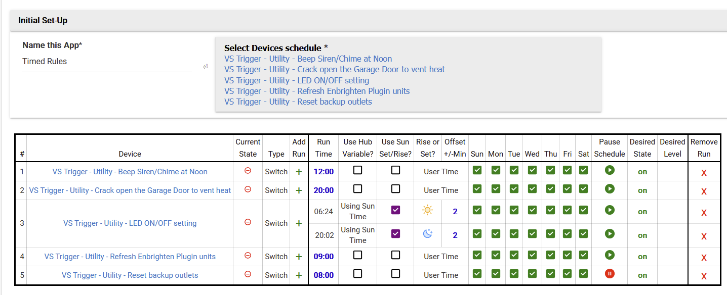

  5. In the Schedule Manager app, I created a new child app named "Timed Rules", and set a scheduled run for the VS. Examples:

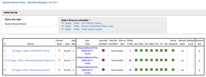

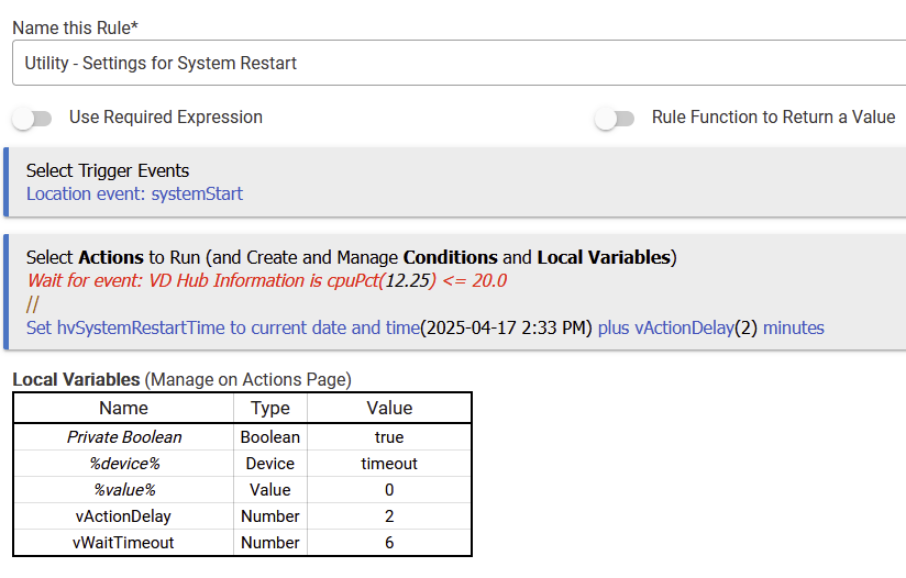

My next kludge is to create another Schedule Manager child app, "System Restart Rules" and a companion rule that sets a hub variable, "hvSystemRestartTime", to "now() + a few minutes" when triggered by Location event: systemStart. I can then schedule a number of rules to run using the hub variable and different offsets. Example:
  • Rule 1 is triggered by its VS when the run time = hvSystemRestartTime + 1 minute
  • Rule 2 is triggered by its VS when the run time = hvSystemRestartTime + 3 minutes
Here are examples for the "System Restart Rules" mentioned above:
