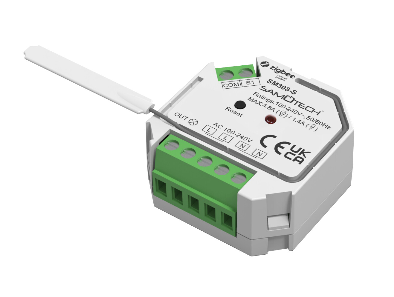

Samotech SM308, SM308-S and SM308-2CH
All support on, off and flash with configurable rate. The flash function has to be enabled on the preferences page as I consider it a potentially dangerous feature. It is disabled by default.
The SM308 is a standard relay switch module requiring live and neutral. It has connectivity for retractive local switches. The SM308-S is the same deal, and has now replaced the SM308, though this one can be wired with or without the neutral. The SM308-2CH requires neutral again, but contains two individually controlled relays and can support a physical switch for each.

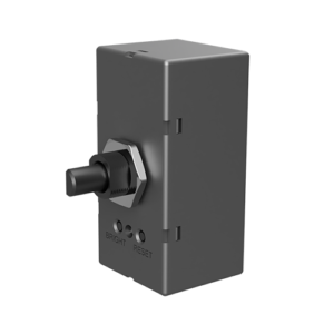

Samotech SM323
Supports on, off, level, and power reporting. The latter only functions when connected with neutral, so you need to enable it in the preferences.
I've also added a maximum level setting preference, as depending on the load type and presence or absence of the neutral connection it's possible to get flicker at high outputs. Simply turn up to full, then reduce the level down until any flicker vanishes. Note that percentage and enter it as the maximum level. The driver will handle the rest, including auto-reduction if someone cranks on the dial. In-device minimum brightness and the clever "boost-start" functions are unaffected and can be configured independently as per the manual.
