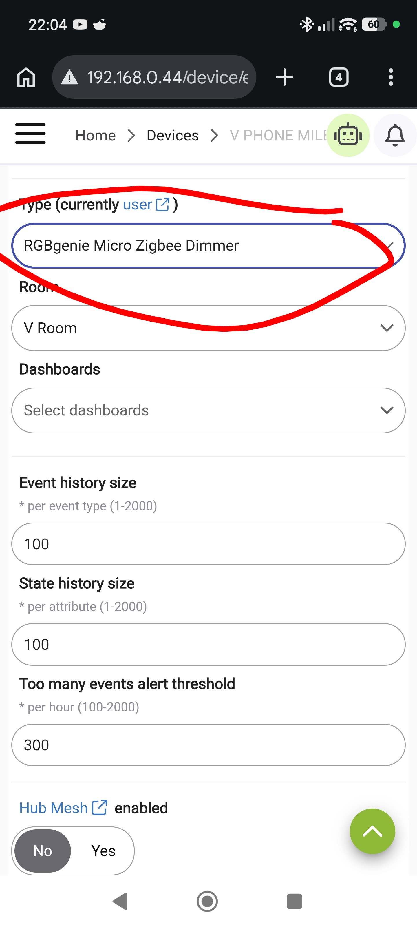

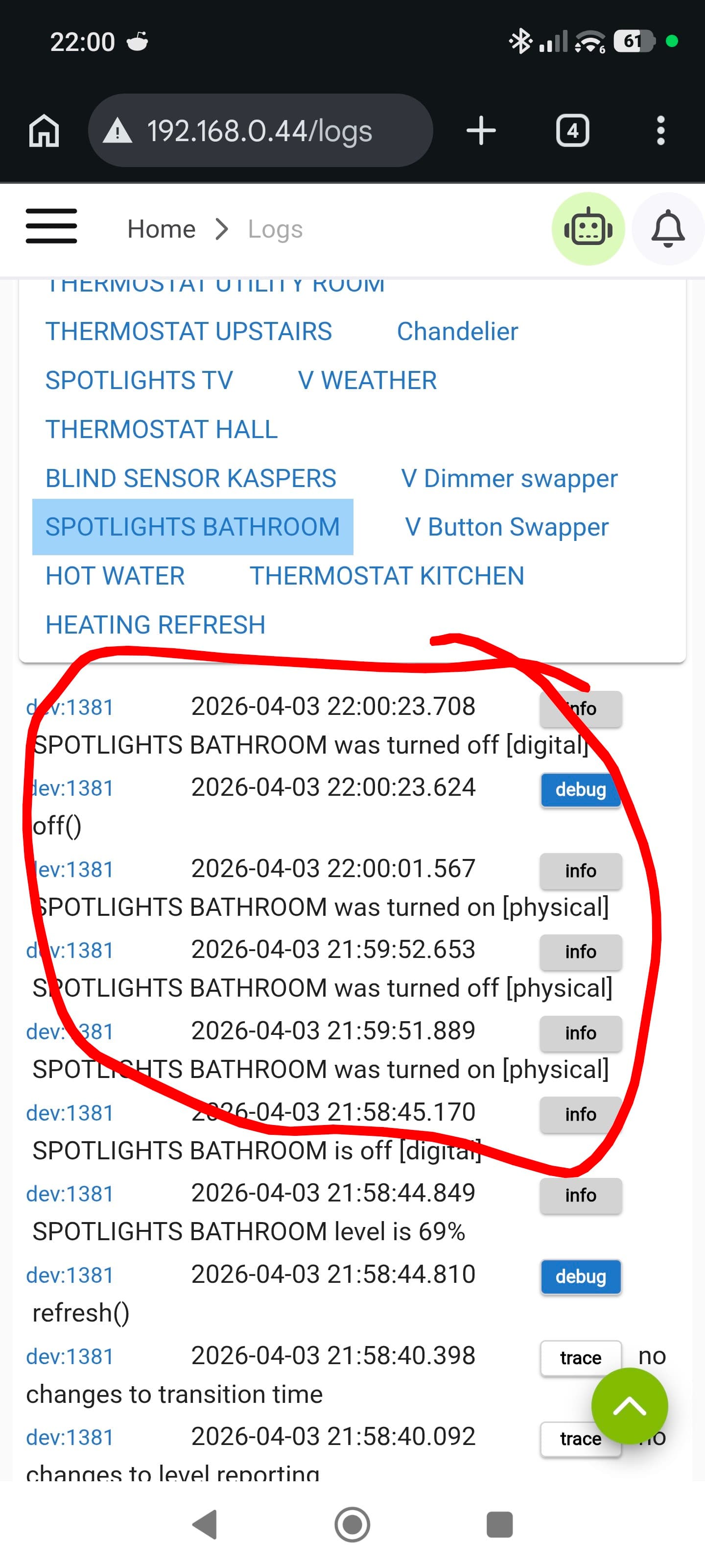

@birdslikewires could you help please. Are you able to change the driver so that the difference between a digital on/off and a physical on/off is recognised please. I have the sm323 V2 version whereby the logs just show on/off and omit the physical/digital narrative.
I formerly used a different driver for my original sm323 V1's and recall the digital/physical being apparent in the logs and working. I can't recall what this driver is/was.
A bit of a story to obtain WAF but I need this function to be available if you could please help a man in distress ha ha

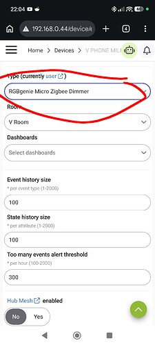

Oh, actually I found it @birdslikewires . See screenshots of the
RGBGenie Micro ZigBee Dimmer driver which shows the difference between [physical] and [digital] on/off's.
It would be awesome if you could bring this onto your driver

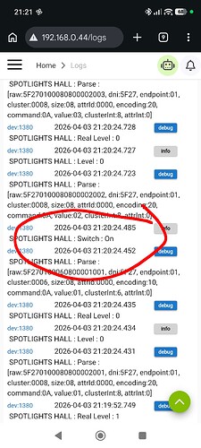

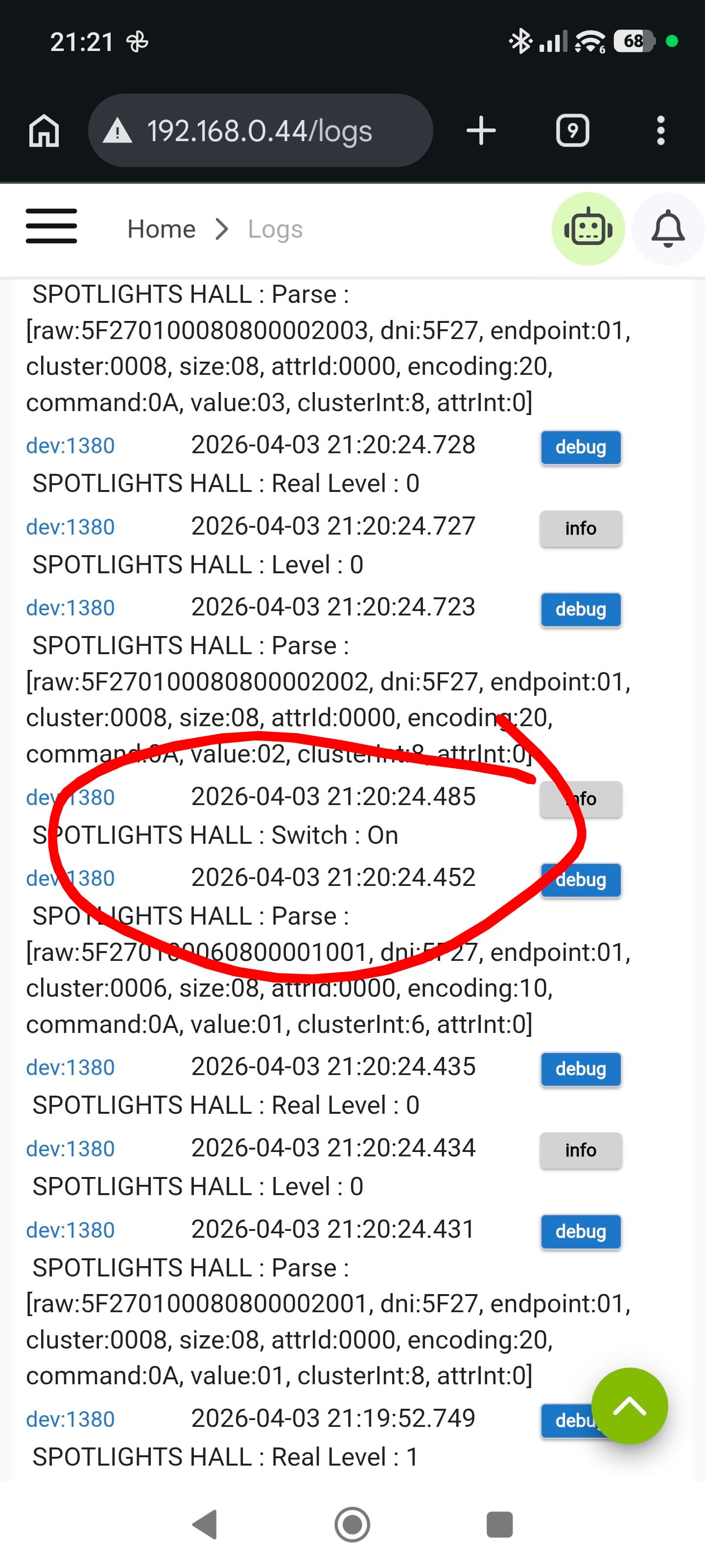

Oh, thanks you so much for this. So here are the first logs which show On/OFF controlled digitally from the Hubitat Commands Page. The next set of logs wil be the Physical pressing of the dimmer knob.

Hi, so thanks this far for helping out here. I've overwritten the driver with your new code but the result appears the same. Do you think I'm missing something somewhere. See logs below whereby the earlier 2 On/Offs are digital, the latter 2 on/offs are by pressing the dimmer button. Hope you can help, and appreciated in advance again :slight_smile:
dev:13802026-04-05 23:25:47.098debugSPOTLIGHTS HALL : Real Level : 19
dev:13802026-04-05 23:25:47.096infoSPOTLIGHTS HALL : Level : 19
dev:13802026-04-05 23:25:47.094debugSPOTLIGHTS HALL : Parse : [raw:5F270100080800002031, dni:5F27, endpoint:01, cluster:0008, size:08, attrId:0000, encoding:20, command:0A, value:31, clusterInt:8, attrInt:0]
dev:13802026-04-05 23:25:47.093infoSPOTLIGHTS HALL : Switch : Off
dev:13802026-04-05 23:25:47.088debugSPOTLIGHTS HALL : Parse : [raw:5F270100060800001000, dni:5F27, endpoint:01, cluster:0006, size:08, attrId:0000, encoding:10, command:0A, value:00, clusterInt:6, attrInt:0]
dev:13802026-04-05 23:25:43.739debugSPOTLIGHTS HALL : Real Level : 19
dev:13802026-04-05 23:25:43.738infoSPOTLIGHTS HALL : Level : 19
dev:13802026-04-05 23:25:43.735debugSPOTLIGHTS HALL : Parse : [raw:5F270100080800002031, dni:5F27, endpoint:01, cluster:0008, size:08, attrId:0000, encoding:20, command:0A, value:31, clusterInt:8, attrInt:0]
dev:13802026-04-05 23:25:43.614debugSPOTLIGHTS HALL : Real Level : 12
dev:13802026-04-05 23:25:43.611infoSPOTLIGHTS HALL : Level : 12
dev:13802026-04-05 23:25:43.606debugSPOTLIGHTS HALL : Parse : [raw:5F270100080800002021, dni:5F27, endpoint:01, cluster:0008, size:08, attrId:0000, encoding:20, command:0A, value:21, clusterInt:8, attrInt:0]
dev:13802026-04-05 23:25:43.355infoSPOTLIGHTS HALL : Switch : On
dev:13802026-04-05 23:25:43.350debugSPOTLIGHTS HALL : Parse : [raw:5F270100060800001001, dni:5F27, endpoint:01, cluster:0006, size:08, attrId:0000, encoding:10, command:0A, value:01, clusterInt:6, attrInt:0]
dev:13802026-04-05 23:25:42.555debugSPOTLIGHTS HALL : Real Level : 0
dev:13802026-04-05 23:25:42.554infoSPOTLIGHTS HALL : Level : 0
dev:13802026-04-05 23:25:42.552debugSPOTLIGHTS HALL : Parse : [raw:5F270100080800002001, dni:5F27, endpoint:01, cluster:0008, size:08, attrId:0000, encoding:20, command:0A, value:01, clusterInt:8, attrInt:0]
dev:13802026-04-05 23:25:41.620debugSPOTLIGHTS HALL : Real Level : 0
dev:13802026-04-05 23:25:41.618infoSPOTLIGHTS HALL : Switch : Off
dev:13802026-04-05 23:25:41.616infoSPOTLIGHTS HALL : Level : 0
dev:13802026-04-05 23:25:41.615debugSPOTLIGHTS HALL : Parse : [raw:5F270100060800001000, dni:5F27, endpoint:01, cluster:0006, size:08, attrId:0000, encoding:10, command:0A, value:00, clusterInt:6, attrInt:0]
dev:13802026-04-05 23:25:41.608infoSPOTLIGHTS HALL : Switch : On
dev:13802026-04-05 23:25:41.606debugSPOTLIGHTS HALL : Parse : [raw:5F270100080800002001, dni:5F27, endpoint:01, cluster:0008, size:08, attrId:0000, encoding:20, command:0A, value:01, clusterInt:8, attrInt:0]
dev:13802026-04-05 23:25:41.604debugSPOTLIGHTS HALL : Parse : [raw:5F270100060800001001, dni:5F27, endpoint:01, cluster:0006, size:08, attrId:0000, encoding:10, command:0A, value:01, clusterInt:6, attrInt:0]
dev:13802026-04-05 23:25:35.473debugSPOTLIGHTS HALL : Real Level : 3
dev:13802026-04-05 23:25:35.470infoSPOTLIGHTS HALL : Level : 3
dev:13802026-04-05 23:25:35.468debugSPOTLIGHTS HALL : Parse : [raw:5F27010008080000200A, dni:5F27, endpoint:01, cluster:0008, size:08, attrId:0000, encoding:20, command:0A, value:0A, clusterInt:8, attrInt:0]
dev:13802026-04-05 23:25:35.069debugSPOTLIGHTS HALL : Real Level : 1
dev:13802026-04-05 23:25:35.067infoSPOTLIGHTS HALL : Level : 1
dev:13802026-04-05 23:25:35.065debugSPOTLIGHTS HALL : Parse : [raw:5F270100080800002004, dni:5F27, endpoint:01, cluster:0008, size:08, attrId:0000, encoding:20, command:0A, value:04, clusterInt:8, attrInt:0]
dev:13802026-04-05 23:25:34.410infoSPOTLIGHTS HALL : Switch : Off
dev:13802026-04-05 23:25:34.408debugSPOTLIGHTS HALL : Parse : [raw:5F270100060800001000, dni:5F27, endpoint:01, cluster:0006, size:08, attrId:0000, encoding:10, command:0A, value:00, clusterInt:6, attrInt:0]
dev:13802026-04-05 23:25:34.369debugSPOTLIGHTS HALL : Skipped : Match Descriptor Request
dev:13802026-04-05 23:25:34.367debugSPOTLIGHTS HALL : Parse : [raw:catchall: 0104 0006 01 01 0040 00 5F27 00 00 0000 0B 01 0000, profileId:0104, clusterId:0006, clusterInt:6, sourceEndpoint:01, destinationEndpoint:01, options:0040, messageType:00, dni:5F27, isClusterSpecific:false, isManufacturerSpecific:false, manufacturerId:0000, command:0B, direction:01, data:[00, 00]]
dev:13802026-04-05 23:25:34.283debugSPOTLIGHTS HALL : Health Status : Last report received 5 seconds ago.
dev:13802026-04-05 23:25:28.606debugSPOTLIGHTS HALL : Real Level : 3
dev:13802026-04-05 23:25:28.604infoSPOTLIGHTS HALL : Level : 3
dev:13802026-04-05 23:25:28.599debugSPOTLIGHTS HALL : Parse : [raw:5F27010008080000200A, dni:5F27, endpoint:01, cluster:0008, size:08, attrId:0000, encoding:20, command:0A, value:0A, clusterInt:8, attrInt:0]
dev:13802026-04-05 23:25:28.490debugSPOTLIGHTS HALL : Real Level : 3
dev:13802026-04-05 23:25:28.488infoSPOTLIGHTS HALL : Level : 3
dev:13802026-04-05 23:25:28.486debugSPOTLIGHTS HALL : Parse : [raw:5F270100080800002009, dni:5F27, endpoint:01, cluster:0008, size:08, attrId:0000, encoding:20, command:0A, value:09, clusterInt:8, attrInt:0]
dev:13802026-04-05 23:25:28.399debugSPOTLIGHTS HALL : Real Level : 3
dev:13802026-04-05 23:25:28.397infoSPOTLIGHTS HALL : Level : 3
dev:13802026-04-05 23:25:28.395debugSPOTLIGHTS HALL : Parse : [raw:5F270100080800002008, dni:5F27, endpoint:01, cluster:0008, size:08, attrId:0000, encoding:20, command:0A, value:08, clusterInt:8, attrInt:0]
dev:13802026-04-05 23:25:28.282debugSPOTLIGHTS HALL : Real Level : 2
dev:13802026-04-05 23:25:28.280infoSPOTLIGHTS HALL : Level : 2
dev:13802026-04-05 23:25:28.275debugSPOTLIGHTS HALL : Parse : [raw:5F270100080800002007, dni:5F27, endpoint:01, cluster:0008, size:08, attrId:0000, encoding:20, command:0A, value:07, clusterInt:8, attrInt:0]
dev:13802026-04-05 23:25:28.137debugSPOTLIGHTS HALL : Real Level : 2
dev:13802026-04-05 23:25:28.135infoSPOTLIGHTS HALL : Level : 2
dev:13802026-04-05 23:25:28.133debugSPOTLIGHTS HALL : Parse : [raw:5F270100080800002006, dni:5F27, endpoint:01, cluster:0008, size:08, attrId:0000, encoding:20, command:0A, value:06, clusterInt:8, attrInt:0]
dev:13802026-04-05 23:25:28.024debugSPOTLIGHTS HALL : Real Level : 1
dev:13802026-04-05 23:25:28.022infoSPOTLIGHTS HALL : Level : 1
dev:13802026-04-05 23:25:28.019debugSPOTLIGHTS HALL : Parse : [raw:5F270100080800002005, dni:5F27, endpoint:01, cluster:0008, size:08, attrId:0000, encoding:20, command:0A, value:05, clusterInt:8, attrInt:0]
dev:13802026-04-05 23:25:27.927debugSPOTLIGHTS HALL : Real Level : 1
dev:13802026-04-05 23:25:27.925infoSPOTLIGHTS HALL : Level : 1
dev:13802026-04-05 23:25:27.894debugSPOTLIGHTS HALL : Parse : [raw:5F270100080800002004, dni:5F27, endpoint:01, cluster:0008, size:08, attrId:0000, encoding:20, command:0A, value:04, clusterInt:8, attrInt:0]
dev:13802026-04-05 23:25:27.784debugSPOTLIGHTS HALL : Real Level : 1
dev:13802026-04-05 23:25:27.781infoSPOTLIGHTS HALL : Level : 1
dev:13802026-04-05 23:25:27.776debugSPOTLIGHTS HALL : Parse : [raw:5F270100080800002003, dni:5F27, endpoint:01, cluster:0008, size:08, attrId:0000, encoding:20, command:0A, value:03, clusterInt:8, attrInt:0]
dev:13802026-04-05 23:25:27.666debugSPOTLIGHTS HALL : Real Level : 0
dev:13802026-04-05 23:25:27.664infoSPOTLIGHTS HALL : Level : 0
dev:13802026-04-05 23:25:27.661debugSPOTLIGHTS HALL : Parse : [raw:5F270100080800002002, dni:5F27, endpoint:01, cluster:0008, size:08, attrId:0000, encoding:20, command:0A, value:02, clusterInt:8, attrInt:0]
dev:13802026-04-05 23:25:27.537debugSPOTLIGHTS HALL : Real Level : 0
dev:13802026-04-05 23:25:27.534infoSPOTLIGHTS HALL : Level : 0
dev:13802026-04-05 23:25:27.532infoSPOTLIGHTS HALL : Switch : On
dev:13802026-04-05 23:25:27.528debugSPOTLIGHTS HALL : Parse : [raw:5F270100080800002001, dni:5F27, endpoint:01, cluster:0008, size:08, attrId:0000, encoding:20, command:0A, value:01, clusterInt:8, attrInt:0]
dev:13802026-04-05 23:25:27.503debugSPOTLIGHTS HALL : Parse : [raw:5F270100060800001001, dni:5F27, endpoint:01, cluster:0006, size:08, attrId:0000, encoding:10, command:0A, value:01, clusterInt:6, attrInt:0]
dev:13802026-04-05 23:25:27.442debugSPOTLIGHTS HALL : Skipped : Match Descriptor Request
dev:13802026-04-05 23:25:27.440debugSPOTLIGHTS HALL : Parse : [raw:catchall: 0104 0006 01 01 0040 00 5F27 00 00 0000 0B 01 0100, profileId:0104, clusterId:0006, clusterInt:6, sourceEndpoint:01, destinationEndpoint:01, options:0040, messageType:00, dni:5F27, isClusterSpecific:false, isManufacturerSpecific:false, manufacturerId:0000, command:0B, direction:01, data:[01, 00]]
Hi @birdslikewires I've continued to have a play but I still can't see the turned on/off by physical/digital in the logs. I can see a reference stating:
"SPOTLIGHTS BATHROOM : Digital Command : Acknowledged by device". Which shows shortly before an ON but that's where the trail runs cold.
Any help would be appreciated and welcomed. Appreciated :pray:
