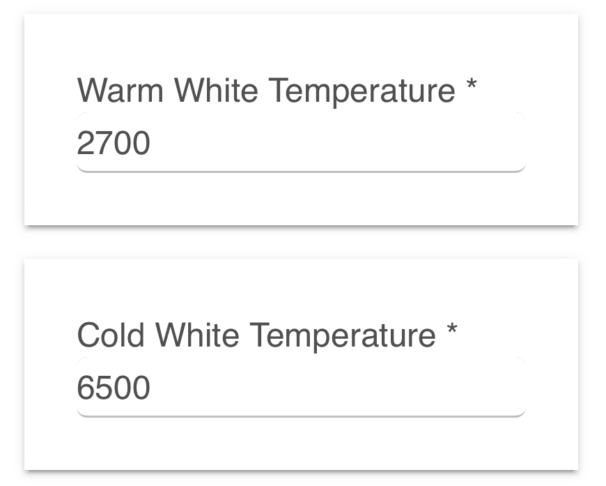

@beddini update pushed.. This will allow you to set the range of your CCT leds
@bcopeland You da man!

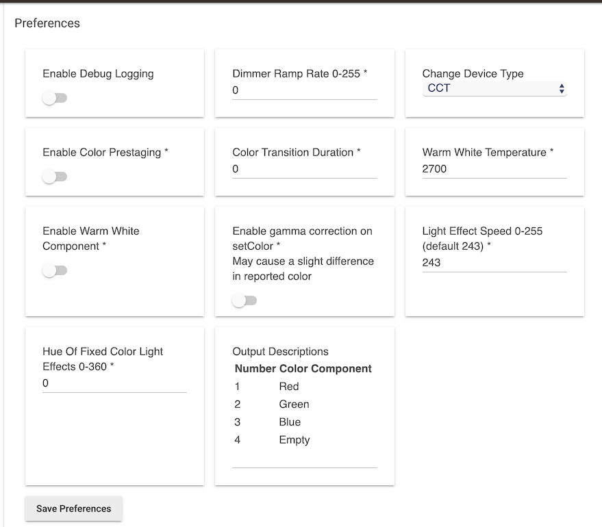

I pulled down the latest, and updated the driver. I could not see any updates to the prefs gui (tried switching between CCT and RGBW a few times). FWIW I double checked your code and could see the new "Cold White Temperature" pref that was conditionally populated for deviceModel == 1 . I modified one of the button names just to make sure I was reading the updated driver, and I can see the change.. just can't see the new cold white temp pref. Any thoughts that's an obvious screen grab above.. so I know its working from your end.

Ok.. Did you select CCT as device type?
can you screenshot your preferences, and device data sections?

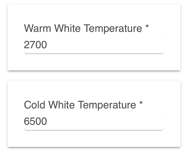

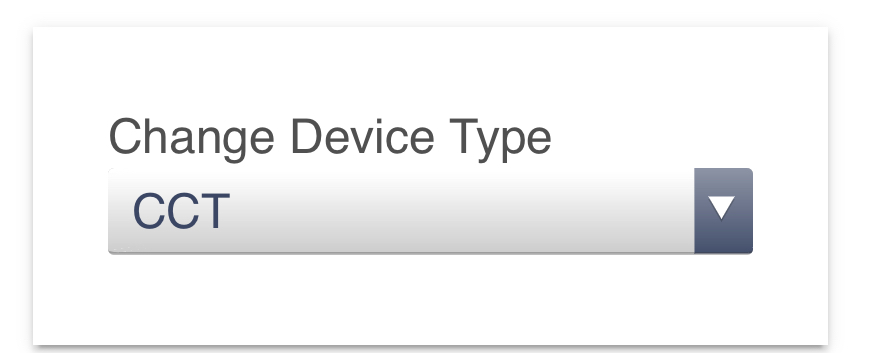

@bcopeland thanks for looking into this..
I've flipped the pulldown between RGBW and CCT and force refreshed the browser several times. No population of the CW field:
Here are the details.. I've only changed the device type name to have a version so you knew you were seeing I got the correct driver installed off GIT:
thanks!!!
FWIW this is the first time I've played with a driver that can switch the pref fields. Should I expect certain fields to go away (like enableGammaCorrect) when I switch from RGBW to CCT? I've never seen the populated fields change when switching between the two Device Types.

Here is your problem..
It won't display those options until the device accepts the change and responds back with the accepted change..
It is only available when the device is in CCT mode
getDataValue("deviceModel") == "1"
Which is z-wave config parameter 4
cmds.add(zwave.configurationV2.configurationSet(parameterNumber: 4, size: 1, scaledConfigurationValue: deviceType.toInteger()))
cmds.add(zwave.configurationV2.configurationGet(parameterNumber: 4))
Yes.. Fields are only available to you that are related to the device type (which is configurable via parameter 4)
