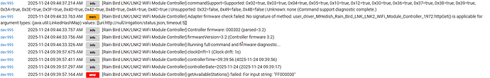

I've been hoping that somone would try to reserect or create a new app. I am going to install it and give it a try.

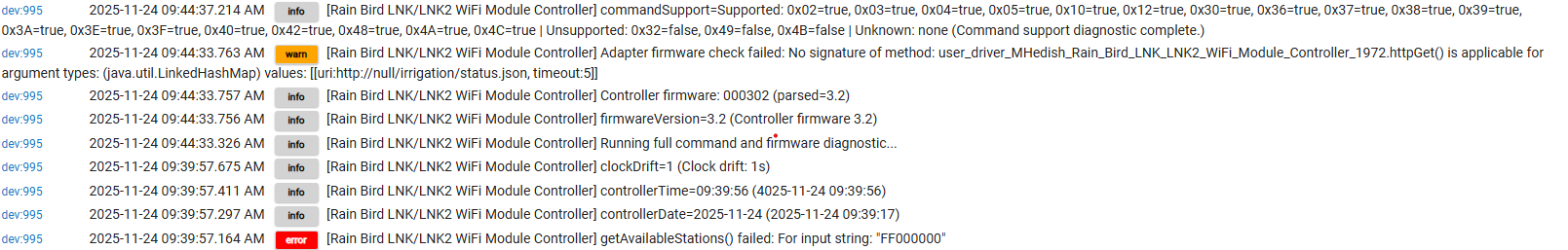

Got a little time today and was able to install and do a little testing. I Executed testAllSupportedCommands and got the following
The warn looks like there is a typo "uri" instead of "url"?

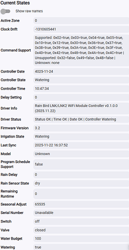

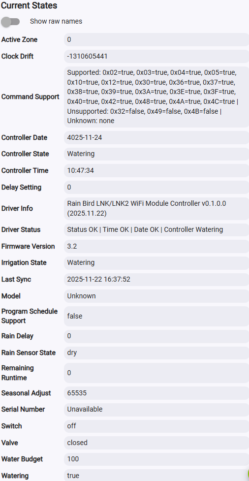

Controller State is showing "Watering" before and after running a zone (tested 1 zone for 1 minute).
That's 1) Hubitat's text, not mine; 2) It's not a "typo" URI (Uniform Resource Identifier) is the broader category for resource identification, a URL (Uniform Resource Locator) is a specfic type within that broader category. :wink:

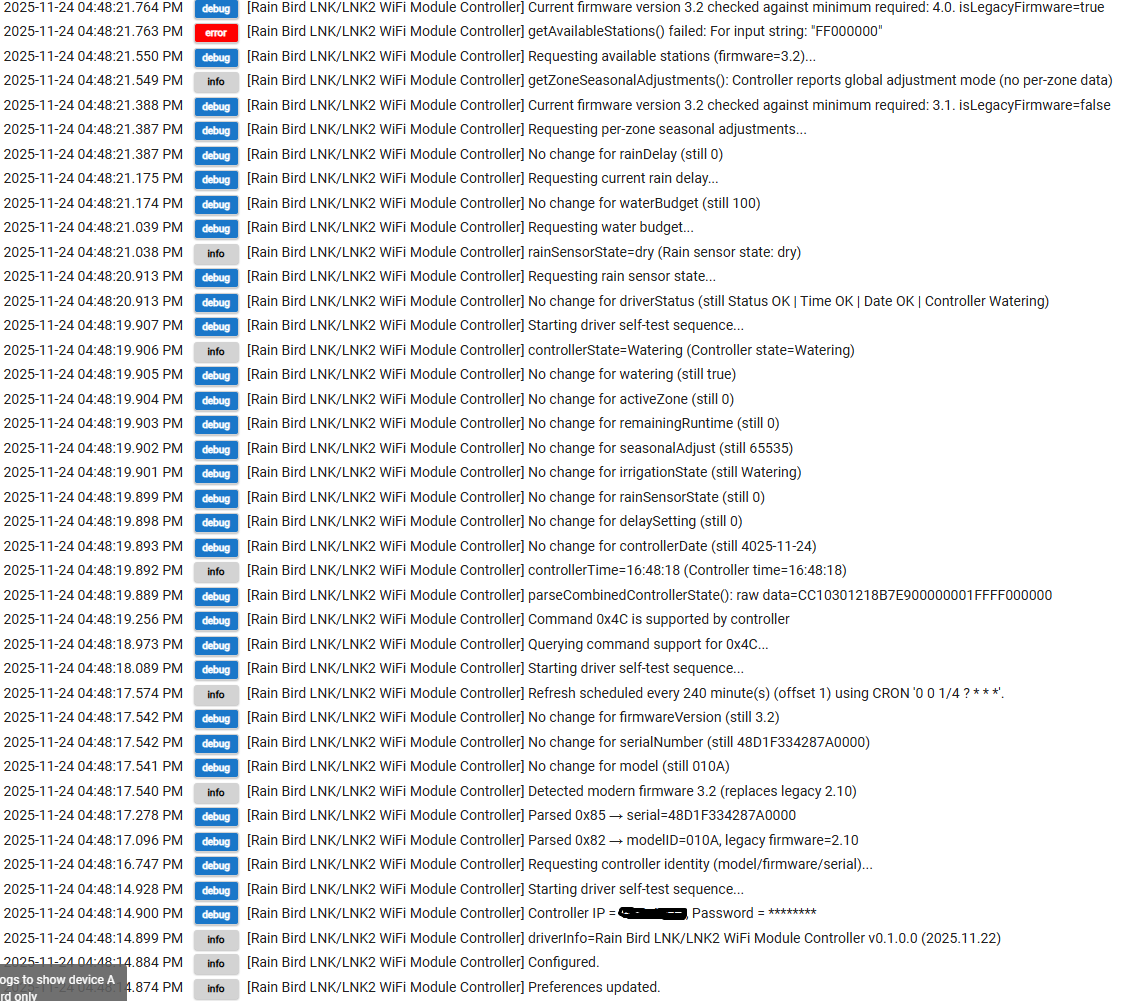

Back to the diags... the command support looks good as does the firmware (3.2). The really odd stuff there is the date/time attributes.
Which model controller is this? I tested against an ESP-me
I learned something today. Thanks.
Mine is an ESP-TM2

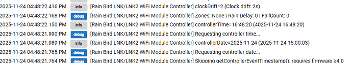

I power cycled it and now it is showing "controllerTime=13:34:25 (13:34:25)", I guess I made it return from the future :rofl:
Progress! The TM2 is a "simpler" controller but looking at the diag you pasted it appears to have all of the opcodes we neeed.
Go ahead and turn on both Enable Debug Logging and Log All Events in preferences. When you click on Save and Close the driver will automatically run a configure() event. That will give us all sorts of info to look at in the debug log.
You should be able run a zone and use stop to cancel everything.

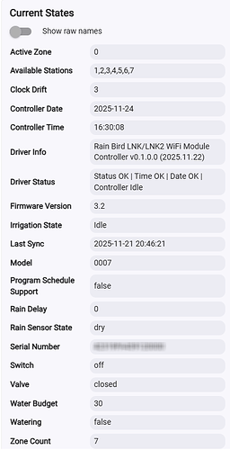

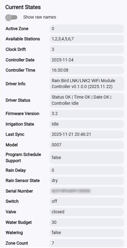

I'm curious to solve the getAvailableStations() error there. Here's what my attributes look like:
Not sure what happened to the last post. Anyway here they are again.
Ran a zone again and stop. Still shows watering
That raw data is helpful. I'll dig in to the opcodes and try to figure it out. It does look like the vast majority of the data, including timesync are working but that "4025" for the year as part of the description for controllerTime is perplexing. controllerDate is reading it right :man_shrugging:t2:
The legacy firmware=2.10 might be a problem. seasonAdjustment shouldn't be all bits on,
When I started working on this, I was surprised at how many changes were made to the firmware that aren't universal.
Thanks for those logs!
I have some good news and some... less than good news.
The good news is I just finished uploading v0.1.0.1 that addresses four of the items I saw in the logs.
  1. Your actual firmware is version 2.10. I didn't have a controller that old so I couldn't test against it. If you look at the debug log, you'll see that line where it says, “Detected modern firmware 3.2 (replaces legacy 2.10). In reality, you do have 2.10. That was from a logic bug that looked for an opcode response and mistook the very old response from checking for 3.x as positive when in fact, it wasn't.
  2. getAvailableStations() will not throw an error on really old firmware. The best that firmware can do is say, “All of them.”
  3. Now that I know what 2.1 firmware looks like, the seasonalAdjust() response of 65535 has been addressed. It'll max out at 100% instead. :wink:
  4. “Watering” has been somewhat addressed. That's the less than good news. Your firmware doesn't accurately report when watering is off. The best I can do is an educated guess.
Firmware ≤ 2.10 never emits updated state telemetry (no valid BF or 3F updates). The best I can do is mitigate that limitation.

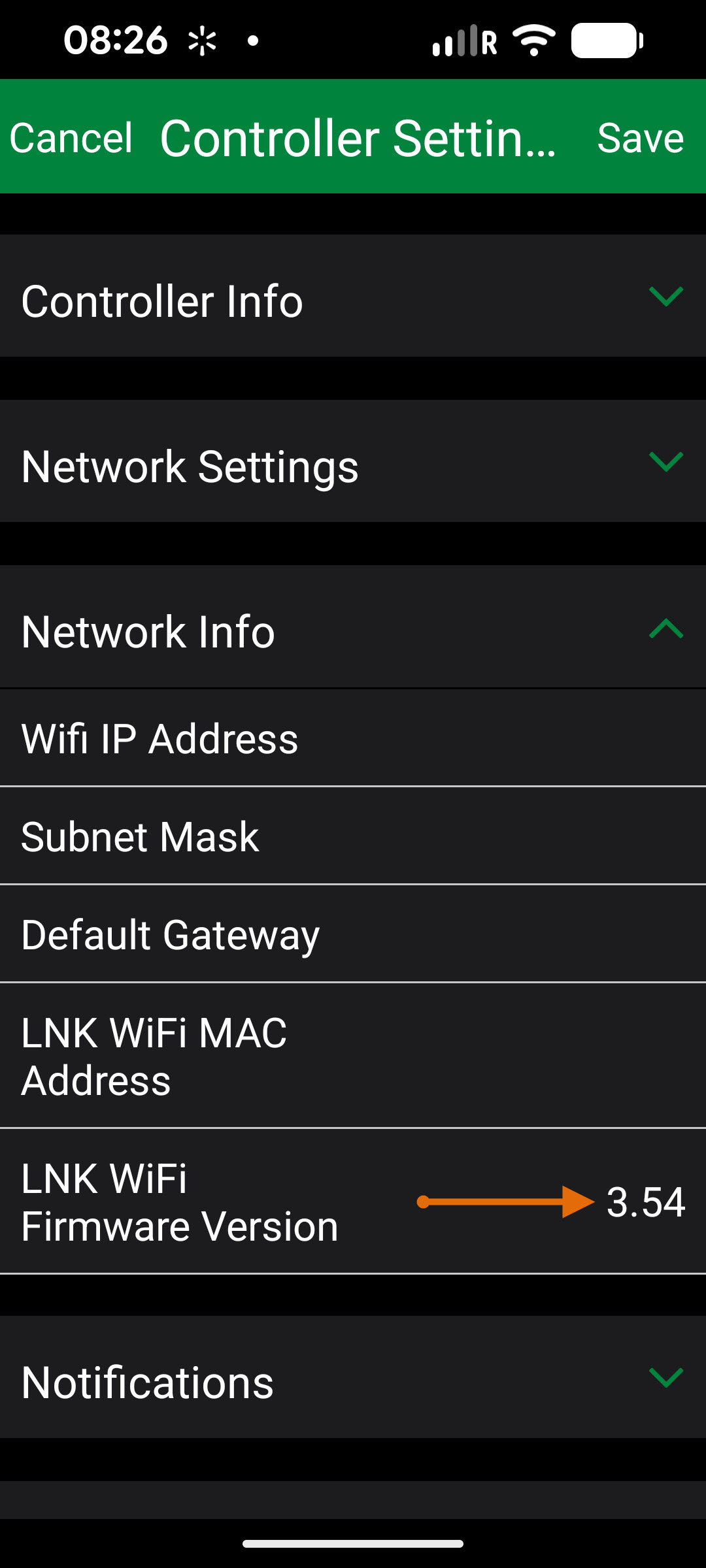

My LNK2 module is firmware 3.54. That's just the Wi-Fi firmware.
I have an ESP-Me controller, which only runs firmware 2.9-3.2.
Unfortunately, the Rain Bird controllers are, from my understanding, not field upgradable, so the only way to get newer firmware (and the associated capabilities) is to buy a new controller. :slightly_frowning_face: The firmware of the LNK/LNK2 doesn't change things.
In your case, that ESP-TM2 is just an old dog that can't learn new tricks. :wink:

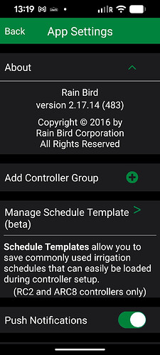

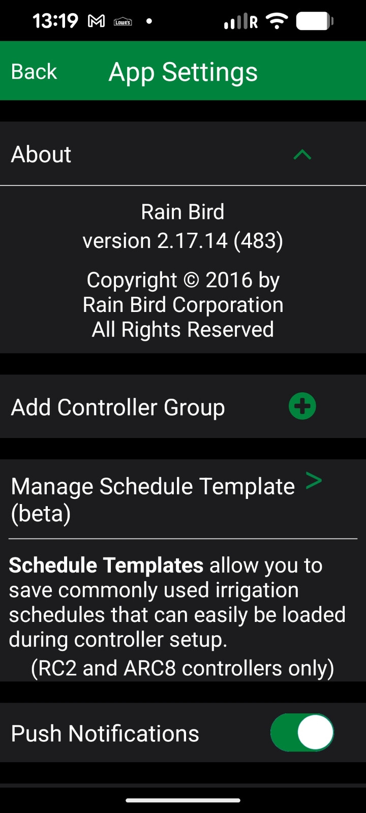

Which mobile app are you using, 1 or 2?
I'm using the original app even though it says its 2.17.14. (White bird, green background).
I haven't seen the need to get the later one and set up yet another cloud account for stuff like this. I'll stick with the direct connection as long as I can.
Ok, that is what I figured. As I was standing in line at the store I realized that the new app is all cloud based including the password. There is no "controller password" like there is in the old app. So I am going to move back to the old app and see what happens.
