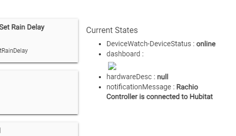

The controller device has the dashboard as an attribute. Did you miss that? Or did you see that and are having trouble adding the attribute to the dashboard? What dashboard?
Yea, I guess I'm still getting the hang of this. I pretty much did both. I missed the dashboard as an attribute and having trouble adding the attribute to the dashboard. Basically, I created a new dashboard and then assigned all the Rachio devices to that dashboard. So, the devices show up, but not a graphic. I may have gone about this all wrong. Not sure.
I do see the graphic / dashboard information now when going to the Rachio controller in DEVICES, but again, can't really grasp how I should be creating the dashboard to bring all the Rachio devices in as well as the graphic / dashboard.
This schedule is a dashboard attributeof the Rachio
Go to your desired dashboard, add a tile, select your rachio device, attribute and select dashboard.
that will show your schedule !
Huzzah! Thanks. I'm such a newbie with this stuff and still trying to put it together. Learning where the syntax fits doesn't come naturally for me I guess. Thanks again.

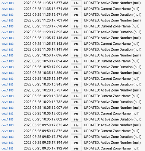

very minor / not important.. I was just looking through the logs and noticed the following entries:
I haven't used the device during this time. Is there a way to suppress these if nothing actually changed?
