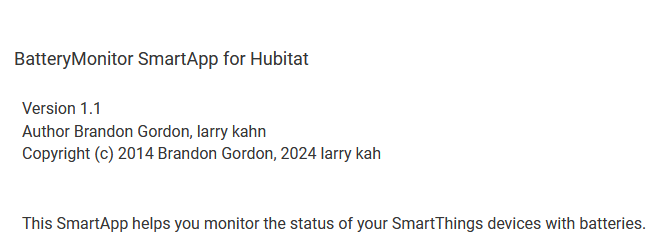

@lpakula - so first off - thanks! Wow. This thread I've tried to keep up with but it was moving amazingly fast - my first effort to implement and relplace the older OT tool I was using - some excellent features - a really impressive app and thank you for that!
I'm glad you peeked - in case you still want to know, regardless of having already Identified the feature request component - I've got 'BatteryMonitor' installed I believed without looking I sourced from HPM.
I always found it nice to get low battery notices on my 'puter window so as I was replacing the older OT tool, I was 'swapping' devices and made my discovery. thanks and keep up the awesome work - I'm grateful.

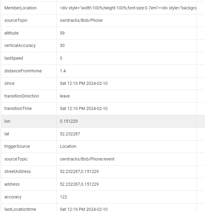

When I move into one of my defined regions I can see in the events for my OT presence device a log of when I enter that region.
When I leave that particular region I can see an entry in the logs for transitionDirection.
This log entry is the same for any region that has been left.
It doesn't actually tell me which region I have actually left.
Is there any way this could be logged.
i.e. when I leave a region it shows either "location - leave Driving Range" or "transitionDirection - leave Driving Range".

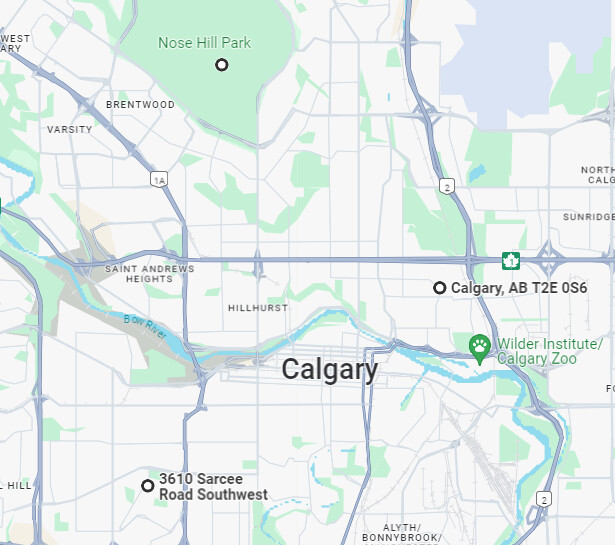

I'm still looking into this. For "free" you can use google maps, and use their directions without routes, but it just leaves "unlabeled" (IE you cannot put a name other than what Google finds in the map) waypoints:
I'll play with using the Google Maps API. That you can images, names, etc, but you need a key for (which is fine), just not "as easy". :slight_smile:

Ok, just checking into what you are looking for. Currently this gets logged as events for each device:
And gets updated when a device enter/leaves a region. Does this work as is, or you looking for something extra?
When I left the 'Driving Range' today I received this series of messages in the device logs.
Summary
As you can see I get a transitionDirection of 'leave' as I exit that region.
This message is the same for whatever region you happen to leave.
What I was wondering was could there be a message that indicates the particular region that has been left.

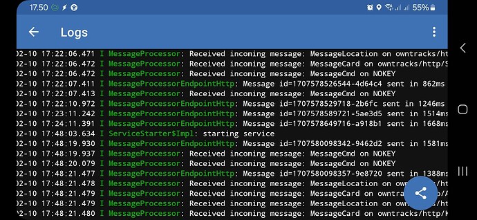

Owntracks app log, there is no errors but between 17.24 and 17.48 there is nothing. When I opened owntracks app and hit arrow key log says: "Starting service". Do not know if that is normal message while app should be running background. Phone has not been restarted or any other things..

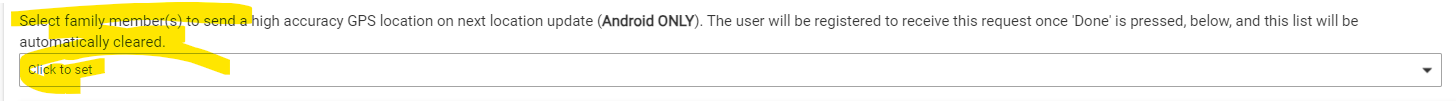

If I have this already enabled
If I manually add members to this menu and hit "done"..does it swipe off the upper setting? Most likely you have thought this through but that is the only thing I have been manually hitting lately and started to wonder if that disables higher accuracy always on setting.

If the phone isn't moving, that would be normal. The "ping" message is on ~30 minute interval which would explain the 17.48 message.
It seems to report that when you open the app. Seems the service restarts, which is normal.
When the the service restarts, it has no location, so it posts that log entry (fully normal). It's only an issue if it every location out (IE on those 30 minute ping intervals, or when moving) report this. The HE app requests a higher accuracy update on those 30 minute intervals which has been preventing this issue from occuring.
No it does not. I could hide that box if the slider is set. The box becomes redundant.
I pushed a version which will enabled some better logging for the devices. It also removes that "Select Family member(s) to receive high accuracy GPS...." box since it's been replaced behind the scenes with automatic maintenance, and was redundant.

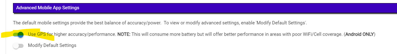

Noted additions is it will tell you if the the phone is connected to home wifi, if it's using a high accuracy GPS fix (this should happen automatically in the region bubble outside your home region) and if you use the forked APK from post #2, you may see a "Ignoring Bad Location" at the end of each log entry if the location was outside the acceptable accuracy (those don't get used for presence, just as a keep alive).
If you are not using the "Use GPS for higher accuracy.." you should see:
  • The High Accuracy be false at home
  • Once you leave the home radius, High Accuracy be true. Locations should come more frequently when moving.
  • Once you move past the high accuracy region amount, High Accuracy be false, and locations should slow to every 60-seconds (if using the default settings) when moving.
