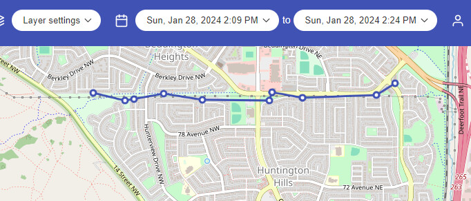

Ah, thanks for that. I see the breadcrumbs... I assume there's no option to say, filter by date, to only show the crumbs left on Mon 23rd Jan, for example.
You'd need to install the OwnTracks Frontend as well. That allows you to filter down to the minute:

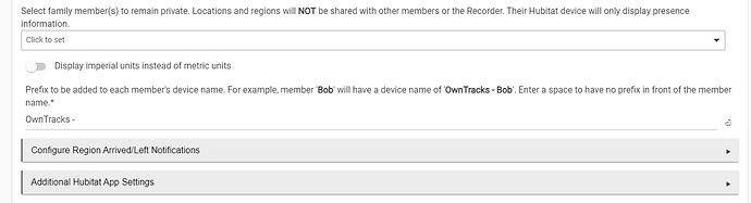

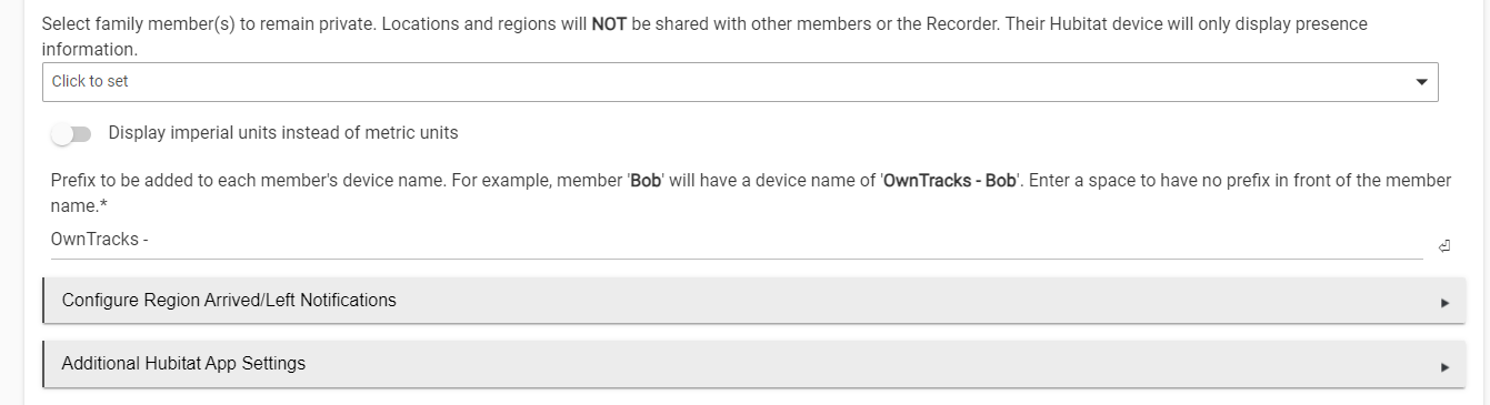

Did a minor release that allows you to change the device name prefix from "OwnTracks -" to whatever you'd like. Enter a single space in the box if you don't want any prefix's.

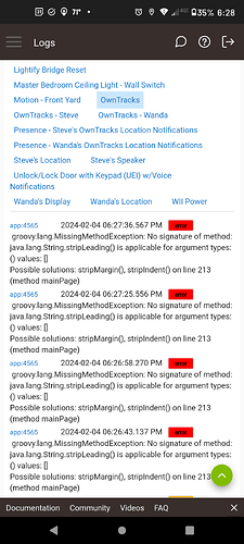

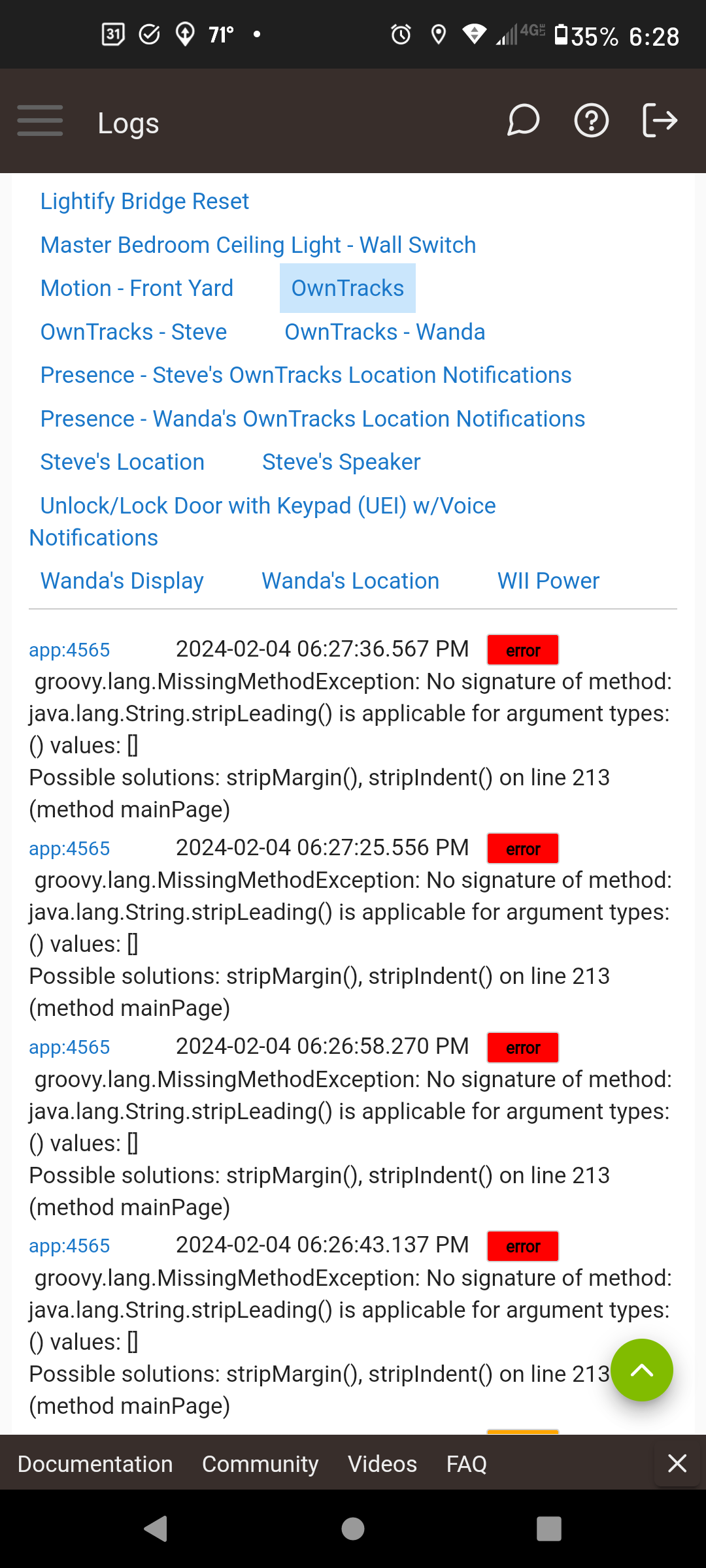

Error: No signature of method: java.lang.String.stripLeading() is applicable for argument types: () values: [] Possible solutions: stripMargin(), stripIndent()
Oh shoot.. Give me a second....
Can you try to update again? Should be fixed.
C5 doesn't catch those errors.... sigh.
Nope same error. I think its stuck since I had already attempted to used the new option to omit the 'Owntracks - ' prefix for existing devices.

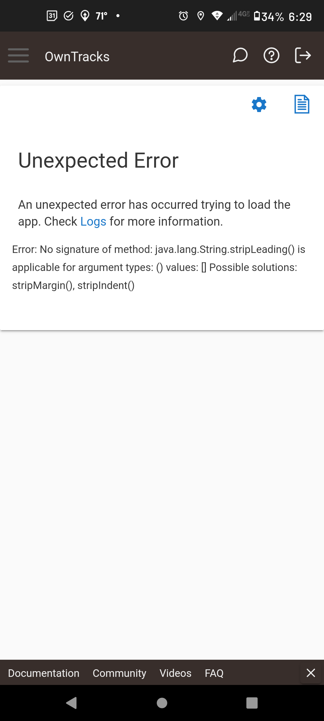

I managed to crash the HE app and can't get back in. I'm getting an unexpected error trying to access it.
I entered configure regions, did nothing, and pressed Next (the button on the bottom right if it's not next) and that's all she wrote.
I can reinstall but would rather not if I don't have to.
