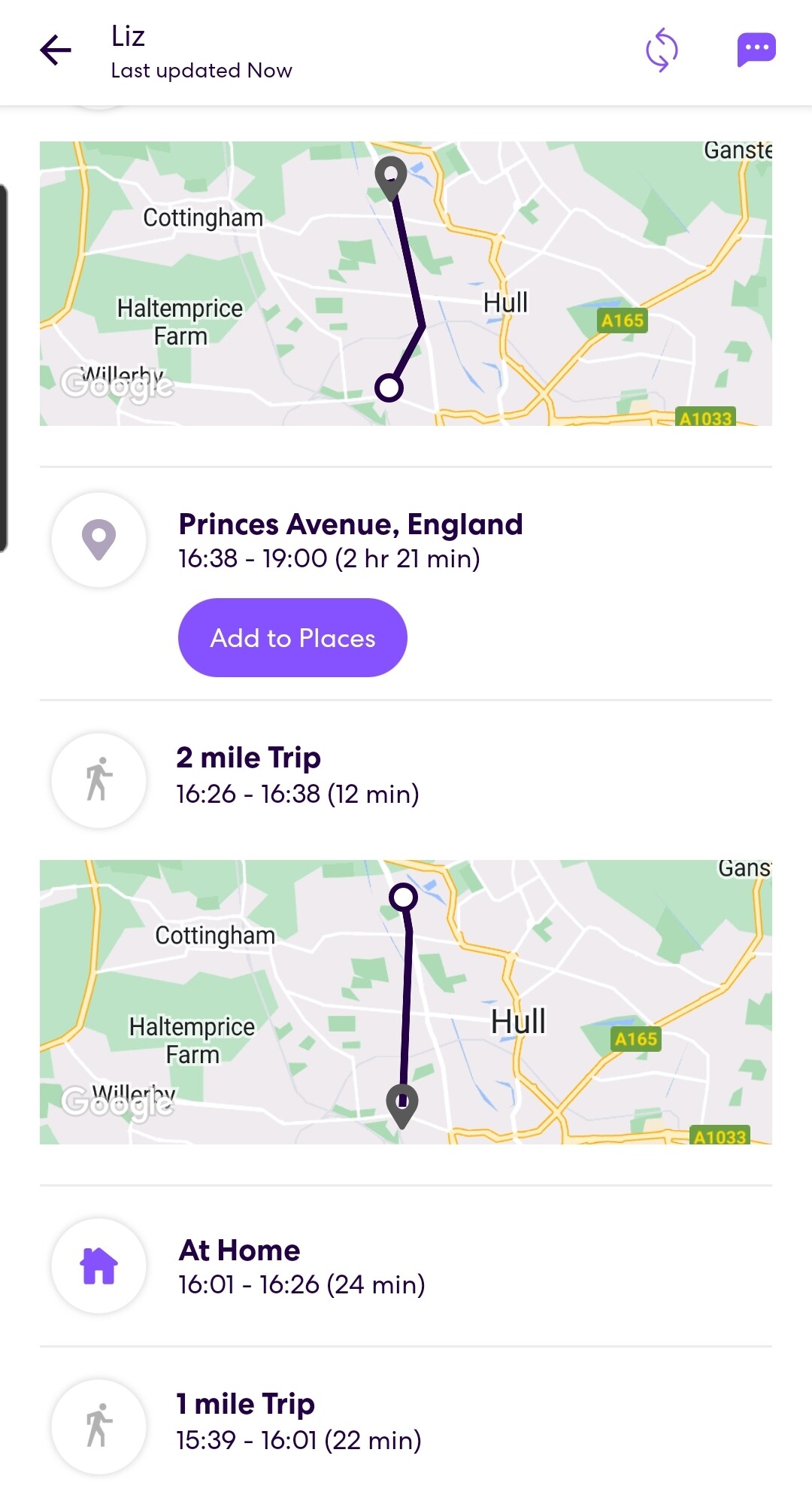

At the moment I'm presuming the 'history' features require the installation of docker/recorder, which is beyond me. Also, I'm not sure if it's worth the effort as it's difficult to find an actual video (or similar) to show how this works in practice if I do actually get around to installing this.
Again, a presumption, but I suspect the recorder won't allow this kind of functionality to be restored from Life360..?

You didn't clarify the answer to this above. Which functionality are you looking for? You cannot get any history from Life360 into the app. Are you looking for the breakdown of segments over time that Life360 did? Owntracks will give you a breadcrumb of points that you can click to see when the person was at each point, but doesn't break it down into blocks (IE 1 mile trip).

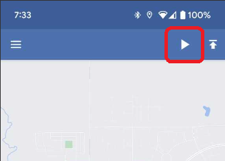

Oh wait, on your mobile app, what is displayed in the top right of the map? Does it have the "Play" symbol like the image below? @Noob_using_hubitat @s1godfrey can you check the iPhones that are having location issues? It's super easy to tap that icon and switch it to a manual or quiet mode which stops reporting locations. It's the reason I blocked it in the forked version I put on post #2. Worst location for that selection right next to the send location button IMO.
I do have a play button in my app because its a play store version. If I remember right in your app version that is disabled.

That triangle icon will change if you tap it. It will change from "Move -> Significant -> Manual -> Quiet". "Significant" mode is the single triangle like in the picture I posted.
