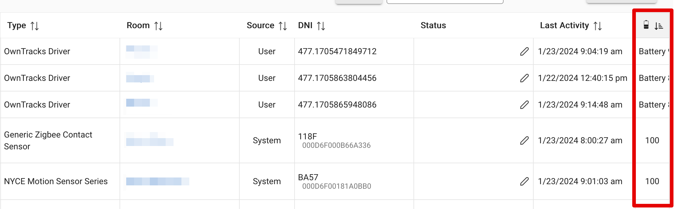

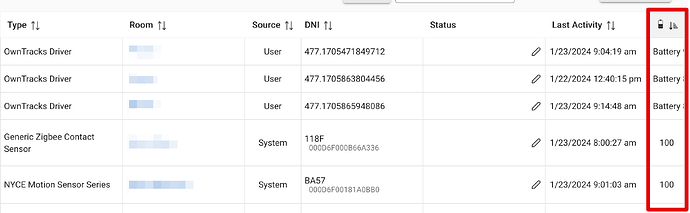

Re battery status, I noticed the Devices table in Hubitat doesn't display it correctly.
@lpakula
I think it's because the "Battery" attribute has the "Battery" label in it, rather than just the percentage.
2024-01-23 07_23_26-Hubs, Network, & Tech
So the new Battery field on the Devices tab is showing the label and the % and the % gets cut off...If the display option for "battery" attribute was changed to show just the number (like "batteryPercent" currently does) then it will display as expected on the Devices tab.

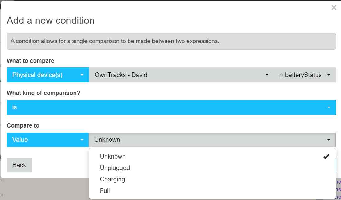

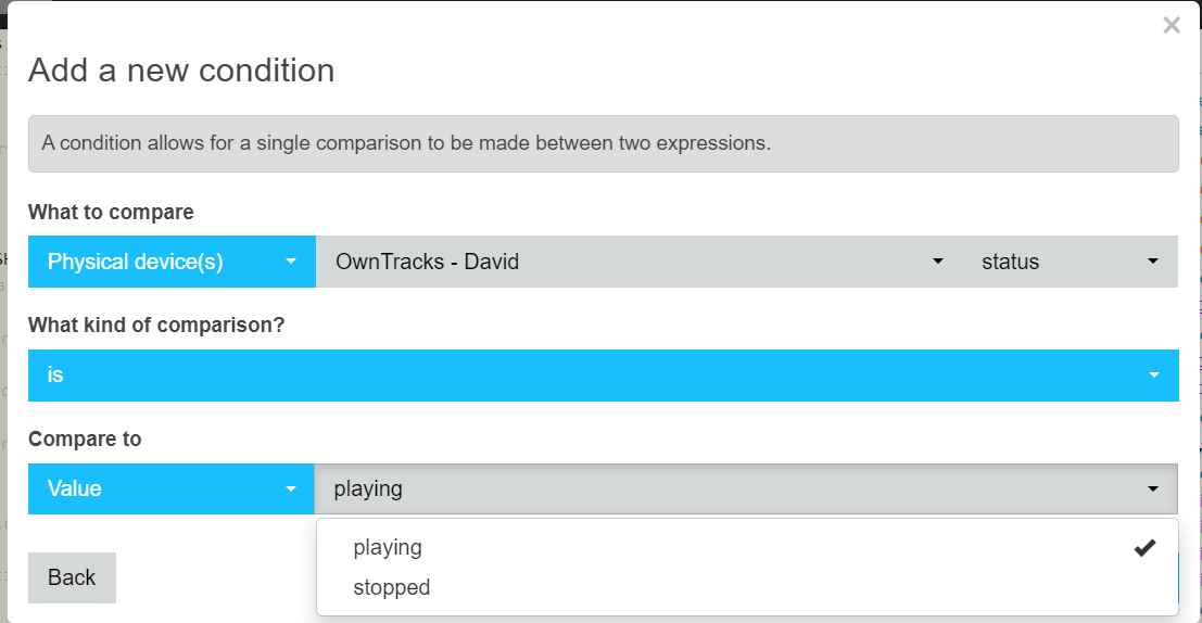

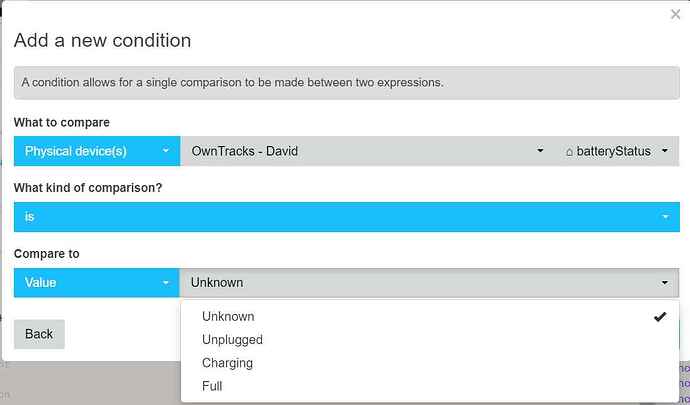

For instance, the "battery status" state shows a predefined status like "Battery Status: Full or Charging or Unplugged," and conditions can be set up in Webcore to trigger events based on this predefined status selection (refer to the attached screenshot).

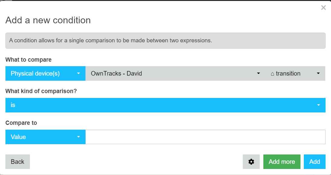

Similarly, the "transitions" state displays dynamic data, indicating entries and exits from a region. In Webcore, conditions can be created based on this dynamic data, which needs to be defined manually input by the Webcore user as they are more dynamic (see attached screenshot).

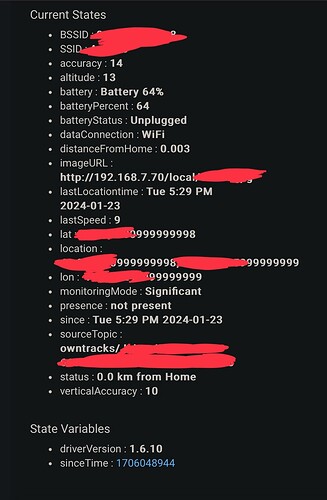

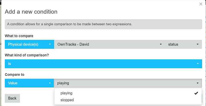

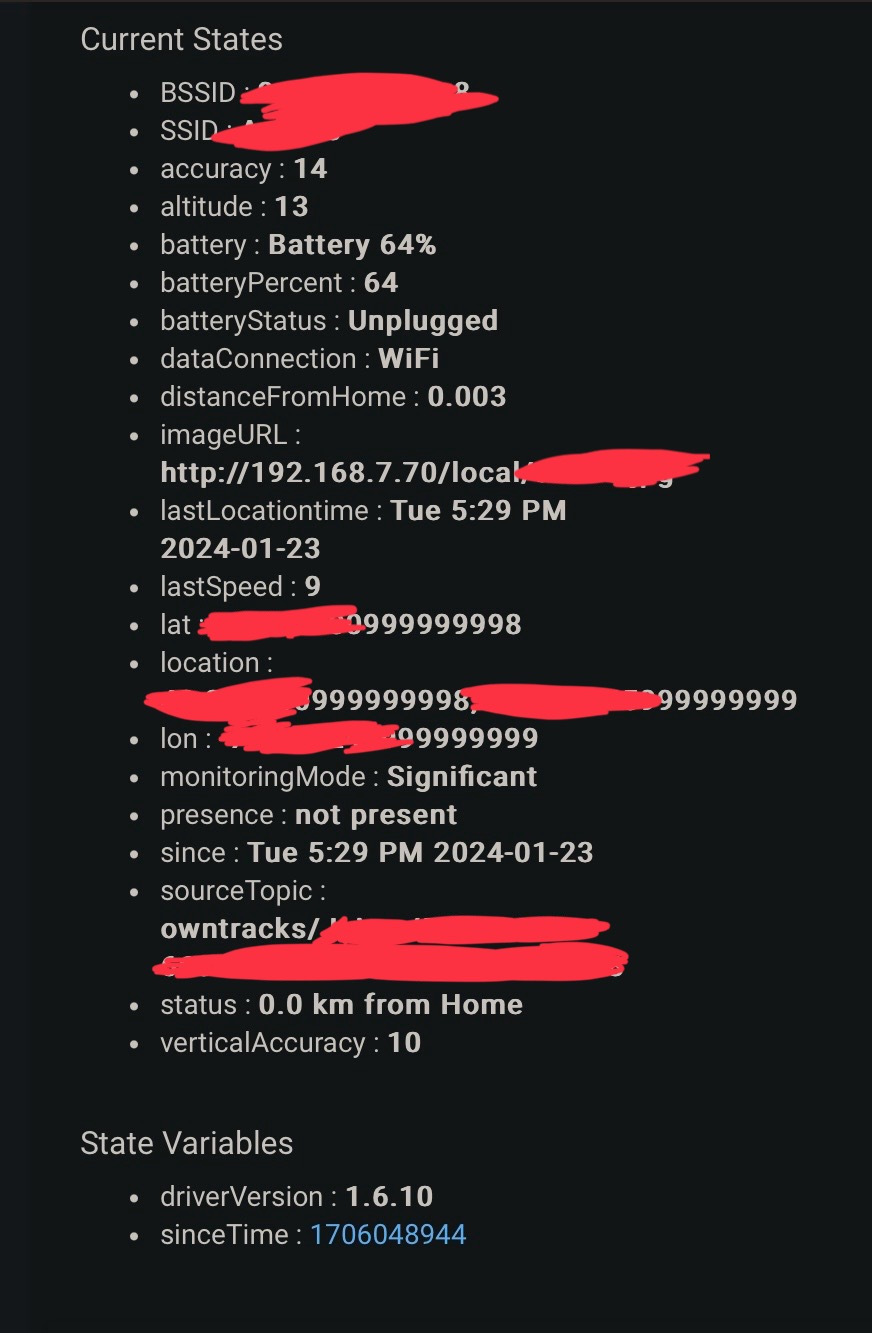

However, the challenge lies with the "status" state. It displays dynamic information such as route names, lat/long, or future addresses, similar to the "transitions" state. Currently, it appears to show unrelated data in Webcore, and I believe it should be more aligned with the dynamic nature of the "transitions" state (refer to the attached screenshot).

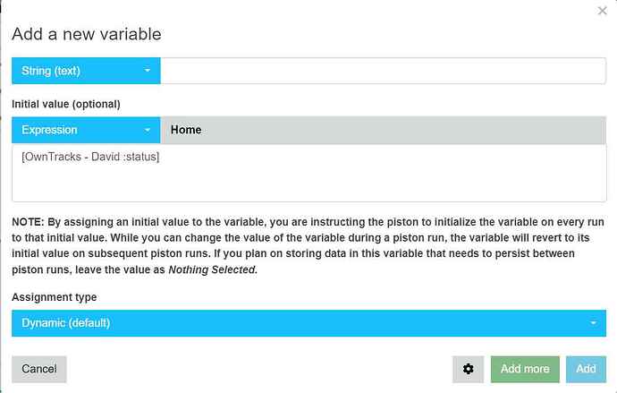

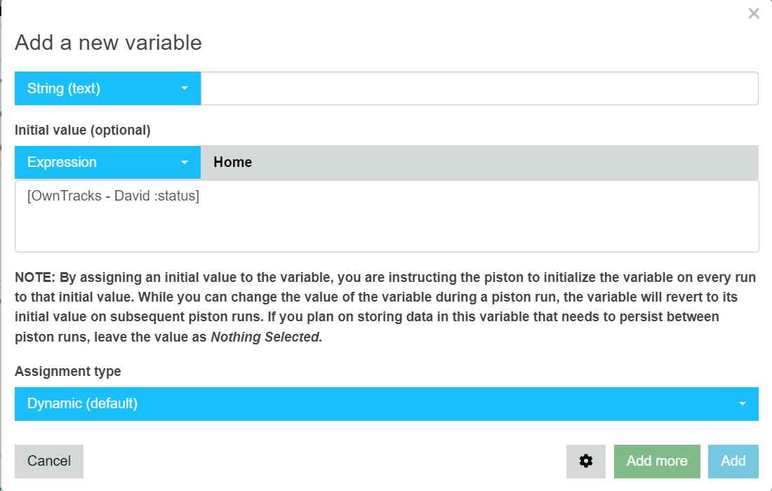

I've checked the custom attribute list, and unfortunately, "status" is not listed there. I suspect there might be a configuration issue causing this discrepancy. To confirm, when I write a Webcore expression, the response is correct (refer to the attached screenshot).

In a nutshell, why is the "status" displaying any information, let alone showing "Play" or "Stop"? Ideally, should it not function similarly to "transition," "lat," or "lon." Is there a specific reason behind this behavior?

Yup, I see what you mean. Let me get that switched to just a number.
I'll take a look at see. Status is nothing more than a text field right now. I suspect Webcore is expecting it to match a playable device, hence the play/stop?
I'll check the support driver capabilities. I might not have exposed enough to be readily consumable (but they should be pullable from the extend attribute boxes)

Ok, I looked more, and no clue why WebCore is doing this (saying it's a WebCore issue. :slight_smile: ) If I click on the Hubitat Rule Machine, make a rule and try to trigger on a custom attribute called 'status' from the OwnTracks driver, then it allows me to filter on an text I like. Maybe Webcore is assuming a 'status' attribute is a field from a media playback device? Using 'status' as an attribute is 99% random. The 1% was matching it to Life360+. If there is a better name for this, it can be changed if it's breaking WebCore.
For me, it's purely an information field when I look at a user. What it is labeled doesn't matter to me! :sunglasses:

  • @jbaruch The driver will just display the battery % number (after you upgrade, you need to get a location update from the each member to change the field).

webCoRE is currently having the built in definition of status variable (from HE capability docs) override the custom use of status in the driver for the enum values. Likely should be addressed for cases where the driver overrides this.
  • the workaround you show with expression should be fine
  • fix is more complex than it seems, as webCoRE has device variables, so the IDE does not know what device you are working with when indirected via the variable. This is why things are hard when folks decide to override built-in attribute definitions....
