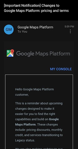

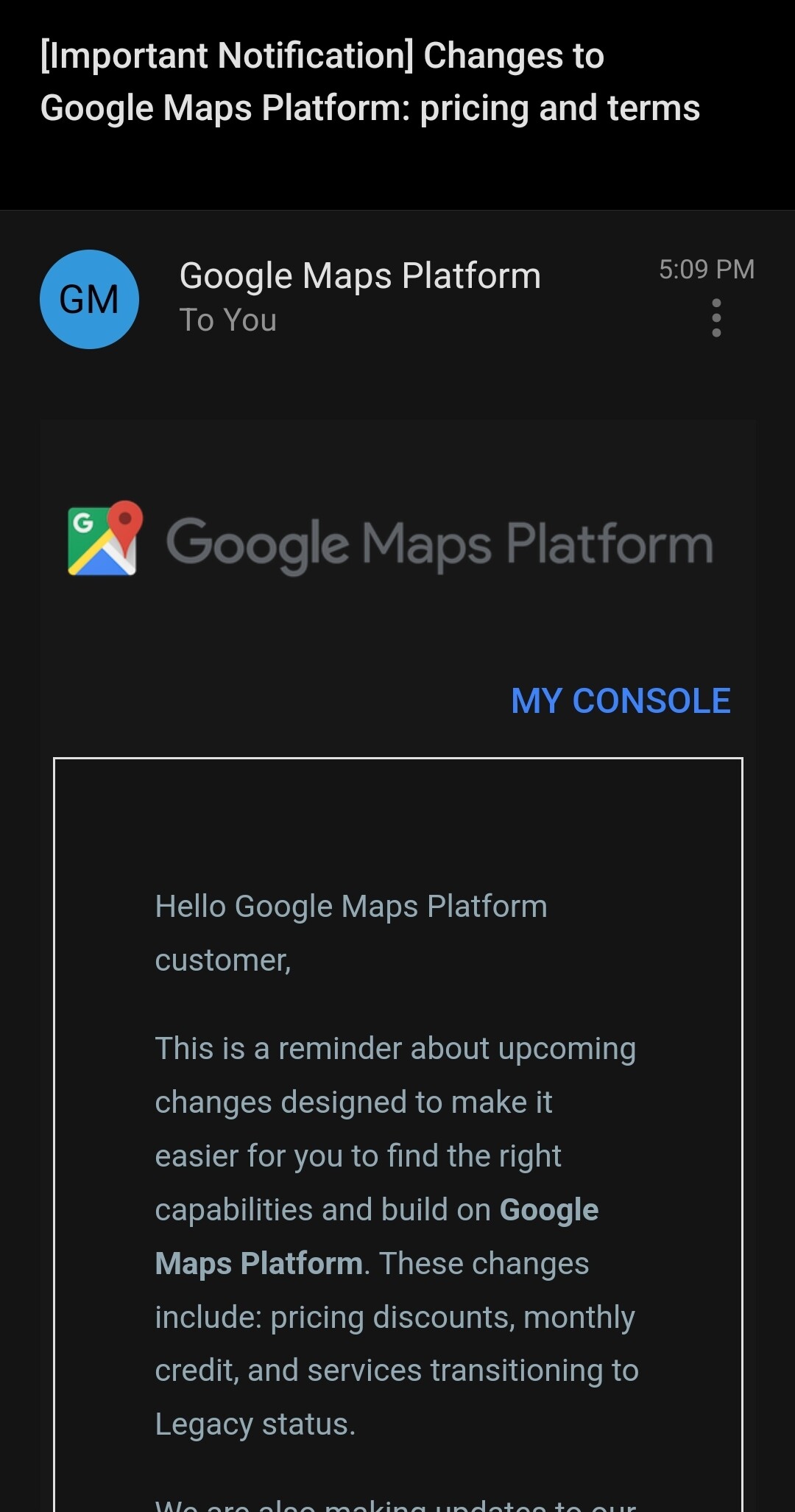

Here we go again... Do the new terms and conditions need with our Owntracks toy?
  • Monthly credit changes: We are modifying the current USD $200 monthly recurring credit by offering a free* monthly usage threshold for each Core Services SKU based on its category (Essentials, Pro, and Enterprise).
    *Free usage refers to monthly billable events available at no cost.
Essentials: Lets you integrate the best of Google Maps into your applications with 10,000 free monthly billable events2 for most Essentials Core Services SKUs. Ready-to-integrate APIs & SDKs help you quickly get started with essential capabilities for key use cases and scale easily, backed by our global infrastructure
Seems like we'll be ok (i.e., free).
It's a reminder of what they sent out in late last year. OwnTracks app 1.8.7 or newer drops the limits to match their new free terms.
We should be all good! :+1:
Ah, they fooled me, thought it was another change on top of the previous one.

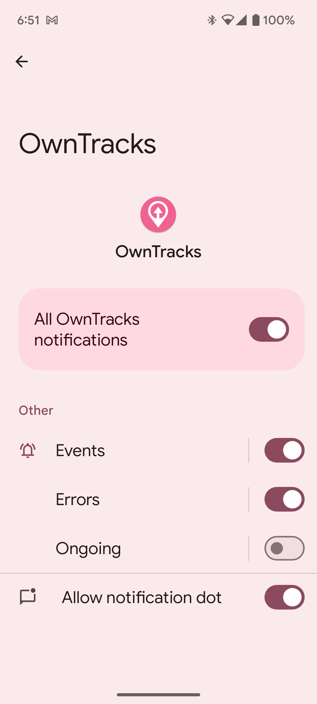

@lpakula Today I noticed that one of my Android phones monitoring mode is set to "Move" instead of "Sifnificant" as all the others are set.
Since the button is disabled in V 2.5.6 (see shot below) I don't neither know how this setting was set to move nor am I sure what's the difference between "Move" and "Significant".
Is there a way to switch to "Significant" even if the button is disabled?
If you are using my forked version, I disable it on the map view. But you could still do it through the notification banner if you have left that active. I disable the OwnTracks "ongoing notification" so that it doesn't display in the banner.
In move mode, the app will just call home on a periodic interval, regardless of movement. It just consumes unnecessary data, so that is why significant mode is recommended. That mode only reports a location update if you moved a distance in a period of time.
Thanks for the explanation and the hint with the notification banner. I was able to change it.
I wasn't sure if I could disable the notifications entirely without any impact on the reliability of the monitoring. Currently I only silenced and minimized the Owntracks notification.
If you disable "Ongoing" notifications, it just impacts it showing in the banner, with no other location effects:
