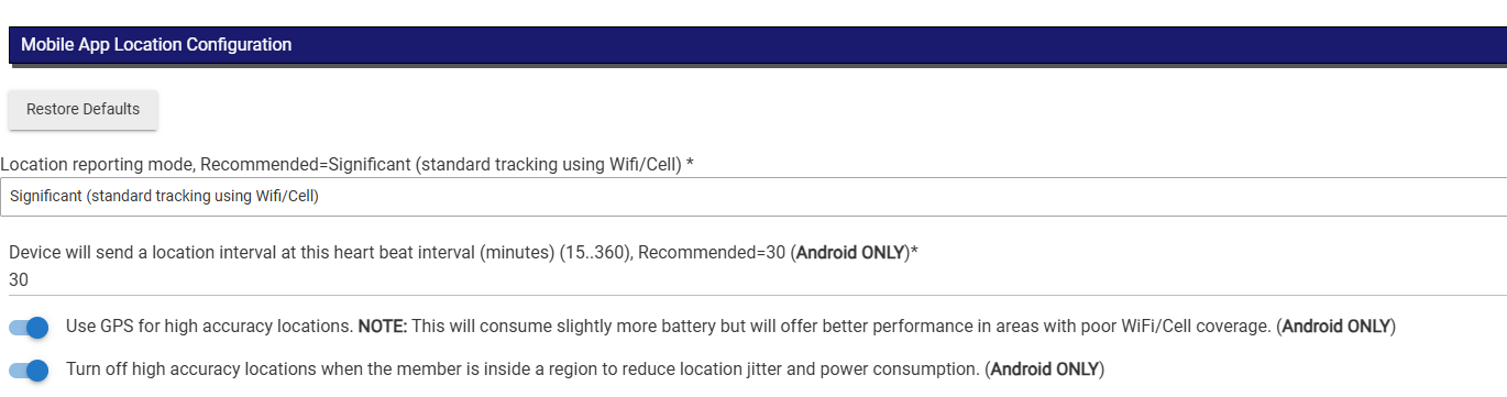

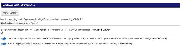

Are you using the GPS for locations?
Google screwed up their fused location service back in Sept (they seemed to acknowledge an issue, and have been quiet about it). If don't enable the GPS slider, then it wants to use wifi to reduce battery consumption. The issue is since their Sept update, they don't seem to be using wifi, so you get no locations.
I only had the 2nd option for 'turn off' enabled. I just changed use GPS to enabled. THANKS

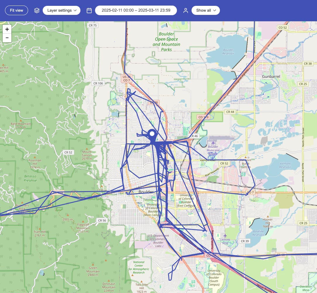

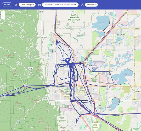

I had to change my phone from Samsung s23 to Samsung s25 and noticed that my location started to jump. I mean suddenly I'm 3,3km away from home even though I'm sitting at my home sofa. There seems to be no logic or reason why it happens. This seems to be first Samsung that does it. My son used to have oneplus phone and it did exactly the same thing.
Hopefully Samsung updates "something" and I surely hope that it fixes this issue. Meanwhile.. there is probably nothing that would help me with this issue right?

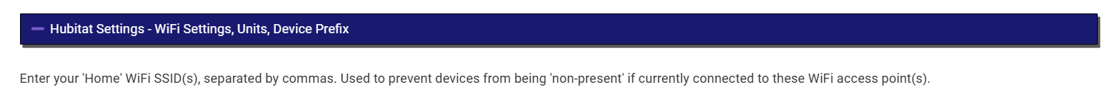

Setting the Home Wi-Fi settings should help w/jumpiness...
Yep, it should but it doesn't :frowning:
It still shows SSID as connected but the location is way off..

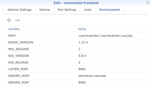

FYI: For those folks who are trying to run Owntracks Recorder and Frontend in Docker on Synology NAS DSM 6.x ...
I'm a Docker noob and chose not to use Portainer because I've been flummoxed by it before; instead, I used the native Synology Docker app's control panels to get the Recorder and Frontend set up. Owntracks Recorder and its web page came up quite easily but I had to bang on it for a day trying to get the Frontend to serve a map at all.
Once the Frontend web map was alive I still had what appeared to be issues getting the Frontend in one container to GET the data from the Recorder in the other container. Being a noob I did not have a clear concept of server names vs container names and how processes in different containers can communicate, so I was trusting that I had the the environment variables specifying the ports and server names correctly set up.
Unfortunately setting those environment variables was necessary but not sufficient, and I was still getting weird errors in the Frontend log
[error] 10#10: *14 connect() failed (111: Connection refused) while connecting to upstream, client: 172.17.0.1, server:, request: "GET /api/0/list HTTP/1.1", U..
[error] 10#10: *14 rewrite or internal redirection cycle while internally redirecting to "/config/config.js/index.html/index.html/index.html/index.html/index.ht..
[emerg] 9#9: host not found in upstream "owntracks-recorder: 8083" in /etc/nginx/nginx.conf:7

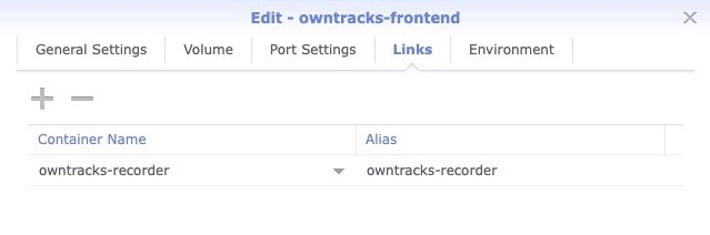

As it turns out, there was one of the Docker settings panes that I had ignored: the Links pane, which maps external containers to hostnames that can be referenced by the container being set up. Linking the Recorder container name 'owntracks-recorder' to the exact same-named alias 'owntracks-recorder' referenced by the Frontend turned out to be the key to making the data connection between the two processes in these two containers.
Along the way I also spun my wheels creating a Frontend /config directory, mapping it to a path in the Frontend container and populating it with a config.js that I found elsewhere in this thread, but in the end that config file was not even necessary to get the two processes talking to each other and the Frontend's defaults were sufficient to create a perfectly functional map.
