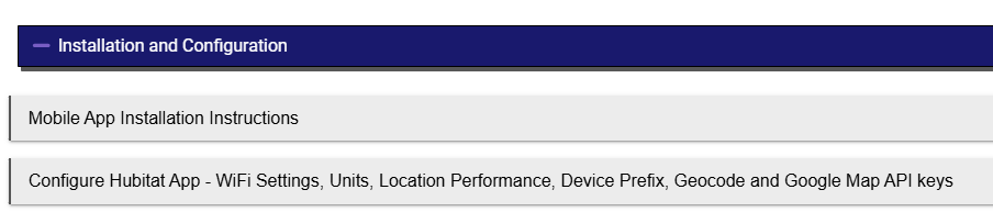

Is there a setting somewhere to turn on Family Maps? Searching on the App page, "Family" only appears 4 times:
Noted! I'll take a look at this.
If you click "Configure Hubitat":

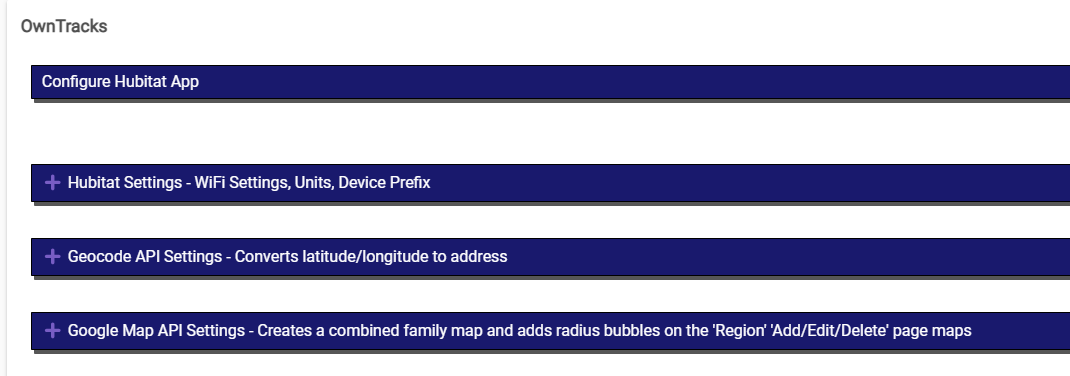

The last entry is for the Google Map. You need to follow the directions to add the API key on that page:
And then you get the link exposed that you are looking for:
The family map does exactly what you are looking for. Shows everyone in OwnTracks on one map, shows their past history, etc (basically does a lot of what Life360 did on their mobile app).
