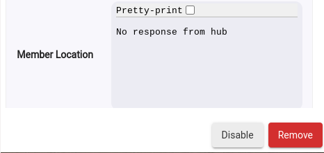

I have to admit, that I haven't read all the latest postings. After upgrading to 2.4.0.144 I noticed that the Member location in the OwnTracks app (same in HD+, included as HTML) works very unreliable and slow. I see very often the following
Is this related to the issues described above?
Thanks.
Yes, the issue is coming from a problem in .139-.144 of the Hub Beta Firmware. Use the diagnostic tool and roll back to .138 to fix this until it gets addressed in the new hub software.

It will work fine until you have a phone reporting more than 300 updates per hour. That is when the error occurs, and and the phone gets backed up with locations.

Beta testers who have applied each iteration cannot roll back to .138 as far as I know.
Is it possible to roll back to a 2.3.9.xxx backup which I stored before the update to 2.4.0.144 or ist that a bad idea, giving me more problems?
I rolled back to 2.3.9.201 and it is working again and everything else seems fine since the rollback also. I used the diagnostic page to roll-back.

Go ahead and roll back. You shouldn't have any issues.

Oh sorry, I didn't realize that the newer version was public facing. Basically 2.4.0.139-2.4.0.144 are currently effected.
