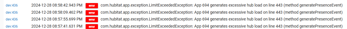

I rebooted on .138 and Now I get a present:
dev:21382024-12-28 13:52:37.024errorcom.hubitat.app.exception.LimitExceededException: App 1633 generates excessive hub load on line 443 (method generatePresenceEvent)
dev:21422024-12-28 13:48:12.296errorcom.hubitat.app.exception.LimitExceededException: App 1633 generates excessive hub load on line 443 (method generatePresenceEvent)
app:17632024-12-28 13:26:33.242warn ║ Hub Event! Device: HomeC8 - Severe hub CPU load detected - Sat, Dec 28 2024 @ 1:26:33 PM PST

I updated my C7 today to 2.4.0.144 and on my latest trip shortly after I am receiving this error on my 3 phones devices using OT. Hubitat is not recognizing that I am home.
Yes. You have to revert to 138 if you're a beta tester. This is the last know working version until a fix is in place.
