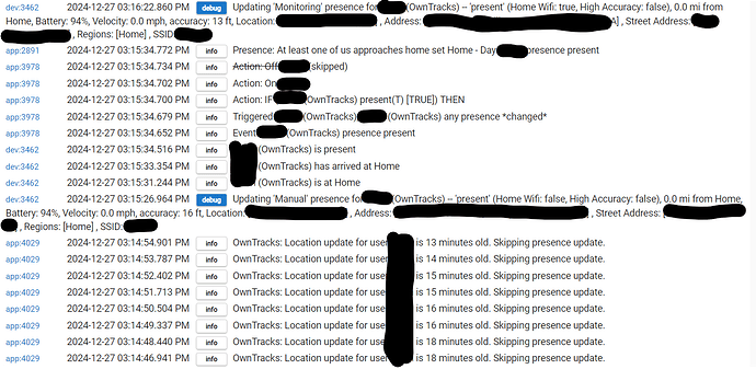

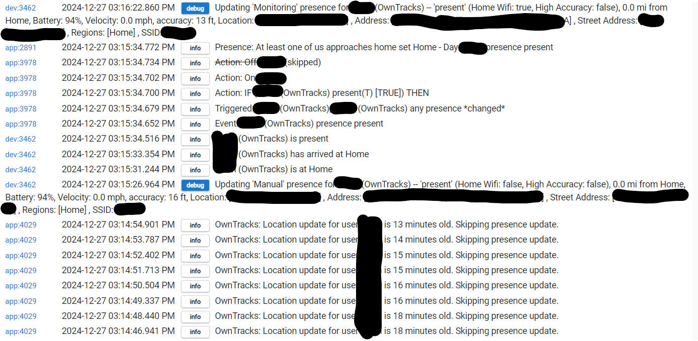

It isn't clear to me that we are all talking about the same issue. I'm not getting and errors in the log but location updates have been very sluggish (15-90 minutes behind, I might guess).

OK, thanks. That's the symptom I'm seeing as well. My geofence is about a 1 mile radius so it has us home well before (several minutes) before we actually get here. Lately, we've beat it home every time and observed it finally notices we are home 15 minutes or more later.

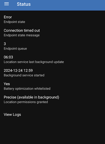

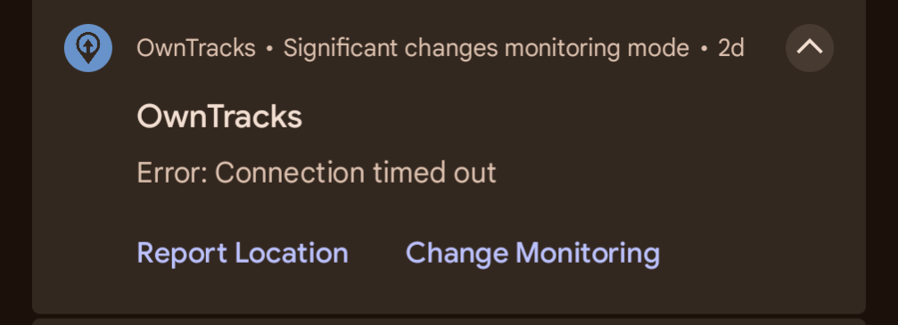

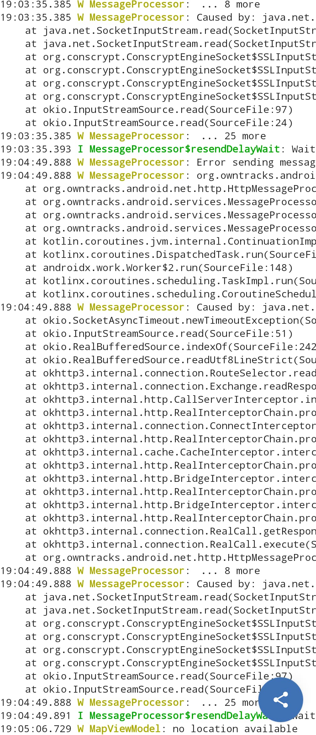

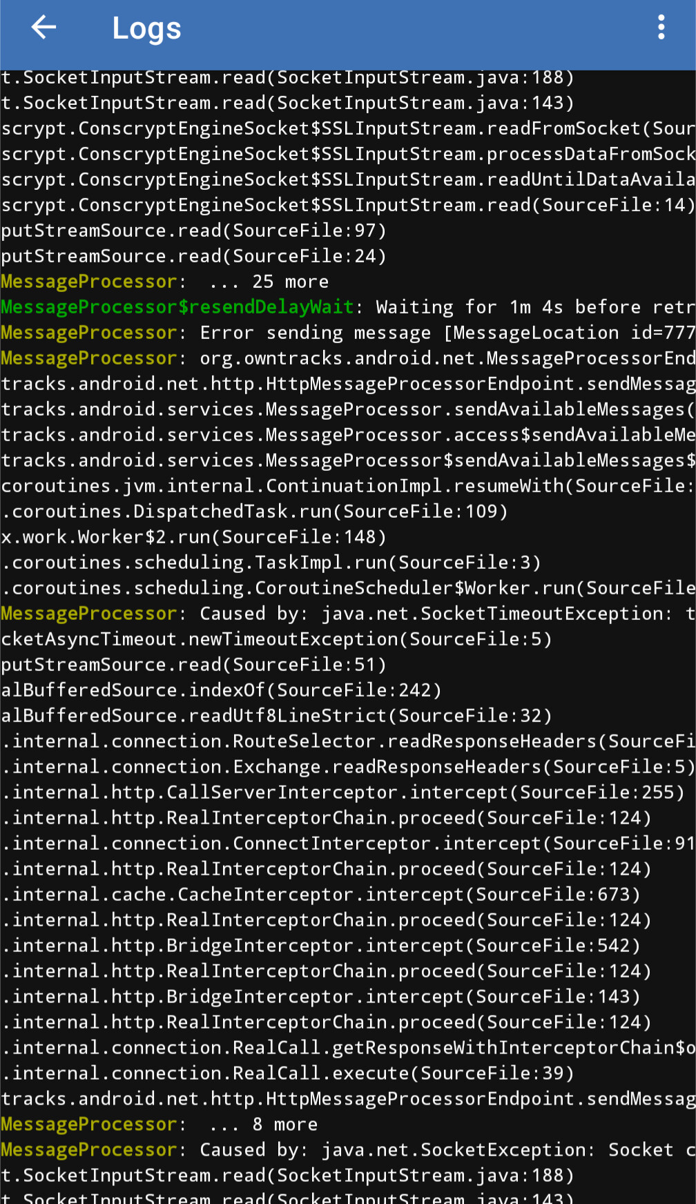

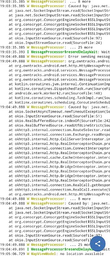

I just updated 144, and I'm still seeing the errors.
No errors here but location reporting is definitely messed up. I hadn't seen it previously but I watched my bride make a 40 mile drive in and out of a couple of regions and there is something messed up. I am thinking of going back to 2.3.9 until this is resolved.

I don't know if any further debugging is needed from us, but just in case. Spousal unit and I were away and came back about 2:55 pm. About 15-20 minutes later, neither had posted an event within the geofence. I went into the OwnTracks mobile app and forced an update. That seemed to open a floodgate (for me).
