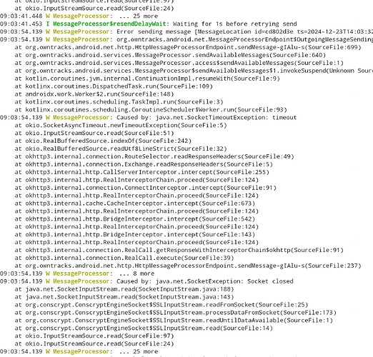

I have been seeing issues Owntracks lately I have everything. I use DNS Adguard and some other stuff I have for security and I can not seem to get this working consistently.
I have getting in my logs android. Although iOS devices are having issues too.

I don't know where to go from here.
I'm going to try to squeeze in a screenshot here.
