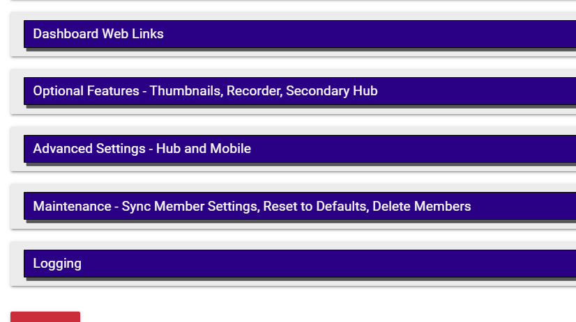

One thing I noticed that can be a little confusing in terms of "keeping your place" in the app when reviewing or changing settings in the sections that expand/collapse.
Example below:
Lets say I select Advanced Settings - Hub and Mobile, and then select Hub App Settings:
When I'm done on the Hub and App Settings page I hit Next:
I return to the main page w/all sections collapsed:
I feel like I lose my place a little when this happens, i.e., "What section was I reviewing/modifying?" It would help me keep my place if the section I'm in stays expanded until I close it again:
Just my two cents, take into account advancing age and infirmaties... ![]()
