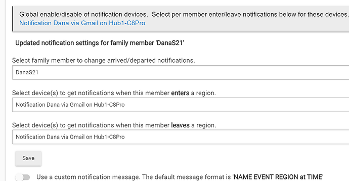

Just to confirm, the notifications is a 2-step process:
  • Global enable/disable
    • You use this to enable/disable for the device(s) listed here.
    • This allows you to temporarily disable notifications without changing the per member ones.
  • Select family member to change arrived/departed notifications.
    • Person you want notifications when they enter/leave a region.
  • Select device(s) to get notifications when this member enters a region.
    • Device to get a notification on enter
  • Select device(s) to get notifications when this member leaves a region.
    • Device to get a notification on leave
So for this example below, my wife and I have devices that are enabled to receive notifications, but only her phone would get them when I enter or leave a region:
Open to suggestions if that wasn't what you were doing, and the process is awkward, poorly worded, etc. :slight_smile:

Thanks for the details...I did have things set up that way, and was getting regular notifications consistently until several days ago. I need to get the exact date...might have been tied to an update. Other notifications are coming through related to presence changes, using the same notification method, so it doesn't appear to be a general issue w/notifications.
Here's what things look like in HE app, I did follow the full setup process...just recently I went back into the app and reconfigured it w/the same notification settings it already had, just in case:
