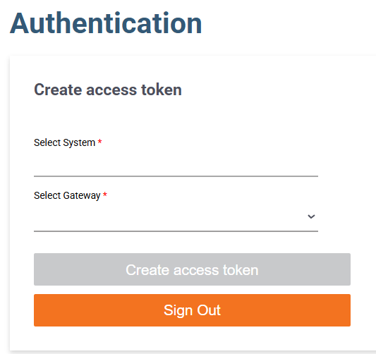

New to Hubitat and attempting to integrate my Enphase Envoy system. This type of work and thread is what really got me interested and excited in Hubitat. If it matters, I'm located in the US, and am having issues getting a token. I've followed along the driver and identified the website to retrieve the token was incorrect based on some general google searches and should be "Enphase Authentication | Home" so I updated the driver accordingly. However the next issue I'm running into is that within a browser, after logging in I get the following screen.
Based on the Device Info inputs it doesn't seem like it is made for this type of token request. Can you confirm? I have to start typing my system name and then it will appear along with the gateway to select. I've been able to manually get a token. Here is some other info that may be useful.
Firmware: D8.3.5167
SKY: ENV2-IQ-AM1-240
