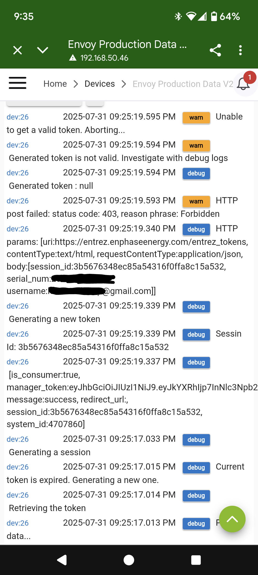

That website does work and I am able to log in just fine. My logging shows an error when attempting to get a token. Here is a recent log. Thanks for the support!
Me too, I got an error when request token with enterez url
I was seeing the same "403 Forbidden" problem from generateToken(). After much debugging (and amazingly, lots of help from Perplexity!), I found that changing the http parameter set-up to this got me a token:

I confirmed that the resulting token was good by using it in a "curl" request to the Envoy gateway. However, now the driver code is failing to validate, complaining about a request timeout to the Envoy. I'm continuing to debug...
I think my timeout is an internal routing problem (Hubitat and Envoy are not on the same network), which will take me time to fix. Meanwhile, I'd love to know if adding the Accept header spec fixes the problem for other people.
Thanks, the header parameter fix the problem
