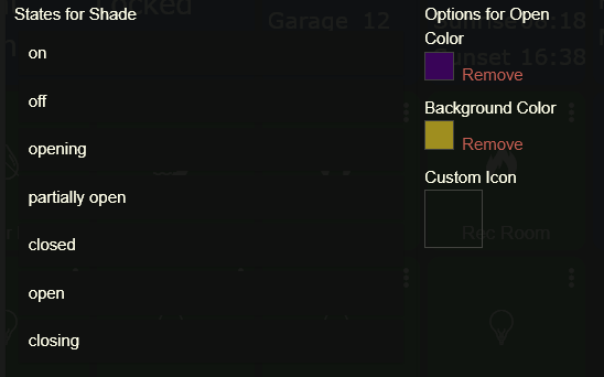

The only strange thing that eludes me is the open and close just don't follow the shade template in the Dashboard.
It's like the tile isn't getting the states but it does work and show position.
Oh well. My OCD is feeling better. :slight_smile:

Should I ask the community about the Dashboard compliance?
It may not be anything to do with your driver per se.
I have not experimented changing the dashboard background colors...
The MAB child device driver declares
capability 'WindowShade'
The same capability is used in the community 'ZemiSmart Zigbee Blind' driver that I am supporting too, and I don't remember a problem with the HE legacy dashboards.
Can you create a virtual device, assigned some of the inbuilt 'virtual blind' or 'virtual shade' drivers and compare whether changing the background works?
A virtual shade works, the colours change appropriately.
There is no virtual Blind driver but calling the tile a Blind in the Dashboard works as well.
Can you post side-by-side screenshots of the Current States section of a device using virtual shade and a screenshot of this driver shade device?
This driver is probably missing an attribute present in the virtual driver.

The open/close still works properly with my reported changes but the Dashboard tile still doesn't change colours according to the template; still just grey.
Oh well, not a big deal. I'm happy they track the same as the iBlinds now.

Can you manually update only the 'Matter Generic Component Window Shade' driver?
https://raw.githubusercontent.com/kkossev/Hubitat---Matter-Advanced-Bridge/main/Components/Matter_Generic_Component_Window_Shade.groovy
I have added 'Switch' and 'SwitchLevel' capabilities in the driver, I think that this is the difference with the virtual shade device.
You may need to manually edit the OPEN/CLOSE definitions in the code to match your last working settings.
Under test, tks.
Well the colours work now but in reverse.
I tried changing 0 and 100 in the code and various Prefs settings.
The closest I could get was Closed and Open with the correct colours and icons with
Substitute Open/Close w/ setPosition set to enable and your code unmodified with respect to 0 and 100 reversal.
It's all good visually now but I expected reversing the 0 and 100 in the code so make it perfect but it didn't help this time.
Living room is iBlinds normal, Kitchen Left is test subject. and KItchen Right is your driver unmodified.
Thanks for playing with the issue though. At least I can get the "at a glance" value now with the colour change. The slider being backwards is not a big issue.
