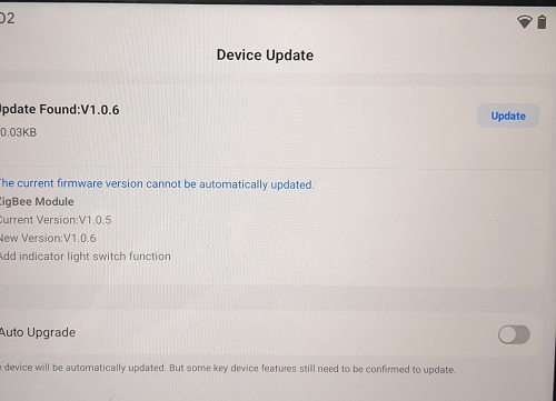

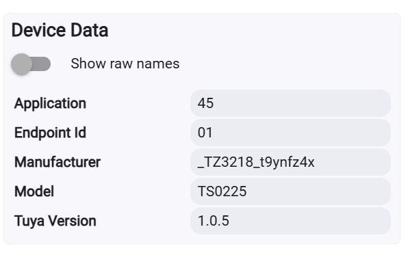

Will the Tuya Matter Hub perform an update on the Moe's TZ3218_t9ynfz4x sensor from firmware 1.0.5 to firmware 1.0.6?
Is there even a 1.0.6 firmware version available for the Moe's sensor?
Yes, you should be able to update the Moes mmWave sensor to version 1.0.6 using a Tuya hub.

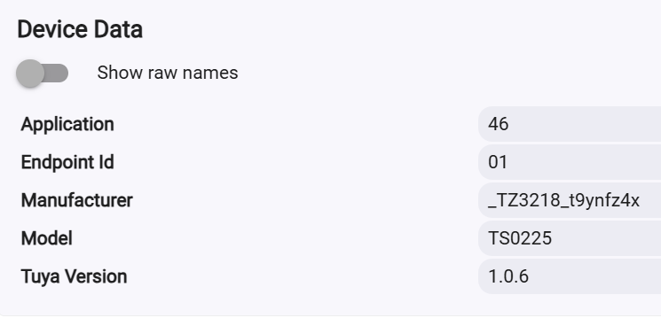

Works great. :smiley:
Reset sensor (Push and hold the switch/LED bar), pair to Tuya hub.
Upgrade to 1.0.6.
Reset sensor, pair to HE, turn off LED.

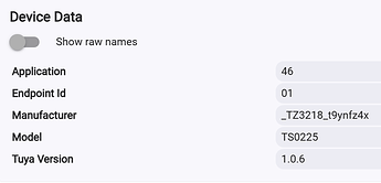

To get the Device Data fields to update I got impatient and just removed the sensor from my hub and then re-added it. :person_shrugging:
1.0.6
1.06

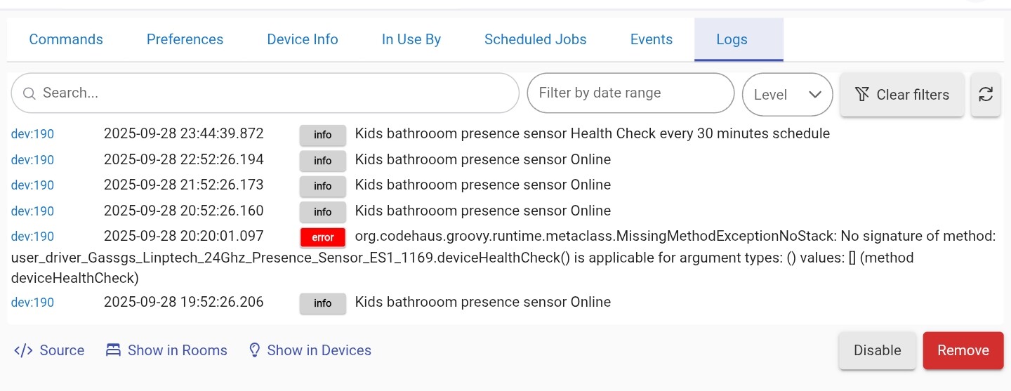

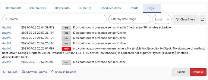

I'm getting the following error from time to time ad when that happens, i need to manualy resrt the device by disconnecting and reconnecting to power.
Any idea why?
Running 1.06 and 2.0 versions.
I don't know WHY. I just restart my Linptech presence sensor every day whether it needs it or not.
FWIW, I've found weekly rebooting is sufficient, zero issues.
:slightly_smiling_face:
Which driver are you using?? did you switch drivers recently? You may need to change the driver to "device" and remove all scheduled jobs...I think that "deviceHealthCheck" might be left over from a different driver.
