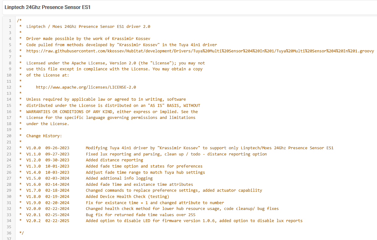

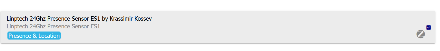

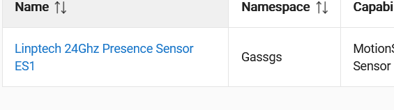

So this is confusing (as usual about Hubitat for me). I thought I installed Kkossev driver, Package manager reports this:
But when I go to hub's Drivers code, it sais name spaces Gassgs:
Yeah, that's gassgs's fork. Which works fine for many users, but I don't recall if it displays the firmware version.
I use Krassimir's mmW driver since it enables the setMotion-Inactive command (which I find useful for troubleshooting).
The confusion continues. The driver link in the very first post of this thread, creatted by KKOSSEV is the same as the driver I have installed, that you say it is Gassgs fork.

Sounds like a question not about the Hubitat Community (the forum) but for the specific author who forked the driver without actually changing any of the code. If they have a topic (thread) created for the release, you could ask there.
That being said, if you're still wondering about the firmware version thing, that data is normally provided by the platform for Zigbee devices, nothing in control of the driver -- so that's unlikely to change anything. A configure or re-pair (don't remove, just reset the device and re-pair; this is also one way it will definitely have your selected driver on pairing) might make it try this again. Otherwise, what platform version are you on (Settings > Hub Details)? I can't remember if this is a piece that was accidentally removed on early 2.4.0 versions.
(EDIT: "Tuya Version" would not be one of these fields; that would be the driver. I meant things like "Firmware MT.")
The intentions were good here - Krassimir was just trying to do Ggasgs a solid by helping promote his fork of Krassimir's (original) driver.
If think the 1st post spells it all out pretty clearly - both versions are linked there. Gassgs created his fork based on the outsized popularity of this particular mmW sensor - it was simply intended to be a slimmed-down version of Krassimir's driver (which covers many more mmW sensors than just this model).

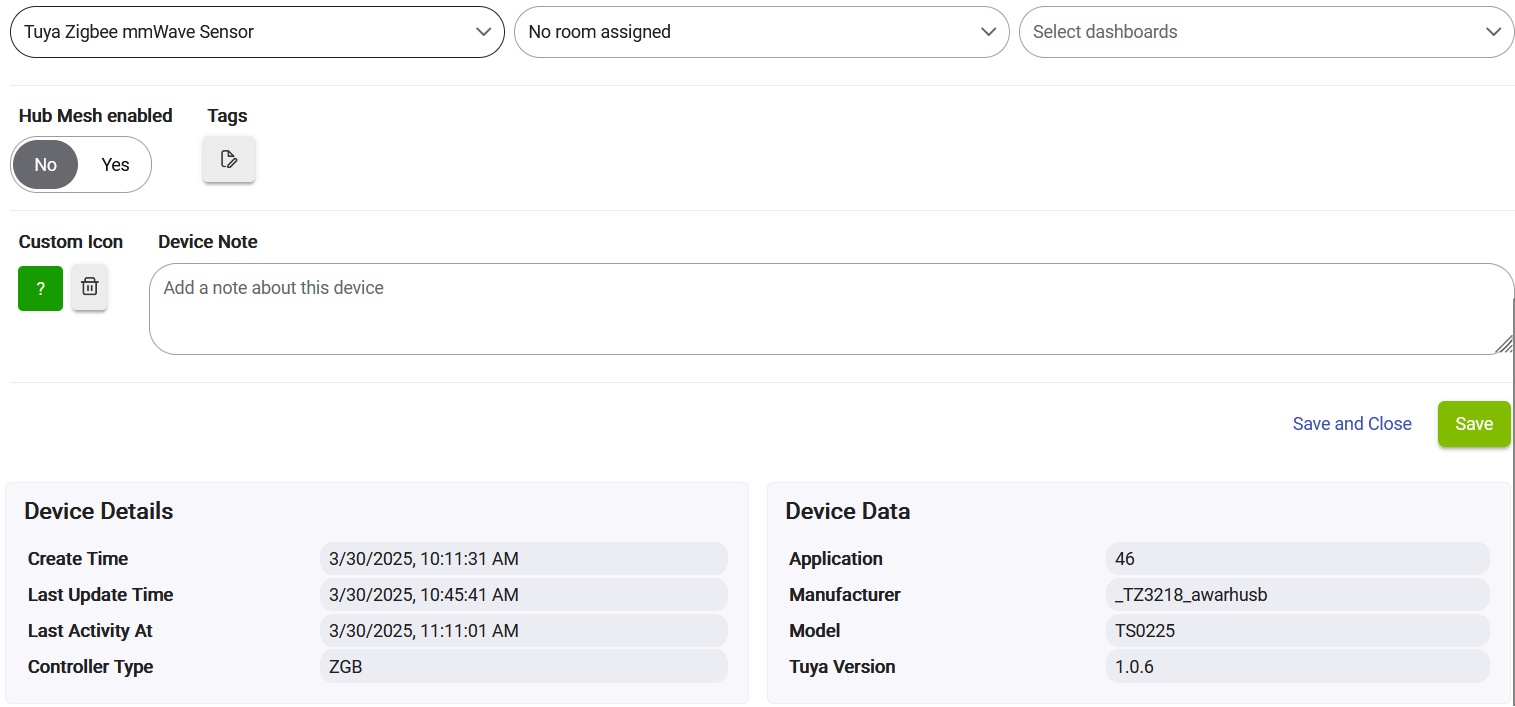

I can confirm sensor purchased from Amazon direct from seller "linptech" end of March 2025 came with firmware v1.0.6, as reported by kkossev's "Tuya Zigbee mmWave Sensor" v3.4.1.

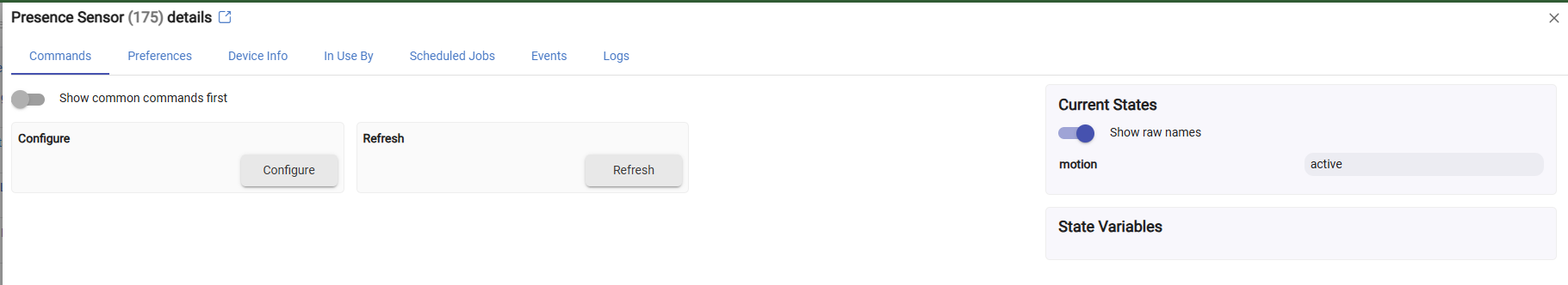

I do appreciate all the help!! But I keep coming up with more questions as to why its not working for me then lol.

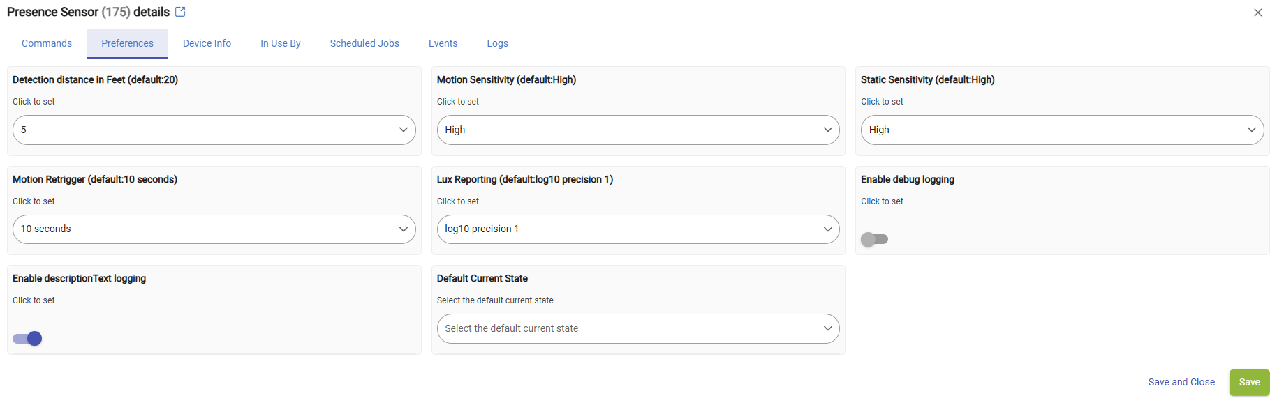

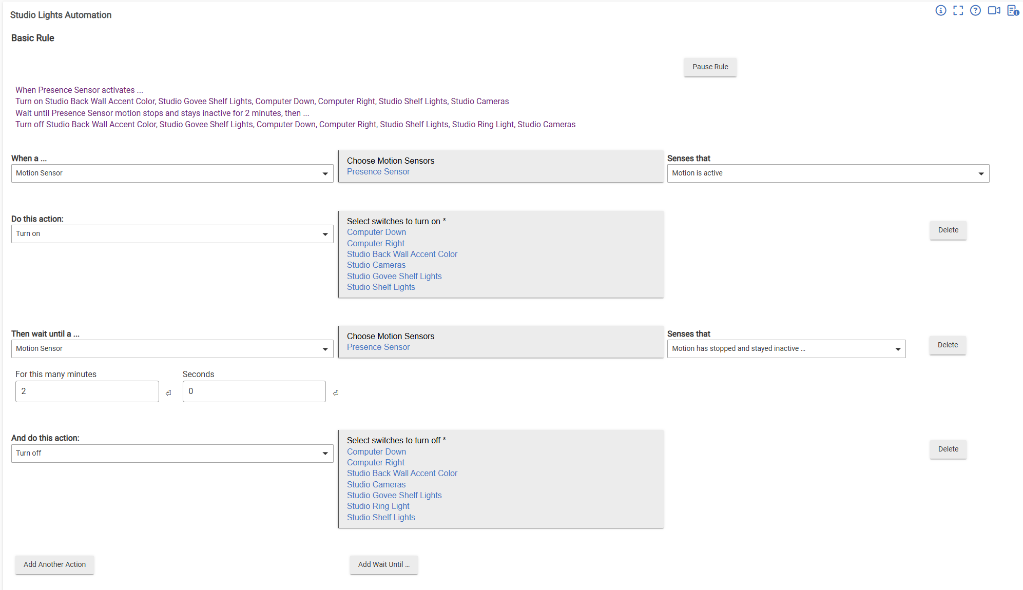

Below are my settings an someone please tell me if I've done something wrong. Because my automation will still turn off my lights because of lack of "motion". TYiA you are all amazing and this is why this community is so great!!
I don't use the built-in Linptech driver, but is your set detection distance (5 ft) enough - how far away are you typically from the sensor?
Which driver do you use? Yes I have above me about 4 feet away, but I was just messing with that and I upped it to 10 feet and it seems to be going inactive less, but it still does, its not even sensing my typing or mouse movements.
I usually have the opposite problem, where if I use high for both settings my lights never turn off. These have to be tweaked in for position and sensitivity.

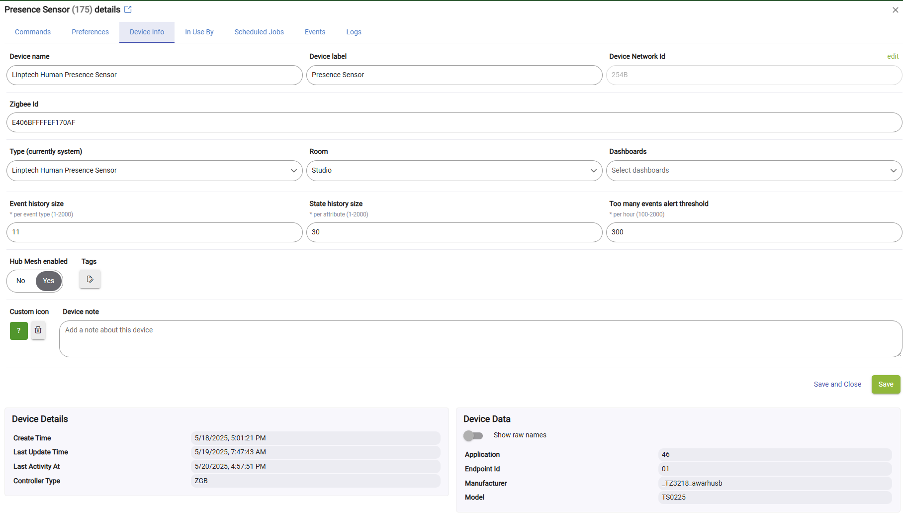

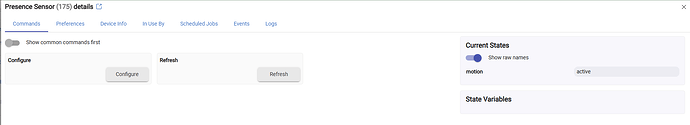

Still, your current states are incomplete, you should have more than just motion, even with the built-in driver. The device may not be paired correctly.
You realize you are in a community driver release thread, but you are using and asking about the built-in driver? You really should use HPM to install the community 24GHz driver posted here, or scroll to the top and get the driver code and paste it in.
Change to that driver in device info, and press configure, and then you will actually be talking about the driver this thread is about if you have any issues. You may want to reset the device and pair it again before changing to the new driver, just in case.
AHHH!!!!! The new driver seems to be working so much better!! Thank you so much for the guidance!!!!
