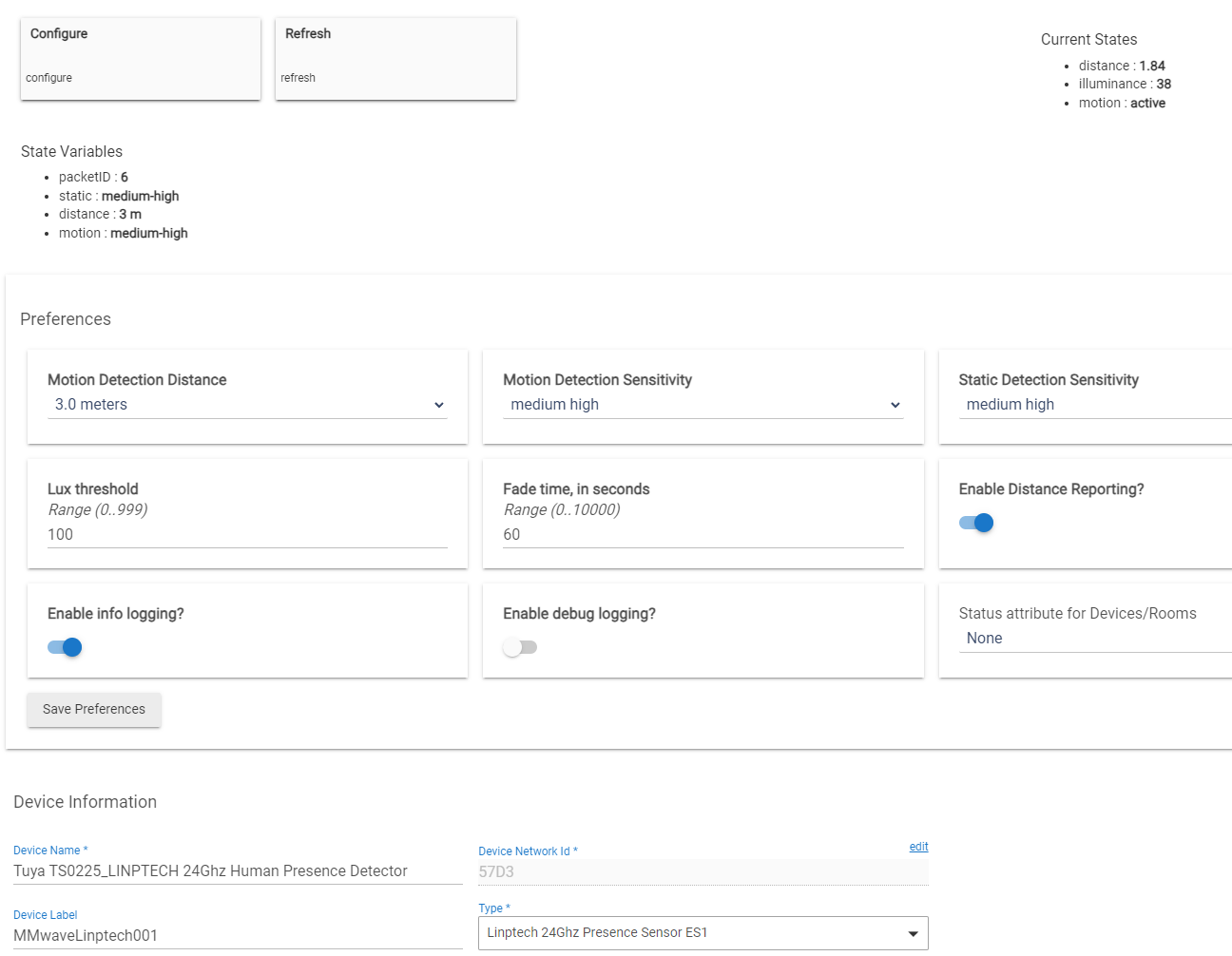

Tested twice this AM. I set up the sensor facing away from me w/three pie tins behind it, and set up a mirror at an angle so I could see the front of the sensor from behind it. Confirmed I could not trigger motion from behind it by moving, waving, etc. Set Fade time to 60s and triggered motion by waving my hand in front of the sensor. After initial sensor flash indicating motion sensed (and related active status updates on Device page/dashboard) the sensor continued to flash every ~4 to 5s until the 60s Fade time ended, w/out any additional motion.
Turned it around to face me, and triggered it and sat very still, and same ~4 to 5s flash interval. However, in this case it did not time out at the Fade setting and just kept flashing, as it correctly sensed my continued presence.
So it appears the continuous flashing you referred to is happening, at least w/the stripped down driver in my testing. My previous belief that the sensor was flashing when it sensed motion doesn't match up, given the very consistent flash intervals and complete lack of motion during my testing. The repeated flashing does appear to be coming from new motion events if you are facing the sensor and moving about, which is my very good excuse for thinking that.

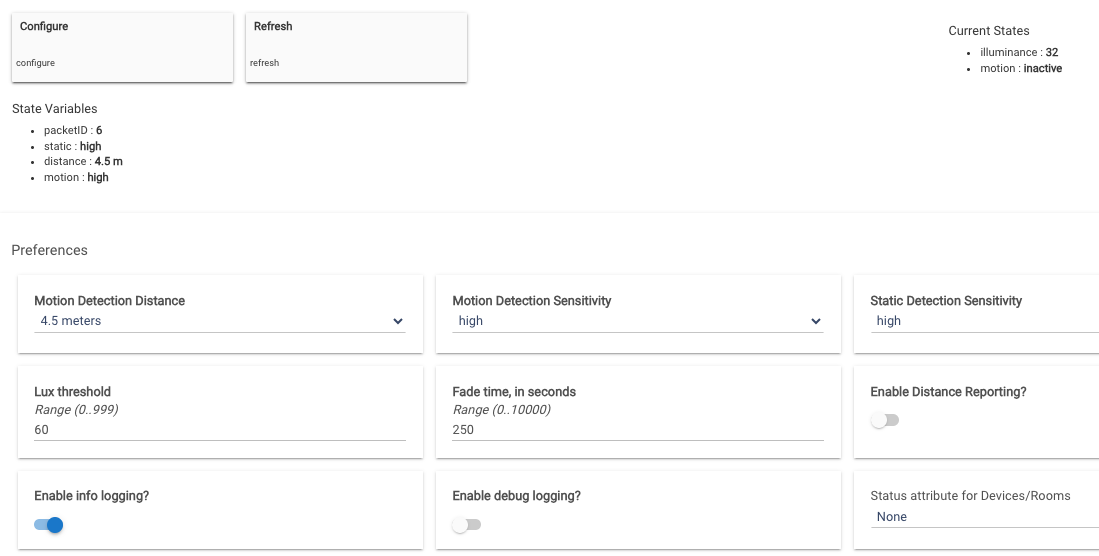

Whats your fade time set at?
