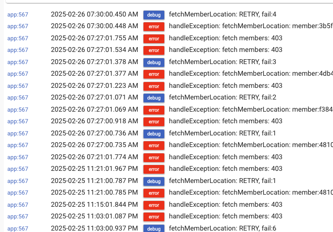

Yes it looks like mine has been pretty spotty for the past few days, and today has been only 404's. I tried refreshing my token and that did help.
However, it looks like this may be a code level change. It looks like that they may - MAY - have finally cut out the V3 API and are only accepting V4 requests. I made that manual change in the code in the hubitat UI and it's connecting sometimes, which is more than "never" which is what it was doing all day.
So it's hard to tell if it really is an API change, or just cooincidence.
Just started getting the 404 errors as well. I didn't receive any until about 10 min ago.
I think they are just having major problems. I put the app back on the "older" v3 API endpoint and it's still acting the same. sporadic 404's and connects.
That said, I did also just refresh my token a short bit ago for testing, so... ¯\_(ツ)_/¯
It's happening a little more than sporadically for me..
That's about how mine looks. A small flood early early this morning, but pretty clean since. That would show that all the recent fixes are doing their things - random delays, retries, and continuing to run, rather than falling over dead at the first boom.

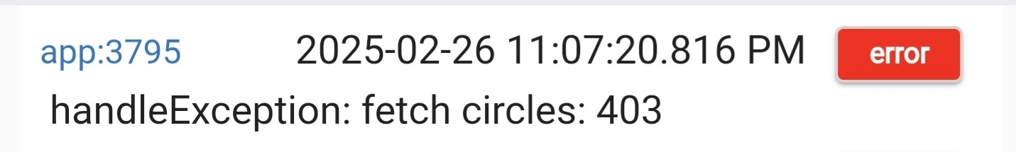

Bad news, the app has stopped reporting location details and is no longer working for me and getting a lot of 403 errors.

Can confirm, same here.
Getting these in the debug log as well as the 403 err in the app:
java.lang.NoClassDefFoundError: java/net/http/HttpTimeoutException on line 359 (method appButtonHandler)
I have a flood of errors yesterday evening which ends by 11:00pm eastern and has been quiet since. They where probably having service issues (again... :roll_eyes: ). If you're still having problems, refreshing your login token would be the next thing to try.
You might just need to refresh your login token. It's working fine for me after apparent service issues on their end last eve.
I've reset the token a couple of times. No change.
I've also removed the app and recreated it. The app won't fetch the circles and I get the same error as discussed above.
