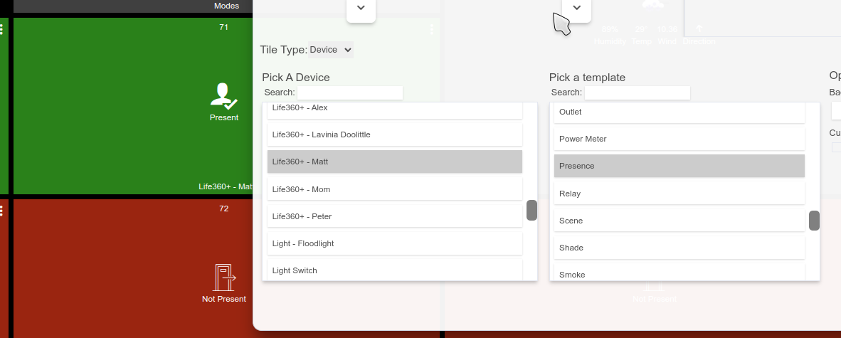

Check your dashboards though. You should be using the "presence" attribute.

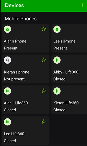

@allgrey
I took a few minutes and hit it with a hammer. Yes it appears to be that easy. Note my Life360 members are little houses now and not switches any longer.

Many thanks Matt, I first commented out and then just removed both the 'switch' and 'contact' attributes in the driver code. I'm not sure if that's what you meant by 'hit it with a hammer'. I'm still showing 'Closed' in the Android mobile app. Let me know if I need to modify some other aspect of the driver code.
Where are you still seeing this? You may have to make a manual change - and that's the point I'm trying to make. While it may be wrong, to just make it all disappear in another release could/would break people's installs and require manual intervention to fix. Still, fixing it is probably better and leaving it broke which leaves people confused.
Secondly, just commenting out those lines isn't going to change anything. You would need to disable and re-enable the app to "restart" it so all that is reread.
Well, I disabled and restarted the app.. no change. But it's just an UI issue so not a big deal. Still shows as Closed (or sometimes Opened for no apparent reason) in the Android HE app. But the functionality of the Life360+ app as a presence sensor works great and that's my primary use.
I'm not clear on what you mean by making a manual change... but, like I said, it's working as a presence sensor so how it displays is not a big deal.
