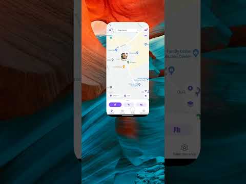

I've been meaning to capture a video of the Life360+ driver and the dashboard app HD+ working together and wanted to use it yesterday instead of that crappy .gif.
I captured a video of my daughter coming home from XC practice -- I switch between HD+ and the Life360 app to show the differences. Like I said earlier the Life360 app always going to be better, but this isn't terrible either.
FWIW - one of the main reasons I've done all of this is because the Life360 app requires constant location permission which is a little annoying. Even if I disable location sharing in Life360 it still won't work without the 'background' location permissions. I'm interested in using the service for tracking my kids -- not having Life360 track me.. anyway, that's why I've tried to create a similar experience and why it's important to get device updates on a regular basis.
